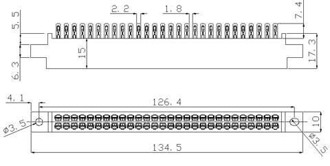

          Yes edge connectors and IC sockets and header pins
          will try and take some pictures
          You need good PCB for the heavy current parts of the cct ie; fet and coil
          You use the vero board as the "mother board"
          you solder female sockets on mother board
          you make small daughter boards with header pins from vero board
          and plug in the daughter boards

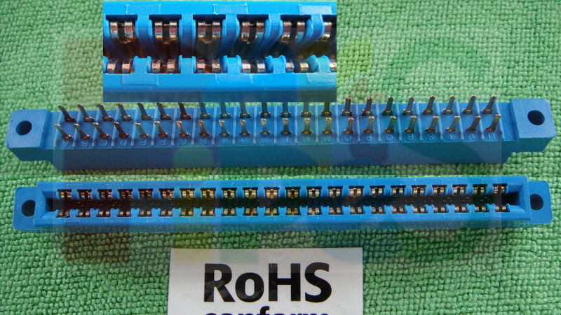

            Great idea,,,,Edge connectors. Nice elegant and cheap solution and easy for all to get. many lengths $2 on ebay , free ship.

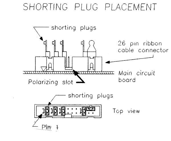

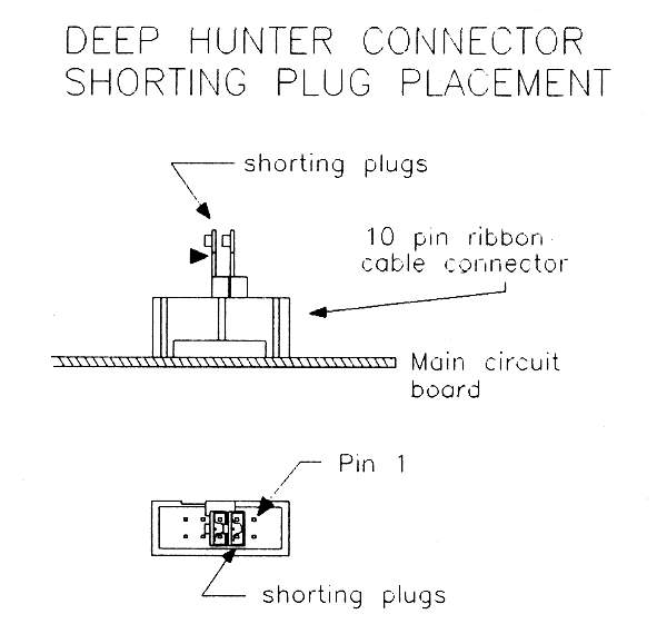

              This housing concept can also be used for the 1-100 khz range . Swap out the modules quick and easy . Picture 1 and 2 were example's from discovery Gold Trax ?
