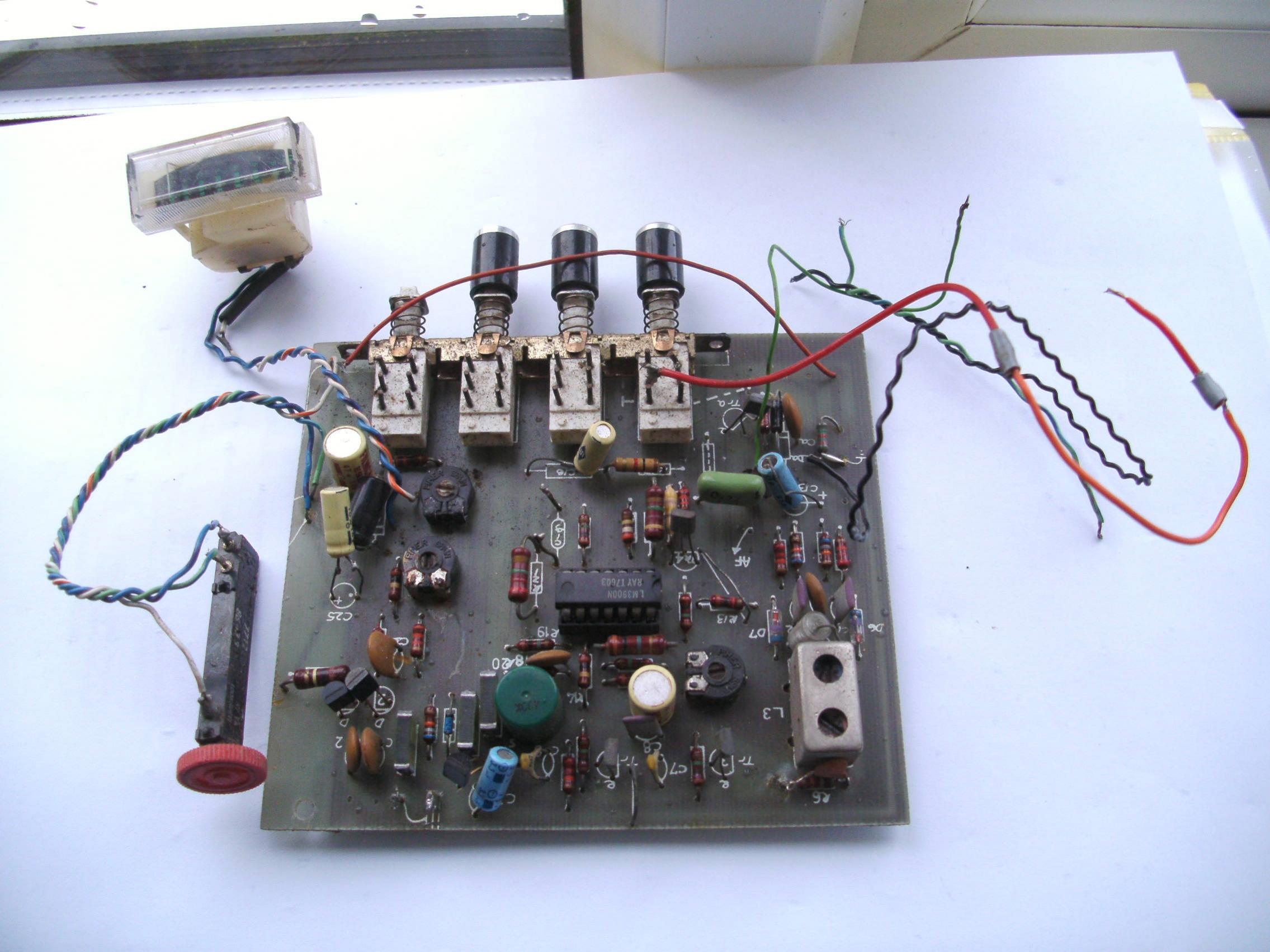

    Hi Can anyone me help find some information on a bfo self build components only kit, that I bought in the UK mid 1970s, as I have lost all the paper work and information.
    The reason I am asking is it's a bit disconnected and would like to get It going again,please let me know if you need any other info.

    Phew!!! Not a lot to go on,.... any name/info on the circuit board????? Any chance of a photo of the board/components??? How many knobs/dials? and any labeling/marking on them??

      The kit came with circuit board and components, including a 4 way push button switch, and a little meter, and instruction pamphlet.
      There is an I c chip in the circuit,and some writing on the circuit board I will forward all this Info

          On the circuit board is written ( The Bionic Ferret ) also the word ( Ambit ) the IC is ( LM 3900 M ) ( ZTX 107 ) (4 ) ( MBF 256 B ) ( 1 ) ( MVAM 115 ) ( 2 ) There is also a small meter with needle, and a 100k long plastic pot.
          I have taken the circuit out of it's housing to take the picture.
          I hope all this helps Fred. Arthur

                    You may be able to repair it without a circuit diagram. By the look of it, it's in a terrible condition, there are water drops on pcb. Most likely the contacts on the switches are oxidated - you should replace the whole switch module. I would also replace the multiturn pot and the other three semiadjustable pots, clean the board very well with isopropyl alcohol on both sides, replace all the electrolytical capacitors, measure with an ohmmeter in circuit all the resistors (probably they are ok). Dry the board with a hair dryer after you clean it. Also check the coils and the inductors on PCB for continuity.

                        Just love that PCB photo. Look about 15mm to the right of the LM3900, see the wire link over the resistor. I guess the electrons don't care, but....
                          It also looks like it's been repaired (or maybe modded) in several places as well. There are caps and resistors which have had their leads cut and then been resoldered. Also, look at the transistors at the bottom left of the board. Both of them have a pinout that doesn't match the silkscreen.
