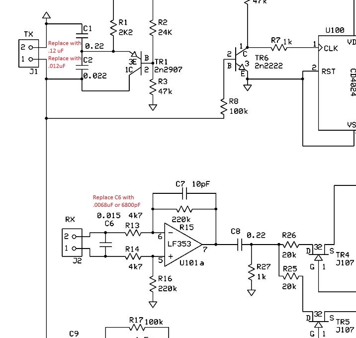

    Ok, I'm trying to bump up the operating frequency of the TGSL to double the 14.6 KHz as is.
    I have reduced the Transmit and Receive section Caps by as close to half as allowed using standard Cap values.
    I have moved the voltage pump drive from Pin 12 to Pin 11 of the 4024 trying to keep the frequency at the 7.2KHz as it was. Maybe I should leave it on 12 to accommodate the increased Current required by the higher frequencies?
    I have Rerouted one audio feed from Q4 to Q6 of the 4024 in order to bring the audio feed as it was running at 14.6KHz.
    Should I adjust the High pass filter following the Receive Op Amp?
    Any More things you think would need to be accommodated?

      The resonance frequency of a tank circuit is inverse proportional to square root of capacitance. That means to double resonance frequency, you should reduce capacitance 4 times.
      When you increase TX frequency, the phase difference between targets decreases. That means the increased TX frequency worsens target discrimination.
      When you increase TX frequency, the AIR&GND signal increases. That means reduced sensitivity of RX because you should decrease the gain of preamp to avoid its saturation.
      Can you point an advantage of increased TX frequency?
        "The resonance frequency of a tank circuit is inverse proportional to square root of capacitance. That means to double resonance frequency, you should reduce capacitance 4 times."
        Yes your right! Messed that one up! Thank You!
        But still with those values it brings it up to 19.67 KHz and that is good enough for me. The 29KHz was a bad Idea as it's in the U.S. Citizens Radio Band and would have been subject to RFI up the

        "When you increase TX frequency, the phase difference between targets decreases. That means the increased TX frequency worsens target discrimination."
        This is true but it also stimulates more Eddy Currents in Smaller objects and less Magnetic conductors such as Gold!
        "When you increase TX frequency, the AIR&GND signal increases. That means reduced sensitivity of RX because you should decrease the gain of preamp to avoid its saturation."
        Again Right on! But the ability of finding smaller gold Nuggets and bits has made up for the loss of depth.
        I may have to Use better filtering after the first Receive Amp and that is what I am asking.
        The Fisher Gold Bug operates at 70.01KHz and is one hell of a small gold machine.
        Using a two stage Receive amp may be required but introduces yet more noise.

        Original Caps in Transmit
        Caps As I changed.

                  I think a home-build detector operating at 20 - 30 KHz is a good idea, especially as there is a lack of commercial machines at these freqencies. It would make an interesting relic-hunter, too. Some of the smaller hammered silver coins we get in Europe have 'resonant' frequencies in the 15 - 25KHz area.
                  You might want to consider the use of smaller diameter search-coils, too. Skin effect will become more significant, too, so bifilar/trifilar winding of the coils should be considered.

                          You will also need to change the receive-coil load capacitance, keeping the same 'doubling of frequency' relationship. The ground balance RC time constants will need halving.
                            If you look at the schematic, I changed the front ends of both Receive and Transit on Coils.

                              Ah, now I see on the enlarged cct, I thought the red text was referring to the cap on the amplifier feedback resistor. The RC after the Rx pre-amp will need retuning in proportion to the frequency, too, I think. I would also think that changing the searchcoil parameters would be wise, though not essential. Ie. halving L, halving the parallel C, and choosing coil R so that Q remains the same. I'm not really familiar with the TGS, I'm sure the experts will have better detailed info for you.
