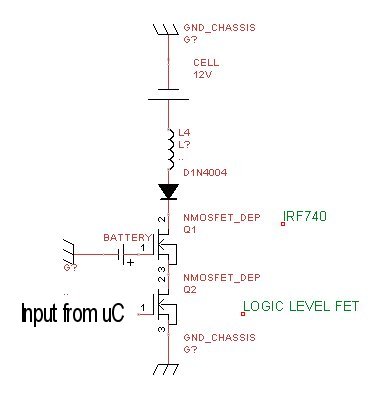

        would like to try this cascode cct
        if I can get some time.
        I wonder if this can be simed ?
        The logic level fet is only rated at 30v

          feed the gate on the top mosfet with a 4007 in series ,then protect the gate from exceeding 20v by using a diode from source to gate so the gate will safely "follow" the source voltage when it gets "blown open" by the h.v spike.

                            If you want to "cascode" something, do it different way. Instead of upper IRF 740 use high voltage bipolar. This is why: typically, IRF 740 is rated for 400pF output capacitance, by far largest in entire circuit, more than coil self capacitance, shield and cable combined. Some HV bipolars, say MJE/MJF18004 are rated for ca.50pF. Just increasing current consumption by 20%, assuming worst case current gain of 10, you will be able to reduce this capacitance 8 times! (spending 3 additional parts and less than 2$)
                            Also there is 1000+ V breakdown rating benefit.
