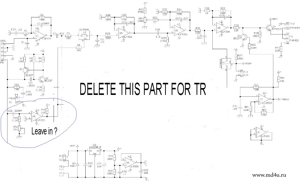

    IB's are not my favourite type of MD
    but just been looking at the schematic of the IDX Pro
    it appears that when you push the pinpoint button, it makes it a TR machine
    which pretty much eliminates the function of U2, U3 U4 and the VDI
    if we wanted to, couldn't we remove all those components
    to make a simple TR machine, or for tuning coils.
    please correct me if I am wrong
    thanks
    Yes, it's possible. Actually i did something similar for testing purposes some time ago, converting ckt. to 5V operation using MCP parts. Delete also 4016, use JFET instead of first one (like in Tesoro, R42 then goes to GND, not to +V), use quad opamp instead of 358 (324), you will end up whit only 3 ICs + regulator.
