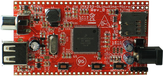

                            A few more options:
                            PIC32-PINGUINO-MICRO https://www.olimex.com/dev/pic32-pinguino-micro.html
                            iMX233-OLinuXino-Micro http://www.olimex.com/dev/imx233-olinuxino-micro.html
                            PIC32-PINGUINO-OTG https://www.olimex.com/dev/pic32-pinguino-otg.html
                            NXP's LPC USB ARM Cortex M0/M3 Microcontroller Breakout Board http://squonk42.github.com/USBug/
