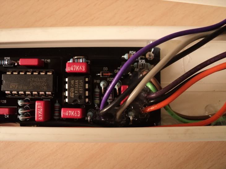

      Time to start making the case for all content
        Hi
        Made some progress

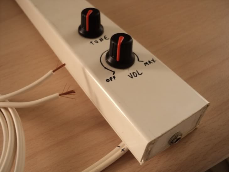

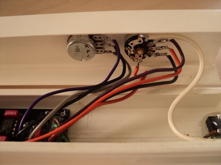

        Control box made ​​of rail to pass wires in it
        Volume knob, tune and headphones jack placed
        Power supply wire to connect to my backpack 4.2A 12V battery
        Positive lead of battery interrupted by volume knob

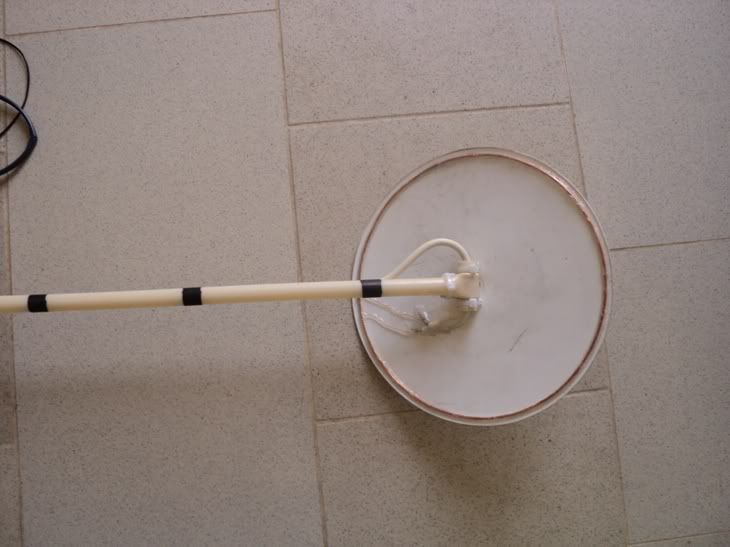

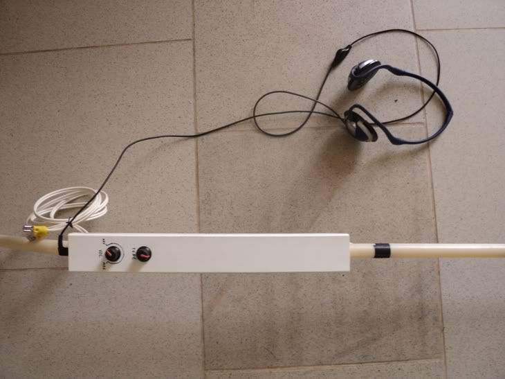

        Just need to make the detector rod,.... connect the coil with coaxial cable to the controlbox and isolate it with hot glue
          Final product
          I managed to make it lighter than the DEUS from XP only 495.3 grams
          In relation to the depth of detection, managed 27cm for a € 2 coin and around 30cm's for my wedding ring 21mm diameter and 4.2g
          I leave just a little video to spark the curiosity .... sorry for the poor quality but my camera is really worthless
          http://youtu.be/fzV1UdGoW5g

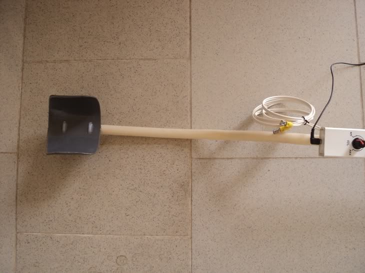

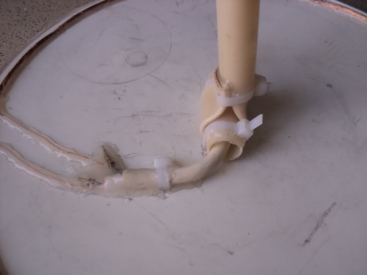

            Good job, how did you make the rod end its looks commercially made ?
            and is it just hot glued to the coil plate ?
              Just heated the detector rod tip and bend it around a little piece to make it ajustble
              It as got 2 zip tie to the coil plate and a god amount of hot glue to reinforcement
                Hi
                Thanks for the picture, I am always interested in how people connect the rod to the coil
                and the handle to the rod, to me this is the hard part of building a detector
                somebody always has new inventive ideas.

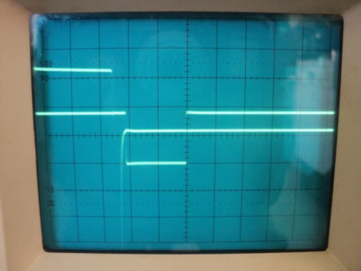

                  Hello friends, buy the kit and I put it together neatly and carefully, then check the welds.
                  I turned it on and had a high pitch, I followed the calibration steps: Connect the positive lead of the multimeter to pin 6 of NE5534P and the negative lead to ground and went to 0Volt.
                  Before following currencies tried moving but nothing happened, I returned to calibrate and climbed to 1.37 Volt and there if metal detecting ..
                  The second problem is that in 0Volt or 1.37 Volt not calibrate the trimmer as Delay, I said it with an oscilloscope, but would help to know what to do.
                  I also want to know which are the points TP1 and TP2.
                  I built 4 coils of different sizes and all they detected up to 2 inches is a roll of copper wire of 400 grams, and an inch is the most that I could detect my gold ring ...
                  6 days ago I keep testing and do not know how to follow.
                  Request help and suggestions to finish assembly.
                  Is there a technical manual?
                  Thank you very much!
                  Omar

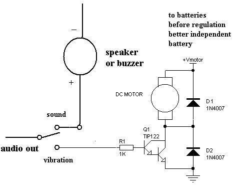

                          Hi again,
                          I'm looking to modify my PI.
                          Instead of having a speaker / buzzer when the metal detector finds metal, I would like a vibration device like cell phone vibrating micro motor.
                          I searched the forum, and I found this scheme .... but I'm having trouble applying it to the Surf PI
                          Can anyone explain it better...? I only have with me theTIP116 .....not the TIP122
                          [Attach] 25510 [/ attach]
                            I have measured the speaker output, and I only have got 0.1Vdc, when metal moves over the coil....
                            In the above shematic, the ground simbol goes to my negative battery terminal...???
                            The +Vmotor connected to the positive battery terminal...???
                            I have a 12V battery powering my Surf PI .... this probably will burn my vibrating device (cell phone vibromotor)
                            Any help apreciated

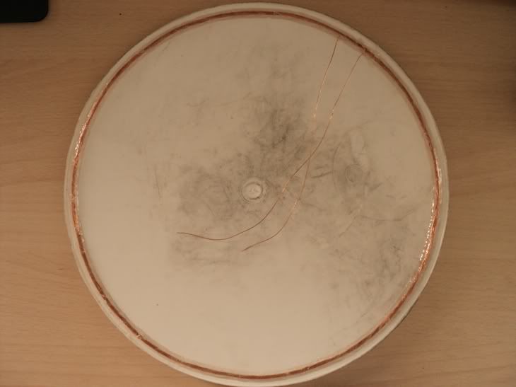

                              What coil were you using in your video ?
                              Thanks,
                                Nezocas
                                Thanks,
                                0.40mm wire 200mm diameter 21 turns, from degaussing coil from CRT TV
