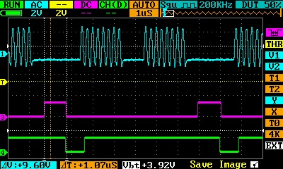

        here's a picture of the timing on my DSO quad,
        The red trace is the adc's conversion pin (SELPIN)
        The green trace is the data out of the adc.
        The blue trace is the 8 bite data (spi.transfer(0x00) so you can see their is a small gap between the the data bursts, that gap is about 1 us, so if i can remove it, I'd get a better sample time.
        I re-wrote the software to use the C32 compiler functions, the MPIDE digitalwrite's are a little slow,
        my current sample window is: 3.032 us
        That means if I were to set up a 13 us sample window, I'd be able to sample it 4 times, on every transmit pulse!
        This is called the "Direct Sampling System" copyrighted
        The SPI bus is running at 16 MHz
        Compare this timing diagram, with the ads8319 data sheet (figure 46) and it'll make a little more sense of the data sheet

            I can see the gap and am beginning to want to eat my words "i like the 2 transfers". Should have known something like this would have been the result of doing it that way.
            So if you can remove the 1uS gap does that mean the sample window would be about ~2 uS and you could sample 5 times rather than 4... that would be pretty good
              so thats the idea, it's something I've been thinking about, I'll have to use the pic 32 compiler "c" commands to do it. but I'm searching the web for ideas.
              here's something about the screen shot of my timing diagram, if you noticed i had my time base set to 1us, but at the time i took the screen shot the spi bus was running at 8 MHz, so that's why the sampling would seem to be longer than the 3.032us.
              when i can get the "gap" solved, I'll be closer to sampling, but it'll take alot more before I'm ready, i also need to figure out how to make a audio output software.
