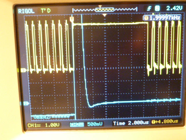

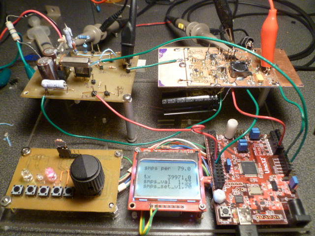

  • well here's a little progress on my Qed experiment
    i finally got the smps power supply to sync with the tx pulses, i think a have a bit more work to do on it but,
    so far so good. i did change the in and out on the IDF604, to make it a little more freindy with programming.
    I hooked the qed power supply board up to my other metal detector experiment board, i even connected my minelab coil up to it, just to get a feel of things to come.
    yup, the power supply turns off during sampling, or where ever i wish.........

    • power supply notes,
      very tough, through all of my testing didn't burn up any components, which is a new record for me, even while programming, their were many times I'd look at my power supply in current limited condition, parts were hot, but let them cool off, and back at it.
      I'm going to also build a switching power supply based on the LT1372 or LT1377, and give it a go.
      why?
      I think this chip can do a better job at controlling a power supply than me.
      features.......

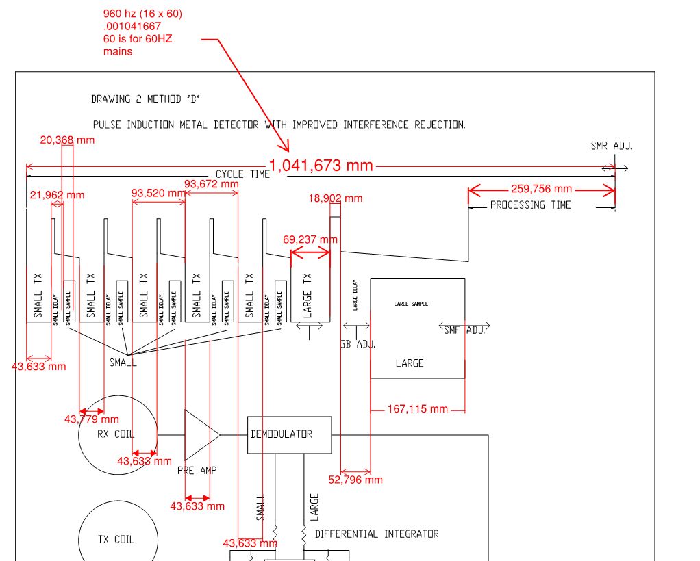

          • here's something about the QED power supply synchronization if been thinking about, it sez in bug's patent "cycle time is 4,8,16 times mains freq,
            so, I been playing with my timer spreadsheet, seems i can't do it with the way the chipkit is setup, here in north america our mains is 60 cycle, which didn't go into 80 megs very well,
            but it seems i might be able to change a muiltiplier in the clock osc, if it works, i'll run the chipkit at 72 mhz, which would get me to 960Hz cycle time, which is a good place to start experimenting with.
            here's his's patent, (already been posted on the internet)qed patend markup 1.pdf i was marking up, just trying to get some ballpark ideas on timining. i used my cad program, all it had was mm so i call it ms
            Philip
              here's his's patent, (already been posted on the internet)qed patend markup 1.pdf Click image for larger version
              i was marked it up, just trying to get some ballpark ideas on timining. i used my cad program, all it had was mm so i call it ms
              that's it for now, the cat just "chased me" out of the room
              Philip

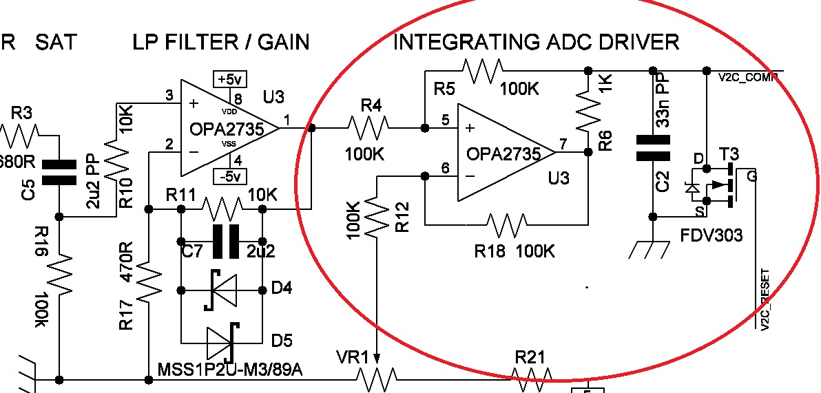

                  let's not use a A/D converter in the traditional sense,
                  when i read about the QED, from the schematics and patents,
                  here's what how i understand it,
                  through my experiments usuing my 16 bit adc, it worked ok, but still, i was only reading 1 target sample for 1 conversion.
                  problem is, the target sample is very very weak, so, what about usuing a 24 bit ADC ? same problem, 1 target sample for 1 conversion. and they still
                  have a "ENOB" similar to mine
                  http://en.wikipedia.org/wiki/Effective_number_of_bits
                  even when i used running averages, i tried up to a 100, it did help alot, and chudster software help even more, but running averages just dilute the signal peaks,
                  when it comes to usuing 24 bit adc's moodz is on top of it, alot more than me.
                  How about bugwhisker's QED idea?
                  let say we TX 5 times in a row, and we save the target sample in C2, so the target sample voltage gets added.
                  now we need to read the saved voltage, but how?
                  simple, at a certain point in time, we start a counter in the microprocessor, as the voltage drops, due to the discharge, the counter counts up, now, at a certain point, the comparator stops,
                  we read the counter, that number in the the timer may be better than a 32 bit adc.....................
                  then you could close T3, drain the cap, time to start over.
                  what happens next?
                  you could flip the switch U4, and subtract out the ground balance from the circuit,
                  does it work?
                  according to Minelab, it works very well,
                  anyways that how i see it, and i plan on trying it out as a experiment.

                      Wow, that completely cleared that up for me. I think that is pretty interesting, since a lot a microcontrollers use this principle as a simple way to provide an a/d without the a/d. I really hadn't even thought about that when applied to this application.
                      That gives me some further questions on the tx pulse and the snubber pulse. How do they work together?
                      I guess first off, I would turn on the switched mode power supply, until it charged up to say ~7V or so.
                      After it charged to that, I would turn it off.
                      Then, I would turn on the tx pulse for X time (say 43.633uSec) then turn it off, and then turn on the snubber for Y time? (say 7.125uSec).
                      Is the snubber used to dampen the tx? The BEMF pulse on the waveform looks to have a flat top. Is this from the snubber on time? With no snubber, I'm guessing it would be much higher if true.
                      Assuming that's how the snubber works, after a small delay of 21.962 uSec, U4 would only be turned on to switch side A during the sample period of 20.38 usec. This would ultimately charge C2 a certain amount. U4 is then turned off. At this point the mcu counter can be used to count down a number, call it sample 1. After the counter stops, T3 is enabled, resetting C2 back to 0.
                      After this the process repeats. After five loops (we now have 5 samples), a longer tx pulse is used (69.237 uSec) with U4 switched to B after the large delay of 52.796 uSec. U4 is turned on for 167.115 uSec (large sample time). After this we have samples 1-5 representing the signal, and sample 6 representing the GB?
                      If its another way, the first 5 samples are simply used to charge the same instance, with each adding to the previous. After a total of 5, they as a sum correlate to the large single GB one. Is it this way instead? From your post I'm assuming this one. How does the 5 cumulative charges work? C2 charges over time, so I get that part, being C2's charge gets bigger and bigger. What does this do, having 5 small charges, as opposed to one big charge? Does it ignore some side affect of a single long charge? Is that what the two differences between method A and B are? Or am I way off in left field.
                      Anyways, during the processing time I turn the switched mode power supply back on.
                      As a side note, would anyone be interested in a flow chart of this sequence? Its not code, but a flow chart is only one step away from converting to useful code..

                        • I guess first off, I would turn on the switched mode power supply, until it charged up to say ~7V or so.
                          Then, I would turn on the TX pulse for X time (say 43.633uSec) then turn it off, and then turn on the snubber for Y time? (say 7.125uSec)..
                          pretty much, although, if you notice on the QED, theirs a signal that feeds back to the micro, SNUB_MON, that may feed adc input, so, sometime after TX, you control the snubber, and read voltage and adjust accordingly, That peice of code i'll be doing trail and error looking at waveforms on the scope.
                          After this the process repeats. After five loops (we now have 5 samples), a longer TX pulse is used (69.237 uSec) with U4 switched to B after the large delay of 52.796 uSec. U4 is turned on for 167.115 uSec (large sample time). After this we have samples 1-5 representing the signal, and sample 6 representing the GB?
                          humm, I haven't looked into it that far, but i'm thinking your on the right track.
