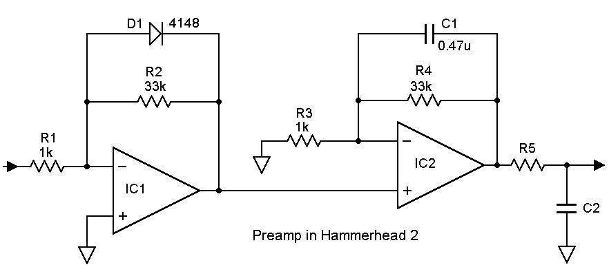

            200 years mankind has a powerful tool for analysis and design, which is called "Frequency domain". According to this tool, the Hammerhead is wideband metal detector.
            According to the frequency domain, the title of this thread should be:
            HOW TO DESIGN RX FOR WIDE BAND METAL DETECTOR.
            The designer of Hammerhead accidentally discovered a preamp, which frequency response is matched to frequency spectrum of TX and to frequency responses of most targets.This is made by the capacitor C1 which "wrong" value is shown below. However the value is not wrong.
            The amplification of this preamp is a frequency dependent function having cutoff frequency fc. The gain below fc is a constant depending on resistor values only. This LF region of amplifier is not important for our targets. The important frequency information for targets is above fc of preamp. The "wrong" value of C1 makes the system more effective. The efficiency of system TX-TGT-RX can help us to find answer of above question, but the question is not correct. The correct question in frequency domain is
                            More or less. Target frequency responses (taus) are very finite, so bandwidth is not THAT excessive. At Tx you do have a short pulse which spreads nicely over a wide frequency spectrum, but by virtue of synchronised SAH-style Rx samples, you observe quite narrow band phenomena. Just like modern digital oscilloscopes do.
                            The only component here that is exposed to the full wrath of wideband signal is a preamp, and IMHO it must be optimised for gain bandwidth product, and not so much for noise.
