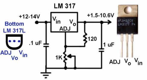

        If you only need 100ma maximum, you can use the smaller LM317L.

          Rather inefficient for 1.5 mA output, though - the LP2950 series will have a ground current of 100 microAmps ath these low output currents. Better still would be Torex XC6206 series, I've used these before, very impressive, full CMOS, they take less than 1 microAmp quiescent, but SMD package only.
