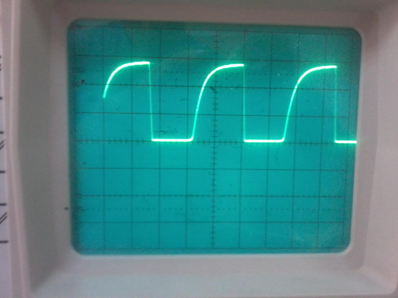

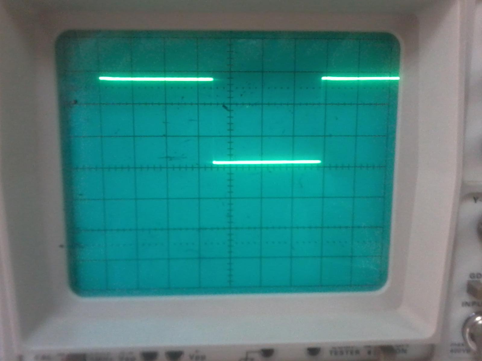

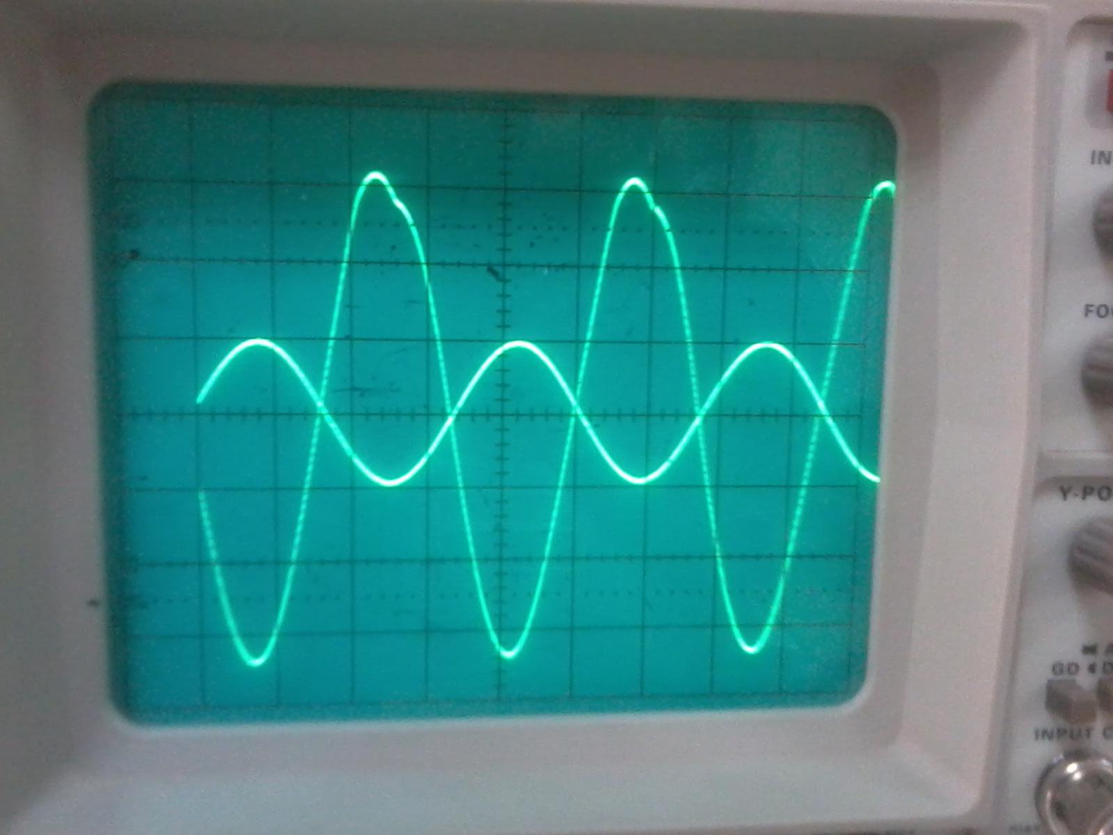

                                Hi guys
                                sorry for delay,i have been looking about an oscilloscope when i get one i have measured the frequency,but before this i forgot something that i have checked the pcb it's don't have any short and the resistors R9,R10 is 4.3K not 4.7k damn the seller,and with respect to the frequency this is the result:
                                1) pin1 4024 equal 14.7khz
                                2) pin12 4024 equal 7.14khz
                                3) TX and RX freq and the phase shift between them
