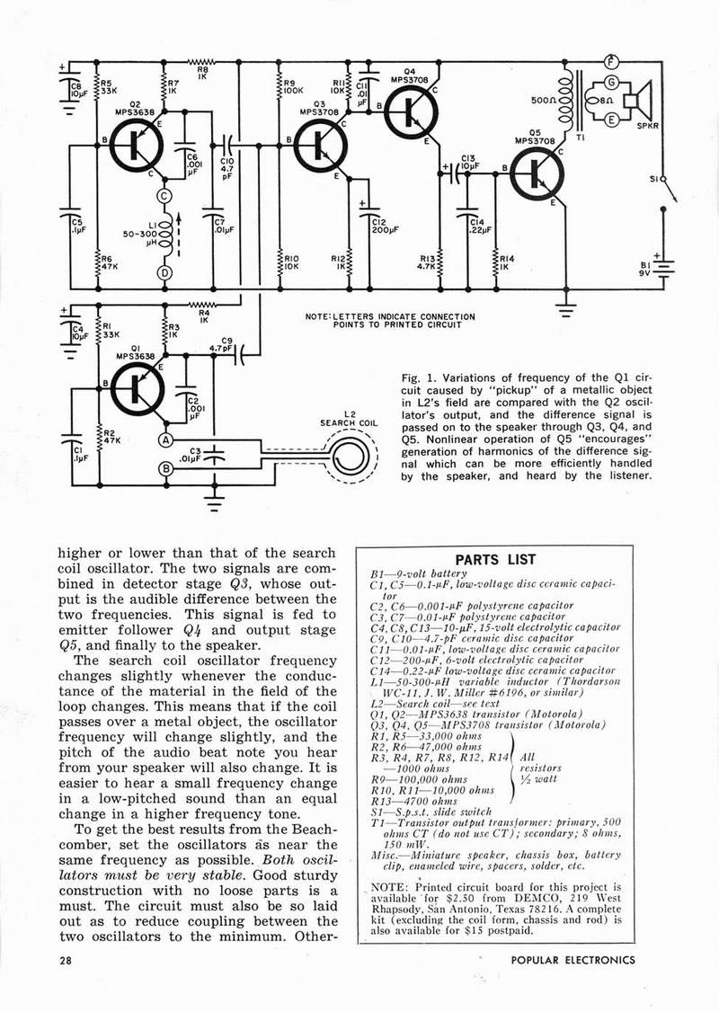

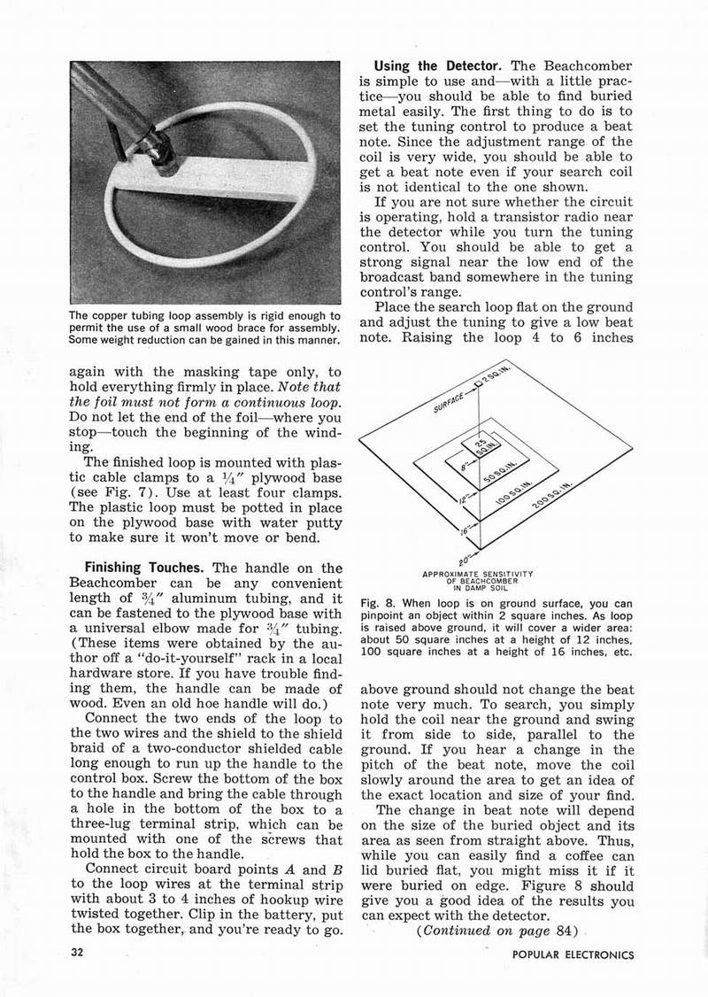

      "Good" + solid state = TOUGH at metal detector technology! Not impossible, but very tough.
      As you see above; i tried to extract only such projects from my 5.7GB database on hard disk.
      Just a few!? I couldn't believe my eyes!!??
      Your demand is very interesting to me! Indeed!

      Point is: you are absolutely right when it comes about old radios, but pitty; it is not the same as with metal detectors. Old solid state radios are same good or even maybe better than most of new cheap technology nowdays. But with metal detectors is quite oposite situation.

          Most transistor-only designs are going to be either BFO or ultra-simple TR. Ivconic has given you an excellent start.
          An interesting challenge would be to design a reasonably decent discriminating VLF using only transistors, no opamps at all.
