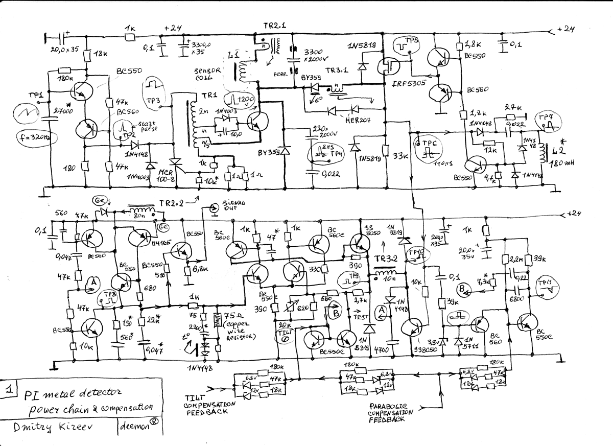

    2 years ago I decided to make my own PI metal detector . For the first time I made some experiments with well known PI technology , but one day a very beautiful idea came to me - I found a way how to store and recuperate the energy that we usually waste in the resistor connected in parallel to the sensor coil . I tried this idea and found that it really works . So we can either decrease power consumption of the device or radically increase the pulse energy with the same current from the battery . And after some research I made the prototype , it shows quite a little energy consumption and some other interesting features . Now I decided to publish the circuit of this device - maybe you find it interesting ... But how can I attach the pictures ?

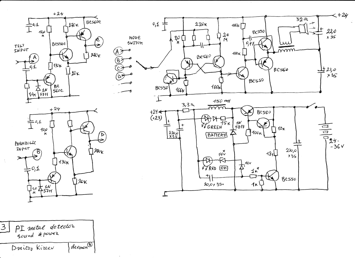

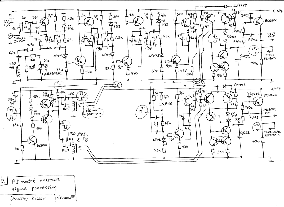

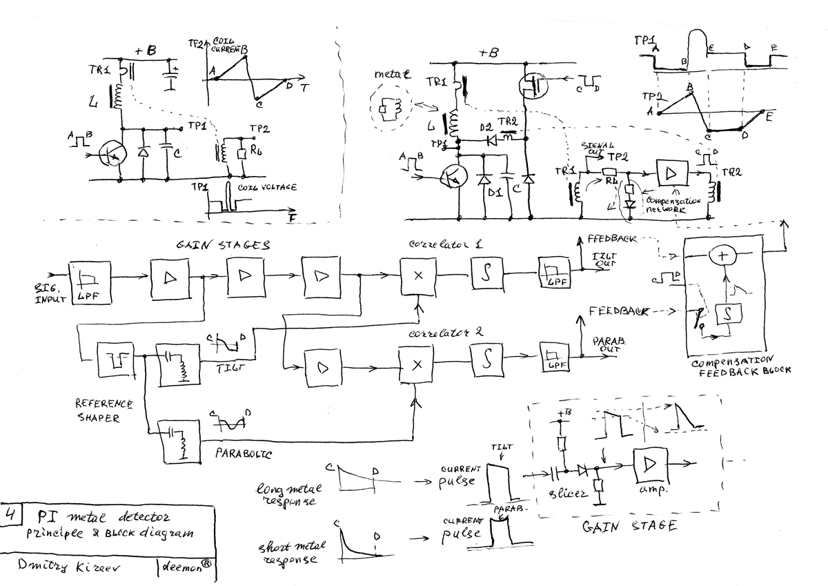

              So here is the circuit :

                  As you can see , the first idea was not to stop the coil current , but to reverse it , using the LC resonant circuit . The first step is to charge the coil ( phase A-B on the time diagram ) , then we have a flyback ( phase B-C ) and current reverse ( just like TV deflection works ) , and after this - the coil voltage drops to the ground and the coil current begins to recuperate . But the metal response begins just after the flyback , and at this moment we have a rapidly decreasing current in the coil , so it will be a great problem to select our signal .
                  So I deciced to use a trick - just after the flyback I open the mosfet switch , and let the current circulate in the shorter chain ( coil , mosfet , diode ) . Now I'm wait for about 100 uS - phase C-D on the right diagram ( and receive the metal response ) , and after it - shut down the mosfet switch , allowing the current to flow back to the power supply . In another words - we use the current , and then return it
                  In order to get the signal from the coil I use the current transformer TR2 ( on the power chain circuit ) . Its output current goes both to tilt compensation circuit and to processing board . Compensation must be used due to losses in the coil chain , so without the compensation we'll have a current decay that will be mixing with the received signal .

                      So , for example , if we have coil current 2 A , and coil wire resistance 0,2 Ohm - we'll have 0,6 V voltage drop , plus about 1,2 V forvard drop on the high-voltage diode ... so we need to apply 1,8 V into the coil chain in order to compensate the loss . And if we do that - the coil current ( without the metals near the coil ) will be constant during all the measuring interval . But the losses in the coil chain depends on temperature , so I use another trick - I let the current after my current transformer TR2 flow through 2 little diodes ( 1N4148 ) and one copper resistor .... the idea is that this network will behave itself when temperature is changing just like the main sensor coil chain does , and if I amplify this voltage and apply it to the coil chain in right polarity ( through the TR3 transformer ) - I will completely eliminate the temperature effect .

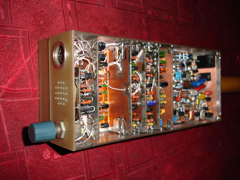

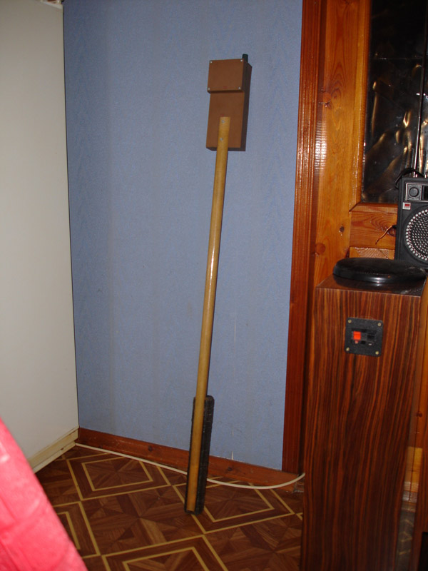

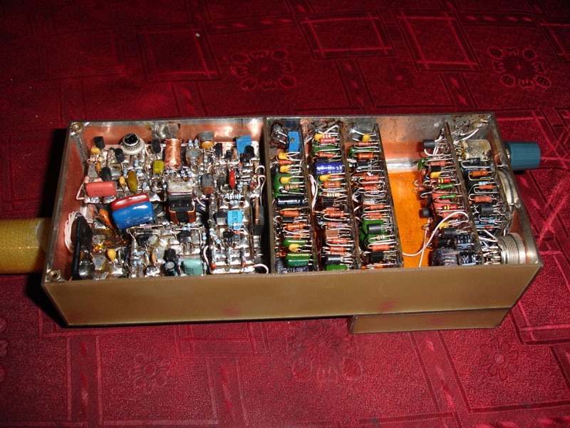

                        Of course , if I publish it - now I need to explain all the things Please excuse me for this complexity , but I really couldn't make it simpler ... and initial idea seemed so beautiful to me , that I decided to pass it through anyhow . And I did it - now it works . Here are the photos :
                          wow,
                          that's art work!!
                          nice job on the construction !!
