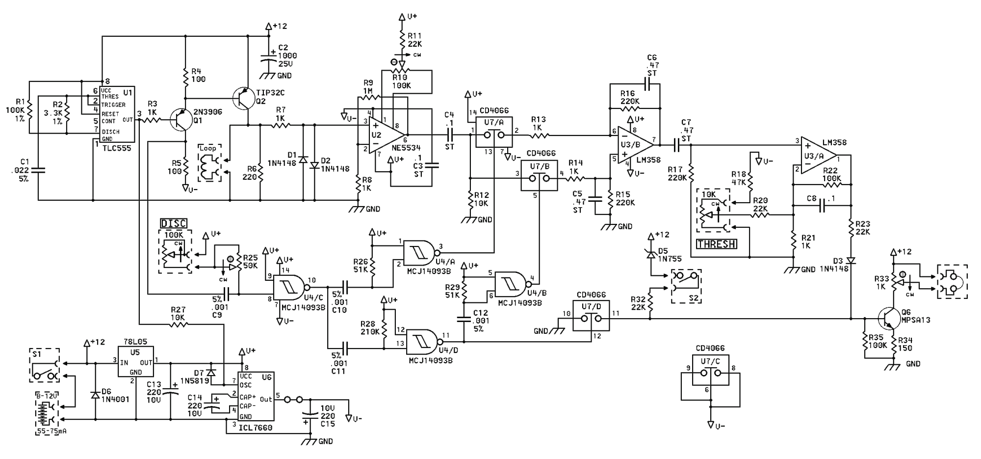

    The signal into pin 8 of the 14093 shows a pulse with a flyback, the decay of which is tuneable with the delay pot. However TP1 is showing -5V. Given the only -5V source around that part of the circuit is into pin 7 of the 14093, I'm deducing that chip is dead.

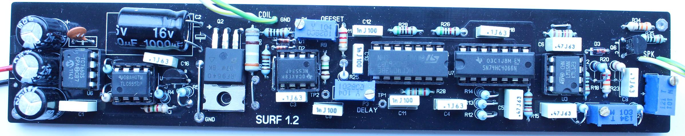

    Post a good photo of the build - maybe a silly on assembly? Are both wire links in! Are the electrolytics all the correct way.

      Thanks for getting in touch,I've attached the picture, pretty confident it's together ok.
      To be honest, the kit has been on the shelf for months, but I put it together at the last minute before heading off to the beach with the kids, if it wasn't a bank holiday I'd have just ordered spare parts up from RS.
      I've checked it with a scope, which is how I've got as far as U4C before questioning its output.
      Si

          Note the IC7660. View post #69 http://www.geotech1.com/forums/showt...t=17396&page=3
            There is no jumper on the right and left side of Q1, check that!
              Sorry, no jumpers next Q2.
                Finlay those jumpers are already on the pcb under the paint
                Here is a document if you need to understand how this model works, the pdf is related to the original Whites Surfmaster schematic
