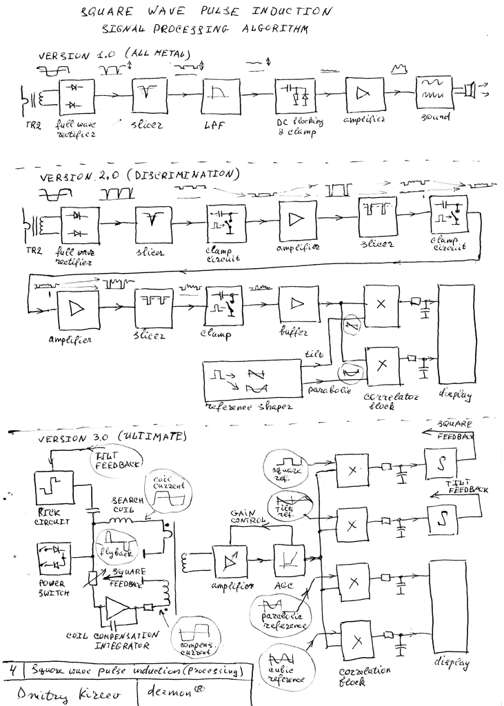

                Looks a little bit too complicated , yeah ? My solution that described here needs only a two parts , ha-ha .
                But the thing that I described in my "square wave" topic - http://www.geotech1.com/forums/showt...nduction/page2 ( see the block diagram in the post 29 , VERSION 3.0 ) - can do even more . It can automatically balance the mono coil in much wider range ( from 1 khz to 0.5 mhz approx. ) , being energy-efficient also due to its quasi-resonant transmitter circuit , and allows us to extract all the target information quite easily , providing it in a 4 output channels . And all this stuff is already working ... when I'll have a time - I will upload all schematics

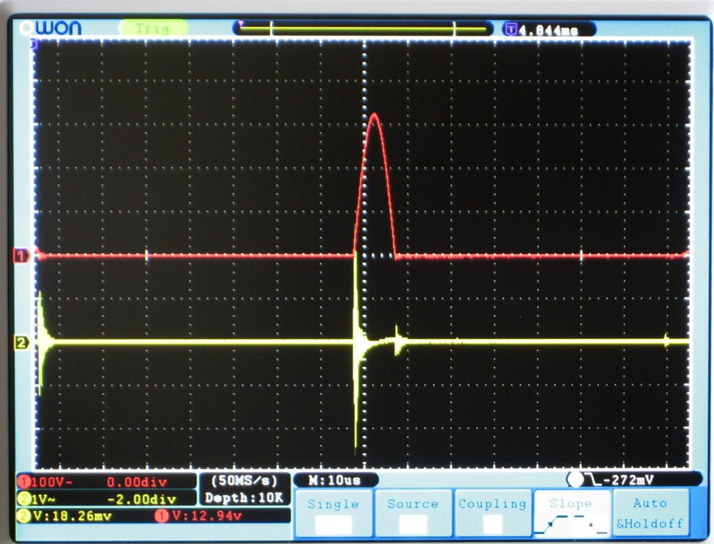

                            • #44
                              Flyback compensation
                              Attached is a Flyback compensation circuit and a scope shot showing:
                              Red trace, the Fyback at about 300V
                              Yellow trace, the input to the preamp, with the Flyback eliminated.

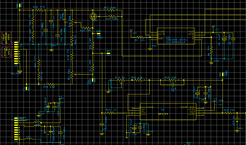

                              • #45
                                Hi Tinker, so your compensated on the RX side, although it's a bit hard to see the circuit easily with the black background.
                                I do remember previously had the compensation network on the TX side.
