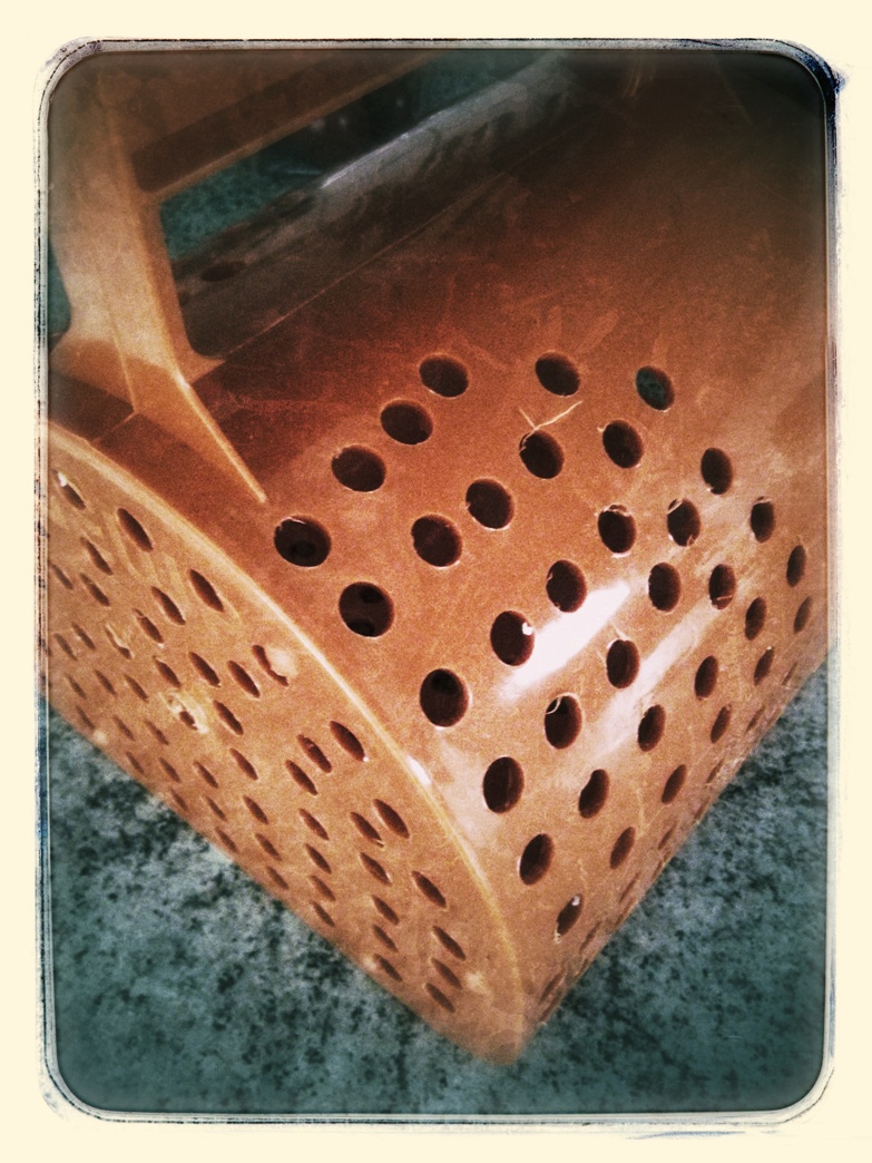

      Agree. I also use a horse feed scoop. Not the prettiest one, but for €2 it works fine.

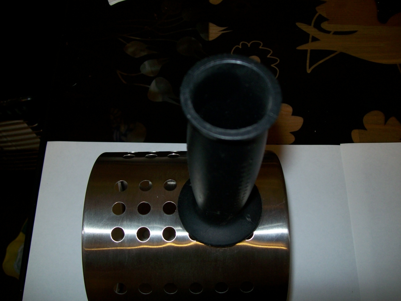

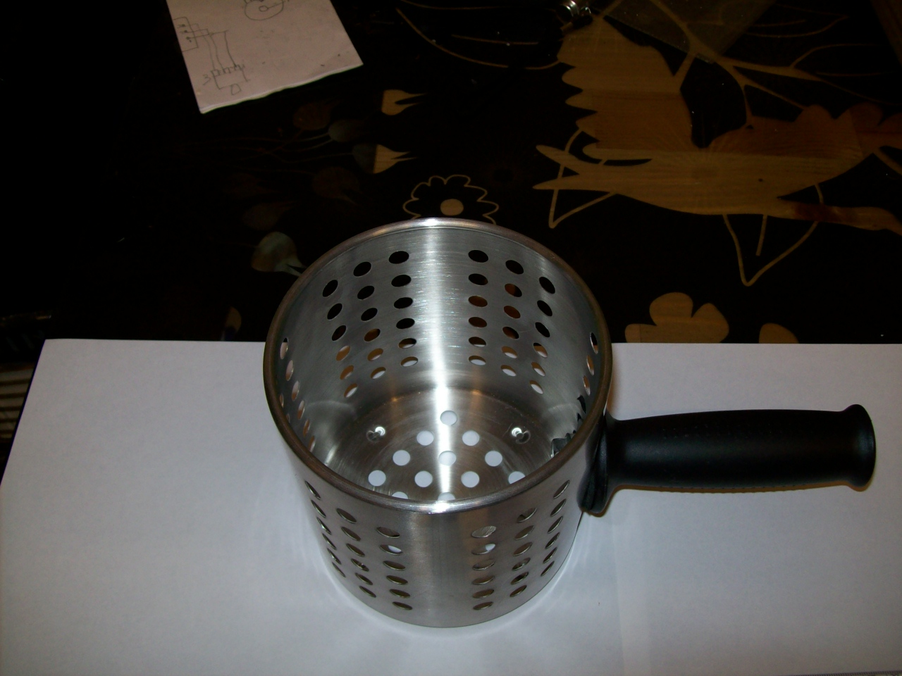

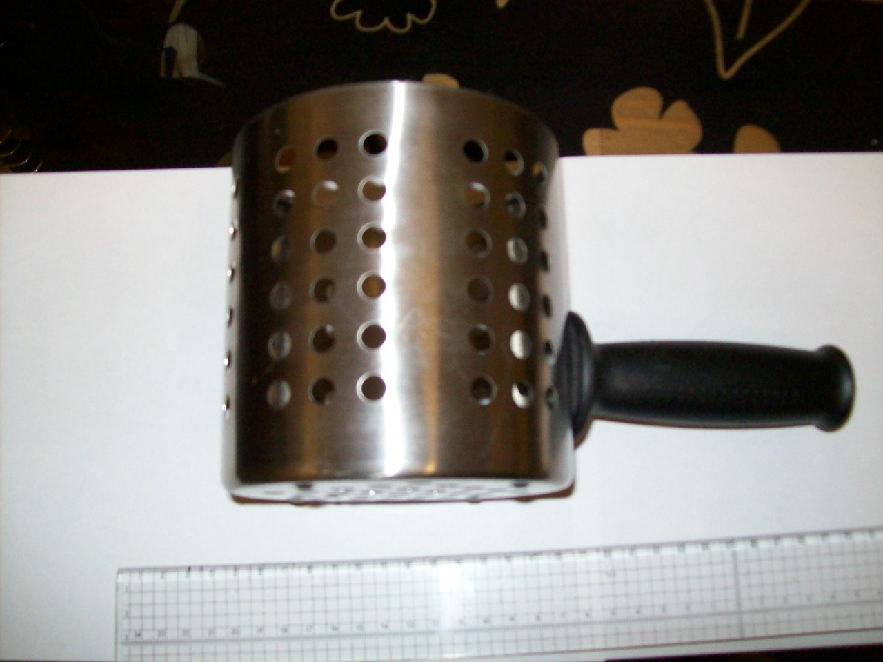

              thanks guys, all good ideas, i have actually made myself a light weight metal scoop, recently i hurt my back after i had been knocked of the KR1S, so bending down can be problematic and painfull.
ID:	341192Click image for larger version
ID:	341193Click image for larger version
ID:	341194Click image for larger version
ID:	341195Click image for larger version
ID:	341197Click image for larger version

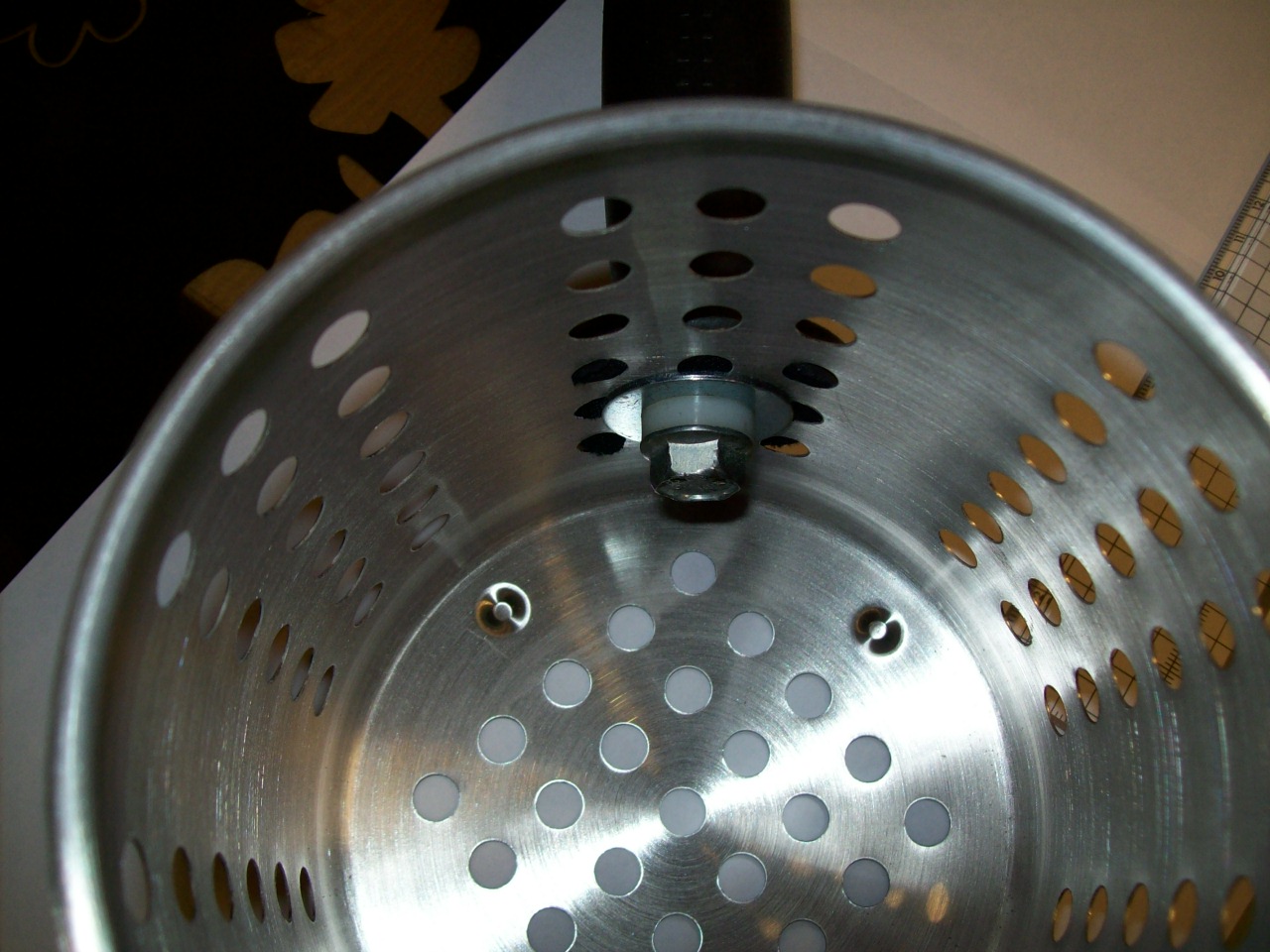

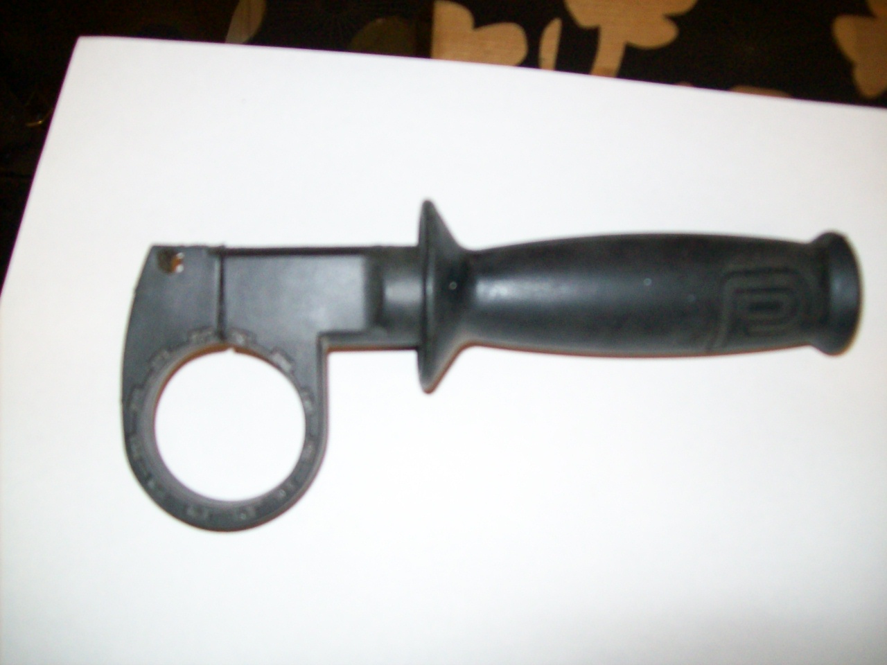

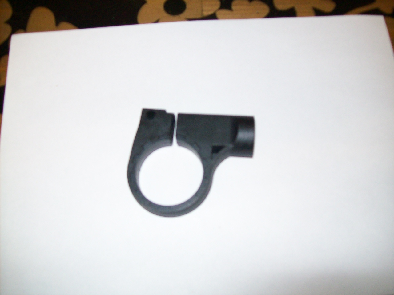

              it works great, the bowl is a stainless strainer from asda(walmart), the handle is from a drill the mounting loop is removed and the bolt replaced by a shorter set screw, this fits through one of the lower holes with a 2 pound coin sized flat washer on it.
              you then screw the drill handle onto that as tight as it goes, it works great as a hand scoop, but what i did was take the arm rest off an nhs crutch and replace it with a bike hand grip, i took off the end of the crutch(rubber bit) and inserted the ally shaft into the black handle.
              once adjusted to length no bending down is required and its strong enough to push in with your feet, pull back and shake out the sand.
              similar strainers are available from ikea, but they are slightly bigger and a lot weaker, you would not be able to stand on those and pull on them they would just distort.

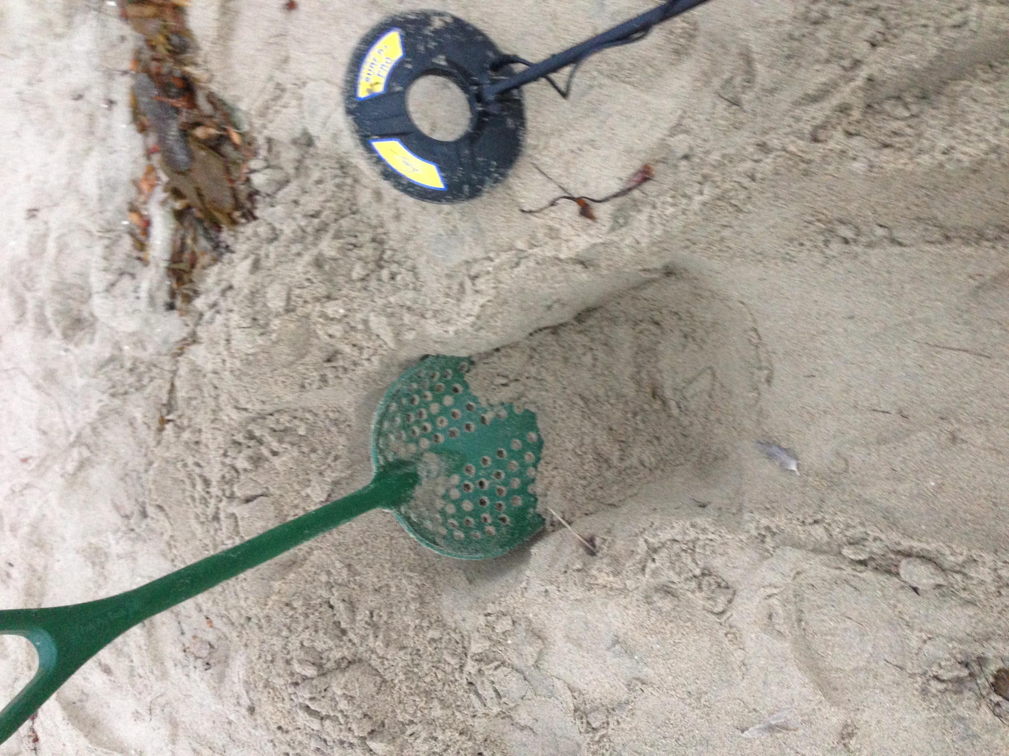

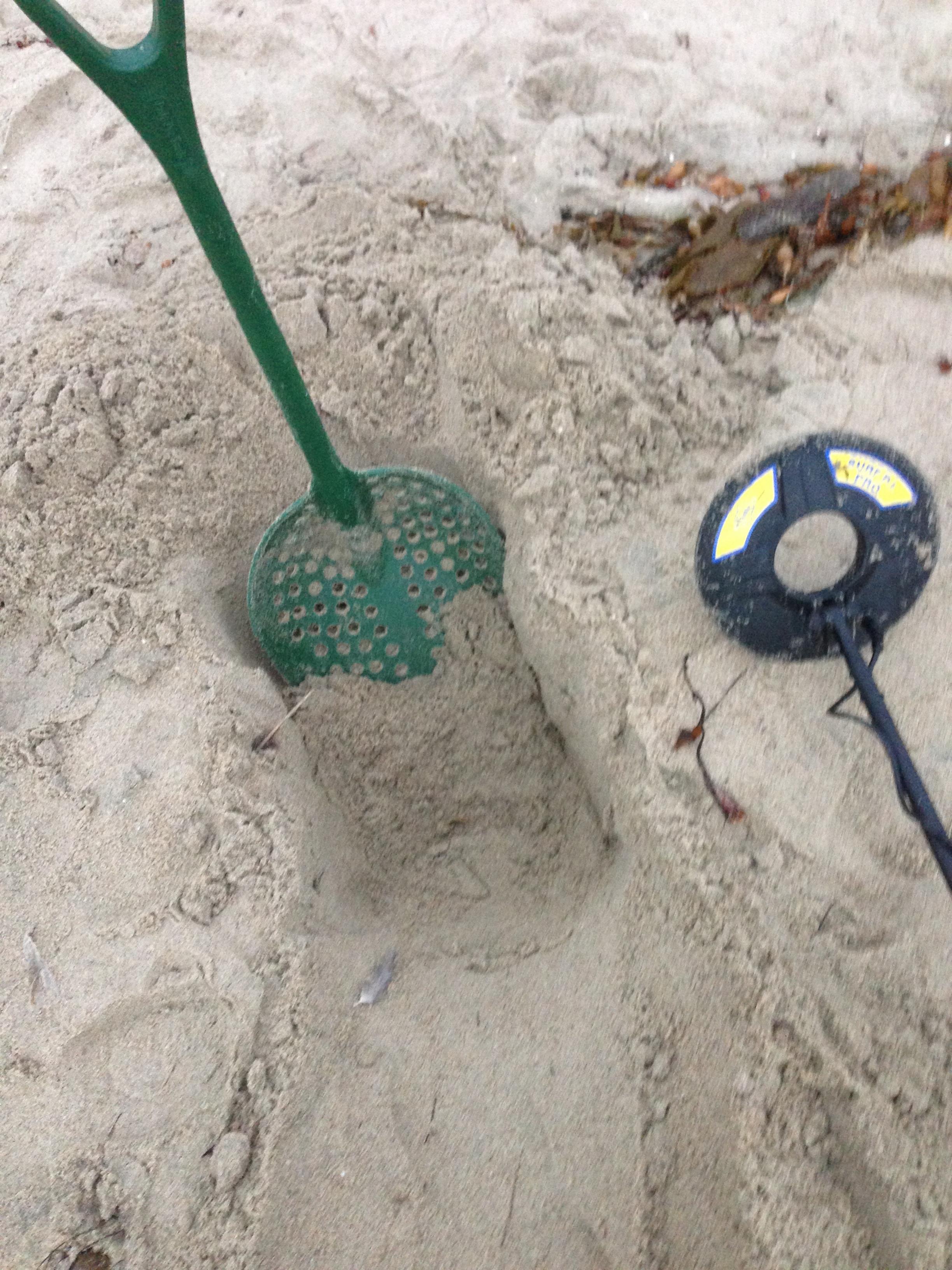

                  Here is the shovel I made after seeing that video. Bought it at DeNaults or True Value hardware and made the modifications. A bit a pain to make but it is great to dig in sand as shown (a nickel > a foot under). Doesn't do too well in water though.
