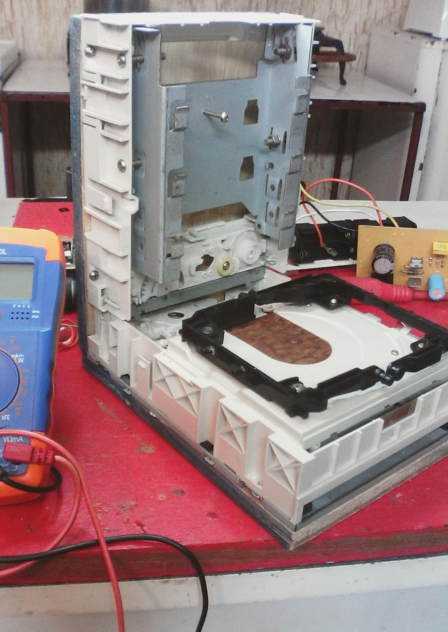

    Having seen many videos on you tube of diy mini cnc from old dvd drives, I decided to try to make one since I have many old floppy/dvd drives. I had idea to use cnc as plotter to draw layout on pcb for etching. Problem is the travel distance of the x/y axis is so small( only about 4cm square). Only good for tiny 4x4cm pcb. Is there a way around this problem by manipulating software(linuxCNC) to split layout into 4 quadrants, so I can do small section of larger pcb, quadrant by quadrant. Or maybe for drilling holes quadrant by quadrant in order to cover larger board?
    Here is cnc mini machine, its not yet finished.

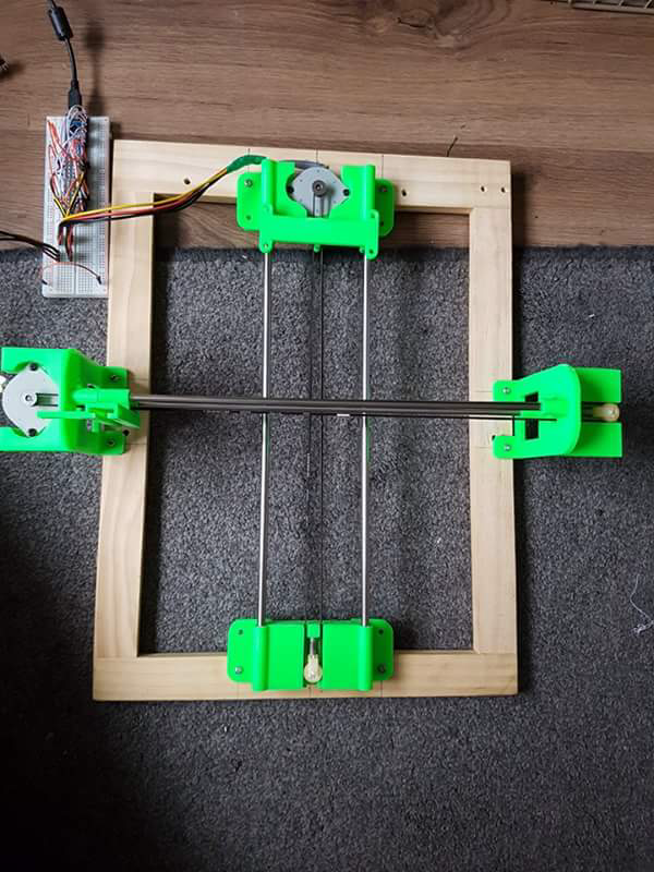

            this is mine its just for drawing on pcbs 3d printed
              Very nice! Are those stepper motors? I see yours is belt driven. Where did you get the motors from?

                        I have tones of these motors also, I'm solving the travel limitations by using the small steppers as a Coryxy ( the motor are the spools to drive fishing line) as the gantry only needs to support the weight of a small servo and a sharpie there no need to use bigger steppers. I have it all built already but only in my head haha.
                          those are Fleabay aka ebay lol motors usually in the 2$ price range .
                            Yes, I saw video of machine using fishing line. Interesting and curious, but I think it will involve a lot of calibration and experimenting to get things just right with such a design. I have Idea to make longer leadscrews out of small hot water pvc tubing or some rigid plastic tubes. I can use roller skate or fan motor bearings for gantry slides.
