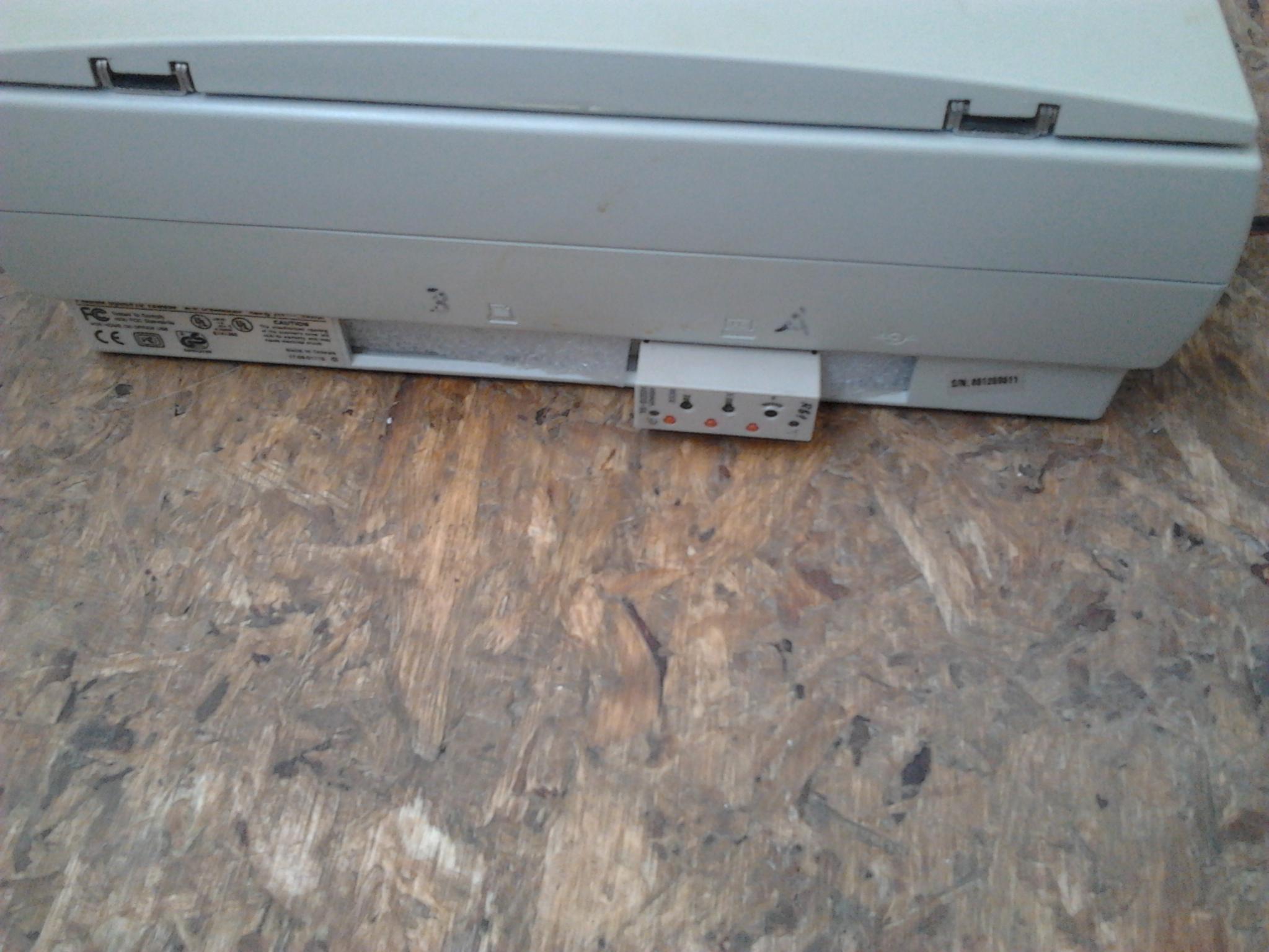

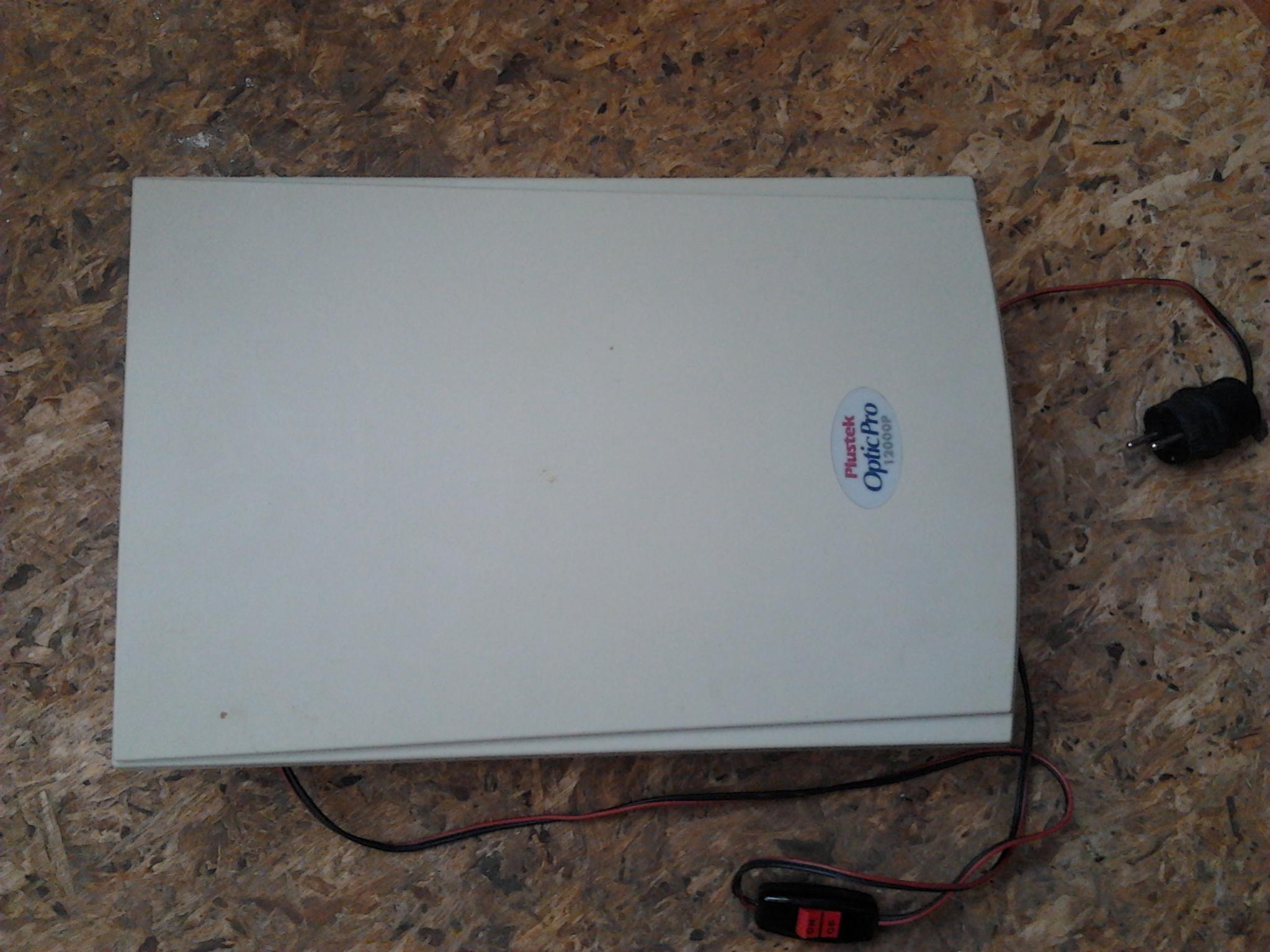

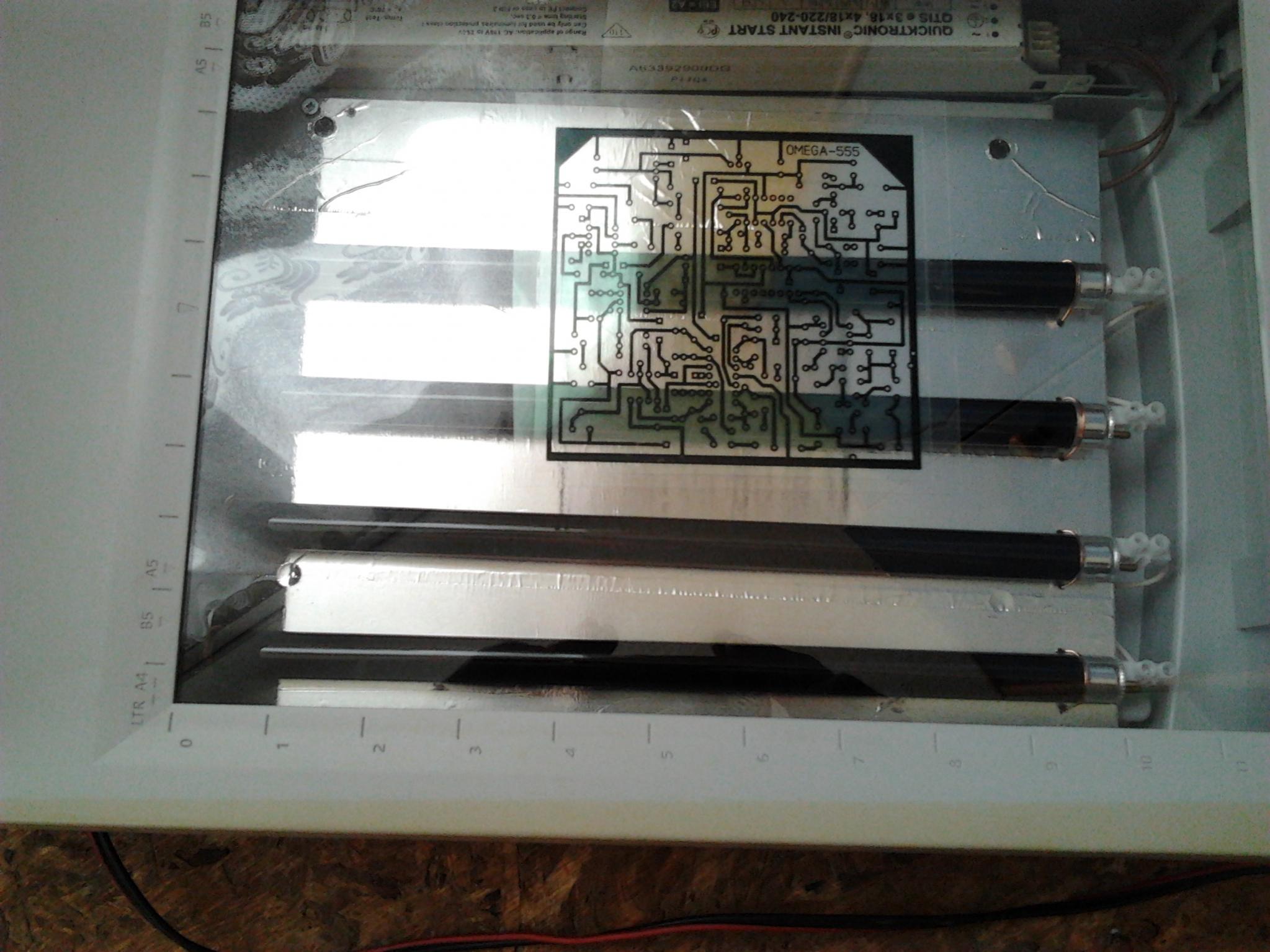

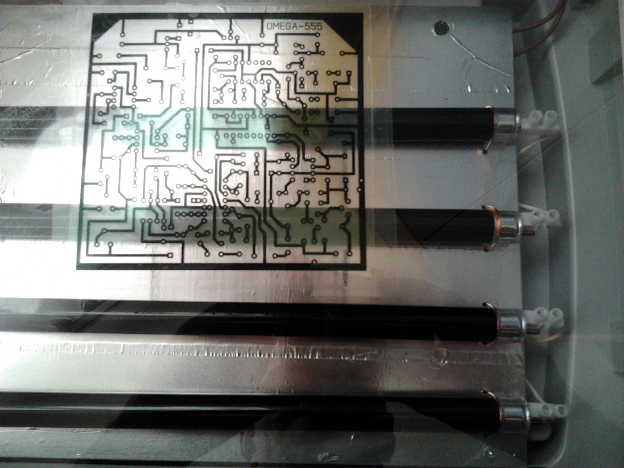

            I was just browsing for relevant posts for my project and I happened to stumble upon yours. Thanks for the useful information!
              I used many of these ways... all have good and bad points... but just ONE is the method: photographic process.
              It's simple... do you need perfection ? If so, you need that way and no other.
              All the rest simply don't apply when you go for perfection...
              You just need these things to get started:
              1. a bromograph... though the word is complicate you can make one for less than 50$ and old flatbed scanner as example look here:
              http://www.electricstuff.co.uk/pcbs.html
              http://www.turbokeu.com/myprojects/pcb.htm
              http://hackedgadgets.com/2007/02/24/...osure-scanner/

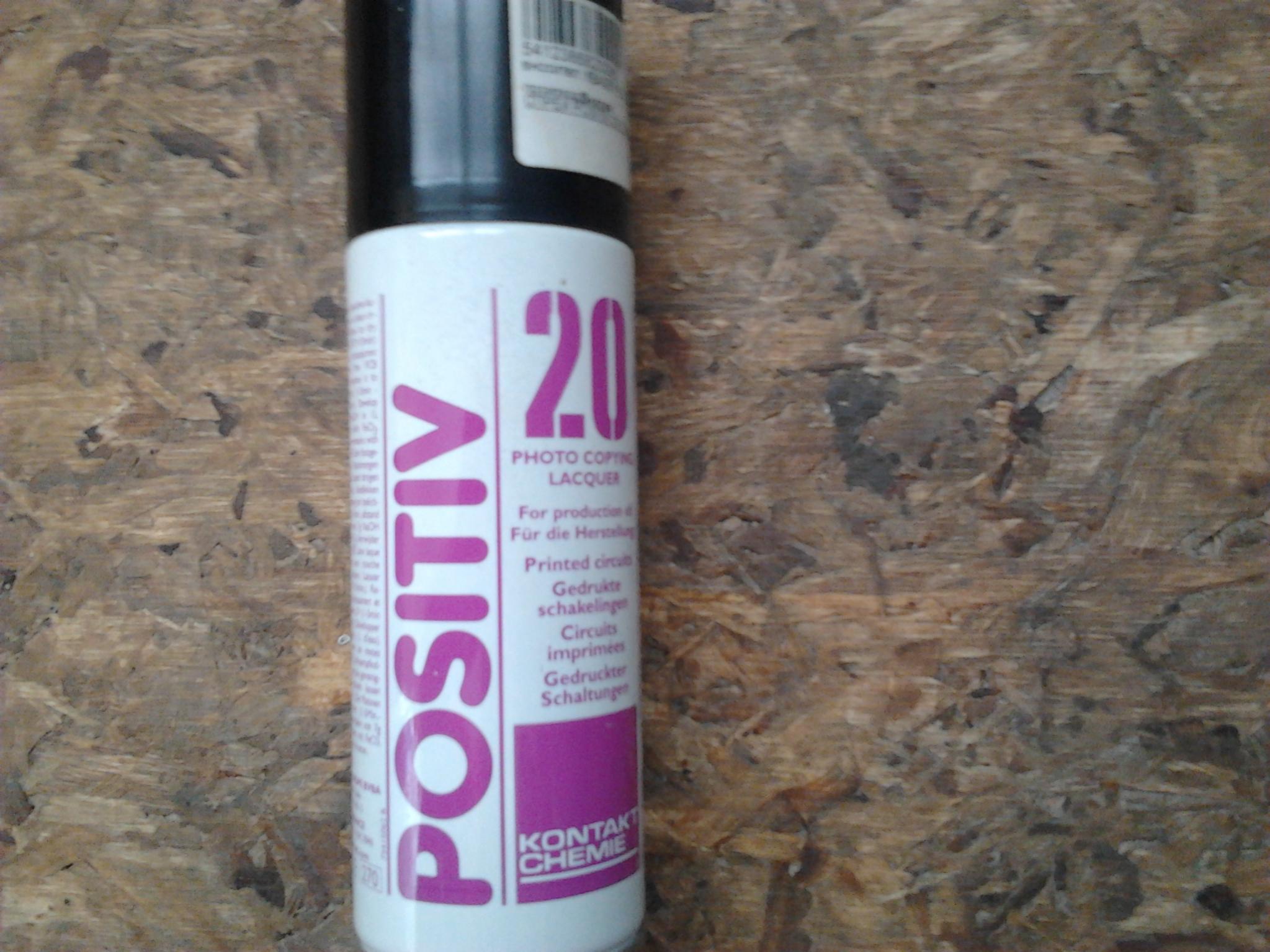

                              Making a PCB photo method at home
                              1. Pre-treatment - cleaning the surface.
                              The surface of the paint will be applied must be absolutely clean and dry. PCB zachistva with fine sandpaper, then degreased surface as a plate is immersed for a few minutes in a solution of citric acid (limontozu). Solution is prepared by a pack limontozu diluted in 500ml to 1 liter of tap water. After skimming the surface is washed thoroughly with running water. Preparation is dried between two sheets of paper. When working with POZITIVE 20, after cleaning and drying should not be allowed contact with the surface of any other solvents (acetone, alcohol, etc.). Good varnish can be applied immediately after cleaning the surface to prevent the formation of oxide layer on the copper.
                              2. Application of paint.
                              As the elbow is sensitive mainly to ultraviolet light, no application is required to be in a dark room, but direct sunlight is not recommended. Application is allowed to use it in a little yellow light that does not directly illuminate your working place. Varnish is applied at room temperature. Intoxicated is made at a distance of 20cm as to create a uniform coverage of the entire board when spraying bottle snake moves without retaining a long time in the same place, do not get a build up of a thick layer of varnish and concourse.
                              3. Drying.
                              After applying the polish, the board is transferred to dry in a dark place. Upon drying, the practice of solvent evaporation occurs a penetration varnished. Moreover, the sensitivity of the paint greatly increased, so that the board should not be subjected to illumination.
                              Drying can take up to 24 hours if it is at room temperature or 20 minutes at 70 ° C
                              Treated board may be stored for future use, but storage must be in a dark, dry place.
                              4. Printed original.
                              Production of the original print can be made by hand (on tracing paper, ink, black ink marker or solid). Of course, if the board is designed with PROTEL or another program, print the original can be printed on a printer. If you use a laser printer, you can print the original on folic plaque (note that folic plaque for laser printer and special pleading for passage in the printer's fuser). In the case of inkjet printing on vellum note that to print it on a flat side of the tracing paper (to be received spreading of ink on paper nap). If the print density is not good enough, you can use two copies imposed on each other for illumination.
                              pp It is best done with transparencies for presentations
                              5. Exposure (Illumination).
                              The pattern of the original print is mounted on a treated surface fotolak board. Good idea, the template is pressed against the plate glass to ensure a snug fit over the entire area.
                              Positiv 20 is sensitive to UV light with a wavelength of 340-400nm. For lighting you can use a special lamp (available in some stores, but not very cheap). You can also use mercury lamp 150-300w
                              The duration of illumination is determined experimentally depending on the type of lamp and the distance to the workpiece. In all cases you will need to make a few samples to establish the required length for your specific conditions. It is important to note that the identification of appropriate duration should be taken into account the time for which the light enters the steady glow. Illumination should be initiated after the establishment of the lamp to normal light. For example, using a mercury bulb of 200W, located 20-25cm from the illuminated surface, the illumination duration is 60 to 120 seconds. Note also that the glass absorbs about 65% of ultraviolet radiation, so the pressure with glass, lighting time should be increased about 2 times. Transparent acrylic has better throughput and can be used on compression if you want to reduce the exposure time.
