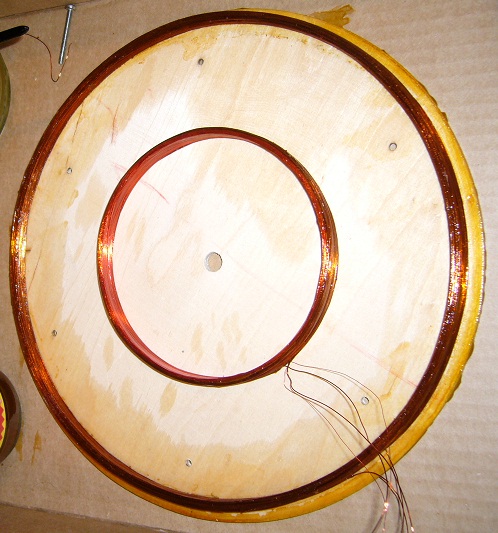

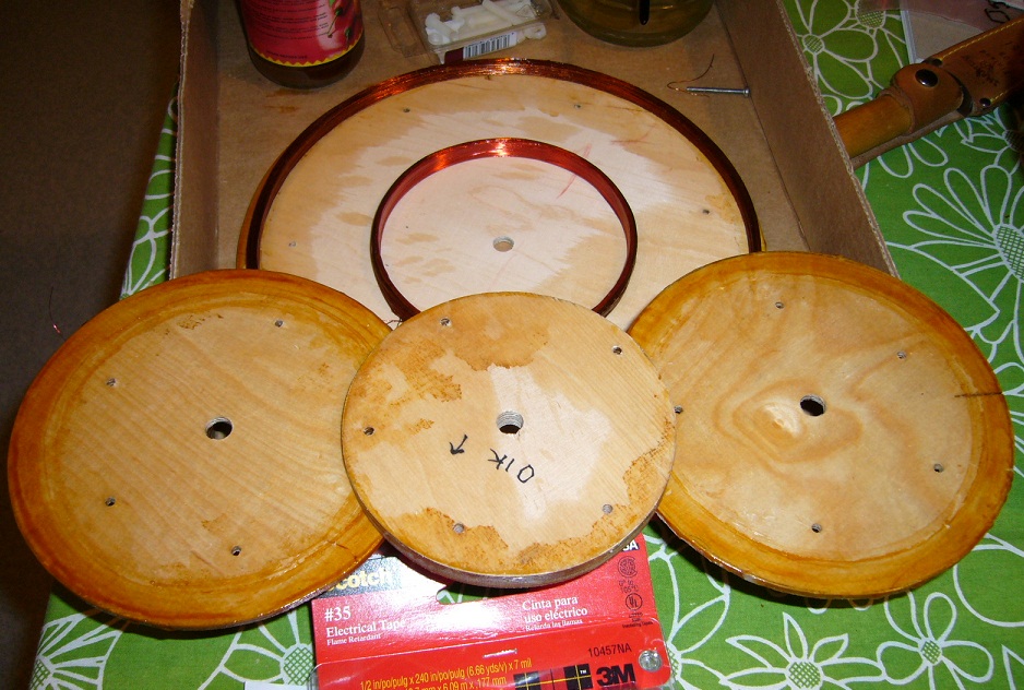

    Here are some results from experimenting with coil winding forms. I made these winding forms for an induction balance coil with 220 and 110mm diameters. They are made from three circles of plywood, with the middle one finished carefully to have a 90 degree angle to its edge after sanding it, to help with releasing the coil after winding it.
    It helps to have sanding paper glued to a block laid on the workbench with a clamp to make sure the sanding is at 90 degrees. There needs to be a slot in the edge for starting and ending a winding.
    After making sure the surfaces were smooth and without splinters, I waxed the plywood discs with paraffin (cheap candles) using a hot air gun along the edges which would be facing the windings. The wax surfaces were scraped smooth with an old magnet-stripe card, careful not to scrape the wax off completely and expose plywood, even if some wax soaks into the wood.
    The halves were fit together and fastened with small screws and nuts. A strip of baking paper wrapped along the bottom helps with releasing the coil.
    Wind coils as usual. I used a manual winder which counts the revolutions, but it's possible to wind using one of the bolts as a handle, using a clamped bolt as an axle. Every layer of windings got a smooth brush of relatively thin shellack and had a minute to dry before the next layer was wound on top of it. This method takes a bit of time, especially with the RX coil, but results in a firm coil which keeps its form with moderate handling.
    I let the coils dry for two days before carefully prying the edges open, using a thin carpet stiletto to pop the halves open. I manually rearranged the slightly shifted segments of winding to lay as they were and let the coil dry for some time, brushing on some slightly thicker shellac along the exposed sides of the winding. After it set, I carefully pried the windings off the middle discs of plywood, rearranging shifted windings as before. The baking paper strip was easy to remove, and I applied a coat of thicker shellac to the insides of the coils as well.
    Shellac takes a couple days to set perfectly, but dries to the touch in mere minutes since it's ethanol based. It won't attack wax either, and it's easy to adjust the number of windings afterwards as shellac wound coils are easy enough to unwind manually. It scrapes easily off the wax surface just by scraping it off with the same magnet-stripe card.
    Shellac is not as stiff as polyester or epoxy would be, but it's firm enough to keep the shape of the coil before potting. Also, it's easier to work with since it dissolves in alcohol even after drying.
    Would I use this process for another set of coils, though? It takes a couple days. The results are quite stiff and retain their shape well, but I will probably look into making winding forms from cardboard or fiberglass in the future
    Here's a picture of the finished coils, laying atop the side of the larger TX winding form. The other picture shows the three pieces that make up the similar but smaller RX winding form, and the five holes for bolts around the axle hole, for the bolts clamping it together during winding.
