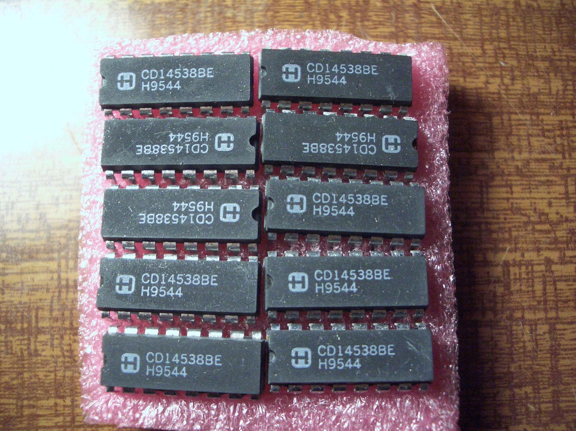

            • Which aliexpress.com seller has all IC and transistors for Delta Pulse Rev5 at a reasonable price?
              4538s arrived. checked in DP and they are good.

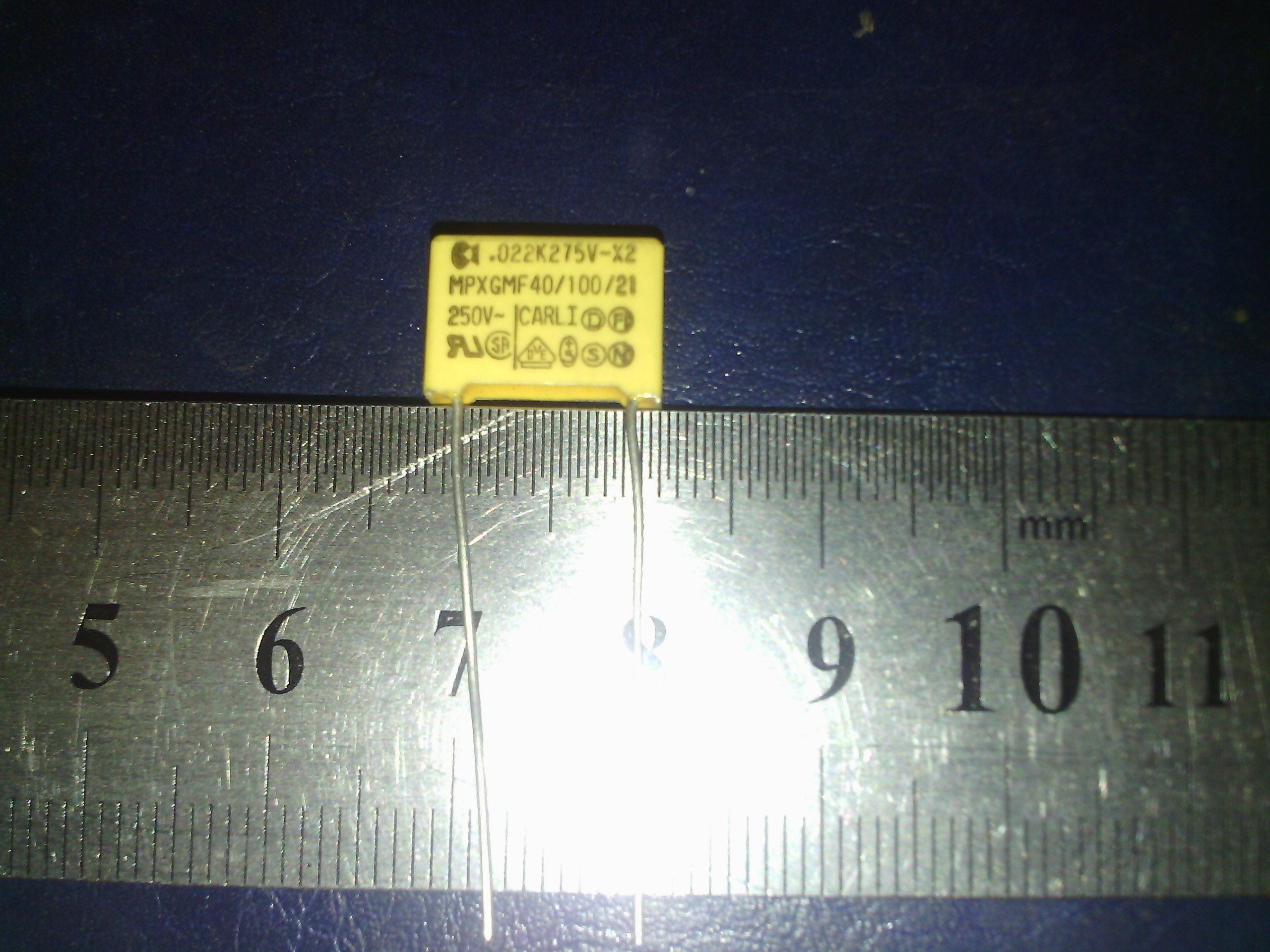

                    • Is it o.k to use some 0.1% 1/8w resistors with 1% 1/4w resistors?
                      Can i use C3 15nf 250V?
                      • yes but you must choice the pairs near to value -- look sch and part list.
                        board feets 1/8 and 1/4W resistors everywhere.
                        C3 250V 15nF put pics what it is, what type. put a ruler near i could see a size.
                        R23 4k70 0.125 or 0.25 0.1% and better
                        R24 R23 and R24 tuned in pair 0.1% and better
                        R25 0.1% and better
                        R26 R25 and R26 tuned in pair 0.1% and better
                        • rego in esspecially made thread by me
                          to learn what are resistors and their power etc.
                          https://www.geotech1.com/forums/show...sian-tradition
                          • Here is C1 22nf 250v. C3 is same voltage and colour and shape. Can i use it?Click image for larger version
                            • size is big, they does not fit the pcb. pins step has to be 5mm-5.08mm.
                              use green type. ЗЕЛЕНЫЕ СЛАДКИЕ ПОДУШЕЧКИ.
                              sorry i do not know how it in english.
                              or ceramic type.
