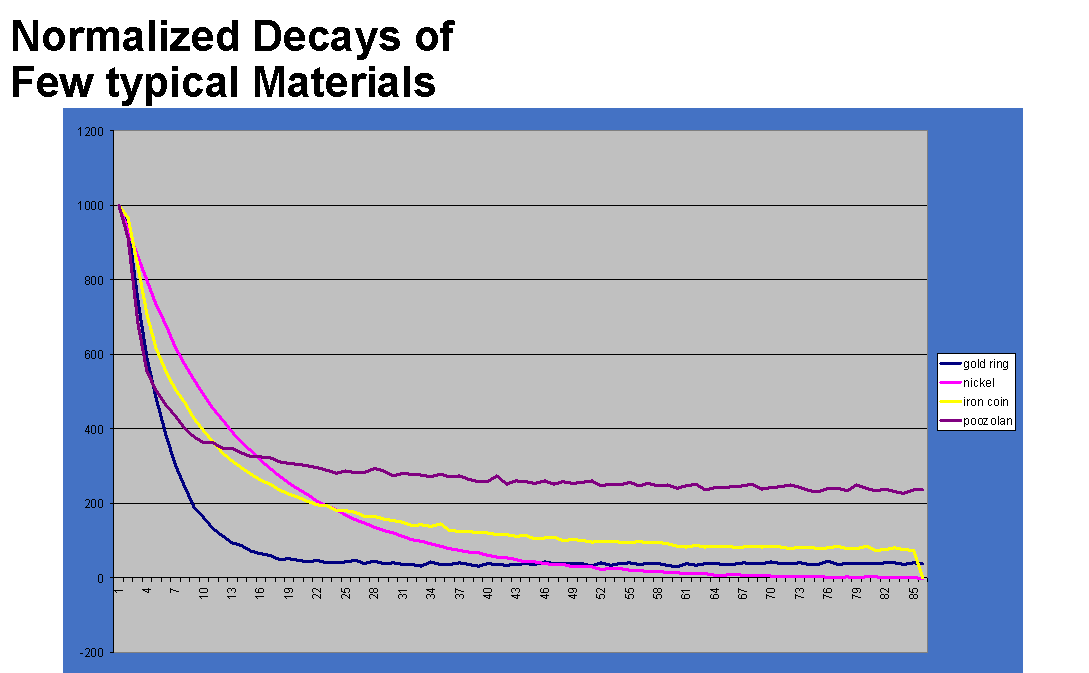

          I don't quite understand the "math" behind the need to sample at the highest possible sampling rate as 500ksps.
          And that 96ksps is not enough to reproduce such a signal.
          Let me try to do some math and you correct me if I am wrong.
          96ksps = 96 000 samples per second.
          Respecting Tony's proposal: 25kpps = 25 000 pulse per second = 25 000 decay curves.
          96/25 = 3.84 samples per decay curve.
          500/25 = 20 samples per decay curve.
          I don't know why Tony insists on 25kpps?
          If we reduce the pps to 5kpps, let's see...
          96/5 = 19.2 samples per decay curve.
          500/5 = 100 samples per decay curve.
          How many samples do we realistically need for one decay curve?
          Isn't it unnecessary to sample the whole decay?
          I didn't follow the threads about it, but how much was the TC for the average gold nugget?
          But I remember from the occasion that we used to talk about the need to analyze the decay curve only after it falls to a certain value.
          Unless you want to reproduce the complete decay curve...
          Then even 500ksps will not be enough for 25kpps.
          I need someone to explain all this to me, I don't understand anything...

              I shall try to answer the question of IVCONIC.
              I am sure that some readers will find approximations in the following description but I have intentionally
              simplified the real process to make it clearer.
              Let's take a pulse period of 40µsec(25Kpps).
              (Why 25Kpps? That is to improve the SNR, more samples per second = more samples per unit of swing. A swing at 1m/s moves the coil 1mm/msec.
              If you want to catch a small nugget, you need at least one NET SAMPLE per 10mm or 10msec. At 25Kpps, we get 250 raw samples for 10mm, thus, we can apply a digital integration of 250x)
              From that, we should remove the time of the pulse itself and a bit more to take into account the damping delay necessary to remove all the oscillations due to the flyback.
              We are left with say, 30µsec of exponential signal decay.
              A small gold nugget has a TC of 1 µsec. This means that the signal has decayed to 37% after 1µs, 13% after 2µs, 5% after 3µsec,1% after 5µs.
              Using an ADC which really captures data at 500sps means that you get a sample every 2µsec.
              Over the 30µsec of decay, you can get 15 samples. That is already very short to extract any info from the decay.(1% left of the signal after 5
              µs!!!
              Using an ADC which really captures data at 96Ksps means that you get a sample every 10.5µsec.
              Over the 30µsec of decay, you can get 3 samples.
              What can you do with that? The whole decay is completely embedded in the first sample. The only thing you could extract from that is the fact that there was a TARGET of any type.
              Let's take a pulse period of 200µsec(5Kpps) (At 5Kpps, we get 50 raw samples for 10mm, thus, we can only apply a digital integration of 50x)
              We have 190µsec of exponential signal decay.
              Over the 190µsec of decay, you can catch 95 samples. That is more reasonable BUT the only important part of the decay is still located in the first 5µsec. This will not be enough to make a difference between a gold nugget and a piece of iron junk.
              This was with DIRECT SAMPLING.
              For INTEGRATED SAMPLING, the calculations are quite different.
              What we capture are the results of the analog integration of WINDOW periods defined by analog switches.
              Since the integrators keep a memory between consecutive pulse periods, the ADC captures can be made slower without loosing info.
              Thus, an ADC at around 100Ksps could still be used.

                              Click image for larger version  Name:	dataurl527527.png Views:	0 Size:	8.4 KB ID:	409130
                              An illustration of the challenges we have to solve with PI detection.
                              Those are REAL decays which have already been amplified a lot, normalized and filtered.
                              Do not get me wrong, they are not the shapes of the decaying signals, they are the difference between the ground signal and the target signal.
                              As Carl has rightly said, there are a lot of info in the decays as you can guess by just looking at them. You can see the various TC (GOLD = shortest TC).
                              BUT:
                              1. You have first to capture them (all or useful parts of them) with as little noise as possible and as much magnitude as possible (Note that the end of the decays are mostly lost in the noise)
                              2. You have to decipher them using DSP and extract the useful info
                              3. You must have the time to do the DSP​
                              4. You need to define how to report the results back to the user
