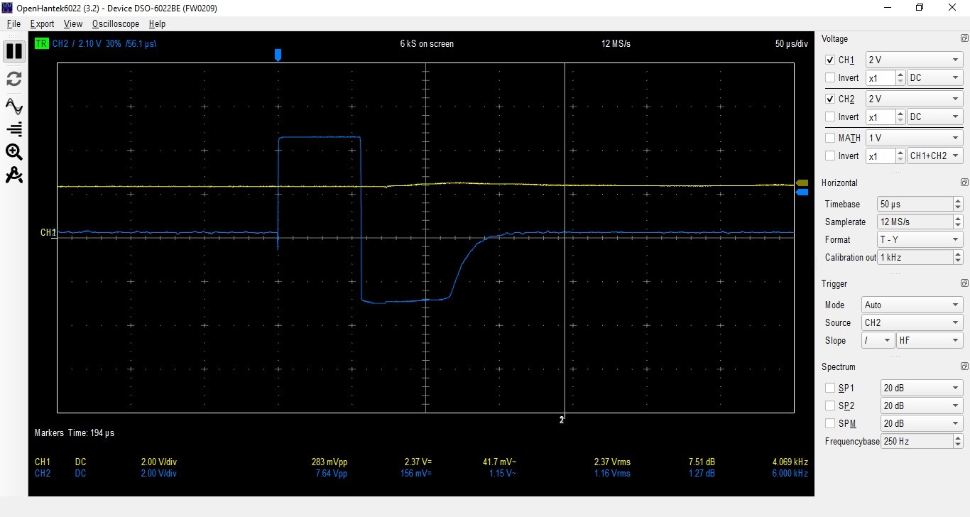

                • is there a error on the audio integrator circuit i just built this and TP10 and TP11 is not very responsive
                  • Originally posted by kosacid View Post
                    There is definitely no error in the ANPI design.
                      At about the 2 minute point in my video I show what TP 10 and 11 look like as tested with my oscilloscope.
                      ​​​​​​https://youtu.be/G1gUYHVw20k
                      • yes it is fine i built another and it is working fine but the board thats not working i striped the caps and redone the integrator still the same i get a slight curve on the scope on TP11

                        • love them videoes by the way
                          • if you look at the yellow trace you will see a slight curve i wonder if there is a short on the amp going to remove the chip holder and try again the line gose up and down when you adjust the threshold
