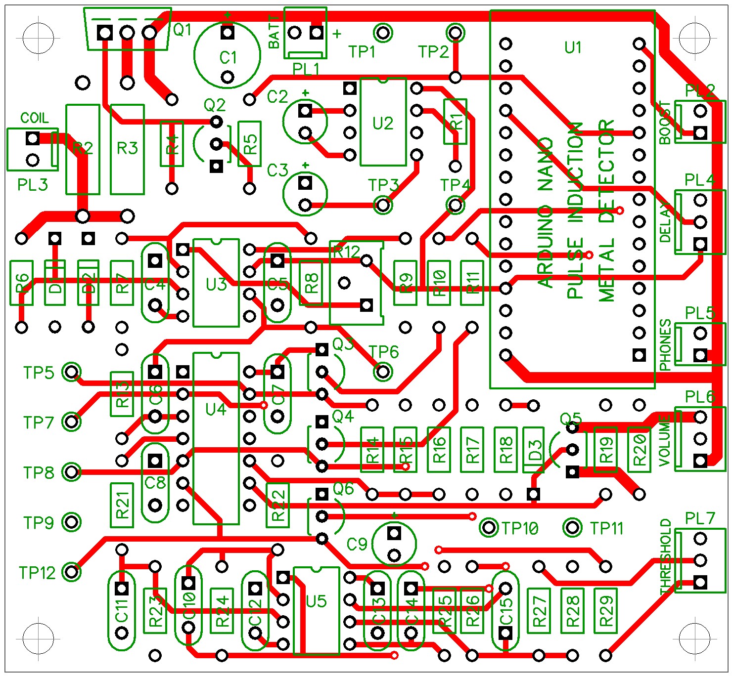

                              Hi 6666 thanks for doing the pdf on the pro Q. In the past I've had to take pictures of the board and post them
                              now that you guys have done it I can figure it out by your posts and you guys wont have to look at bad pictures of my boards anymore
                              Cheers

                                All good GD
                                the trick with the pdf is to use the scale and print scale and drag to get the sch inside the square
                                you can also save the sch or pcb as a bitmap or jpg, on a win 10 machine
                                File
                                preview
                                adjust scale and print scale
                                click the + to drag the sch or pcb into square with mouse, then alter the scale and print scale to suit
                                save
                                save as bitmap or jpg
                                change to 300 DPI to get a good quality picture when zooming
                                name file
                                save
