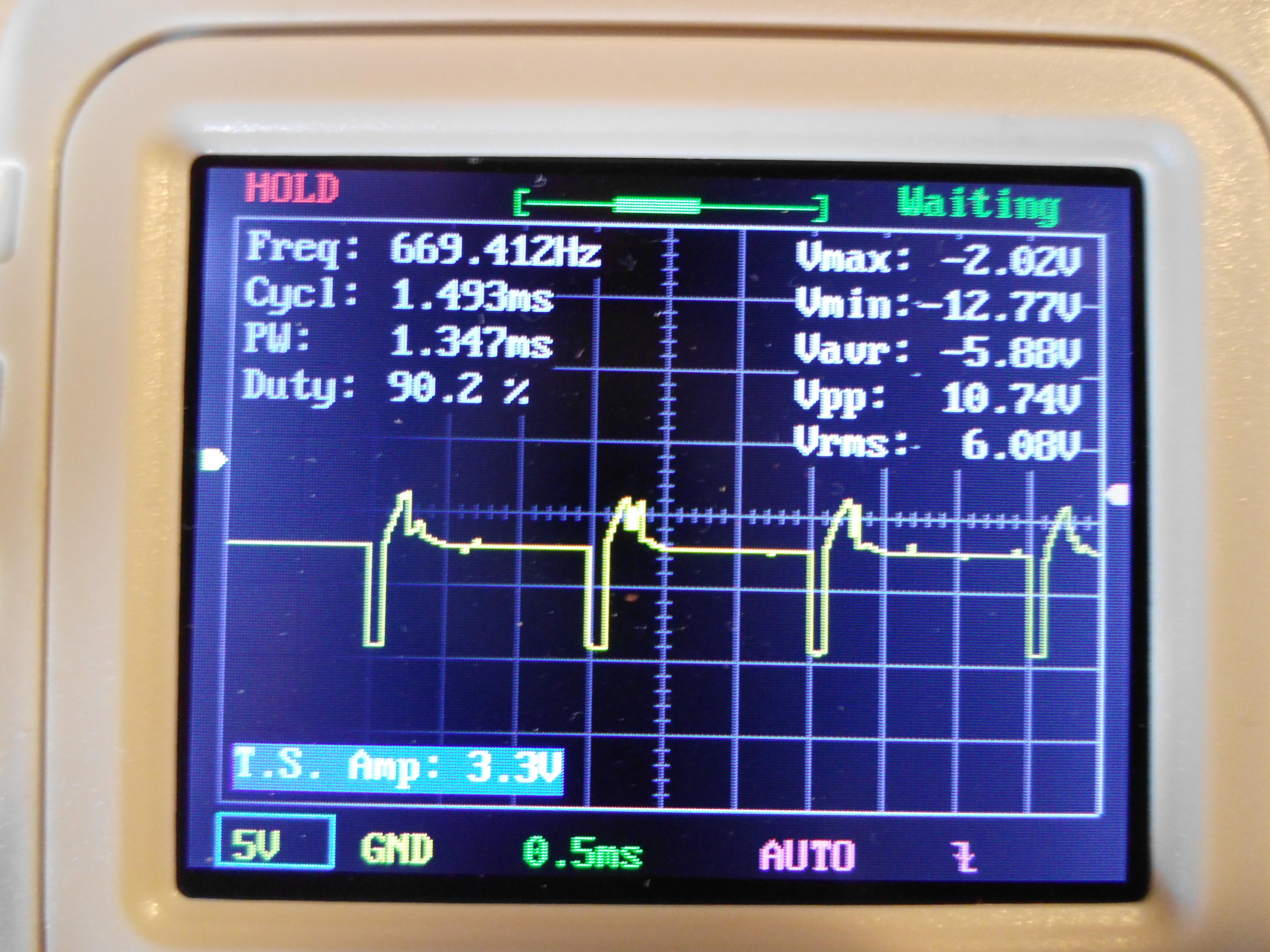

                              This is TP2 (at the left from U4): Click image for larger version
                              I cant get a signal from Pin8. Or im too stupid to measure it.
                              Measured without Coil and 12V.
                              EDIT: I just saw that i measured Pin14 , not Pin8 :-D

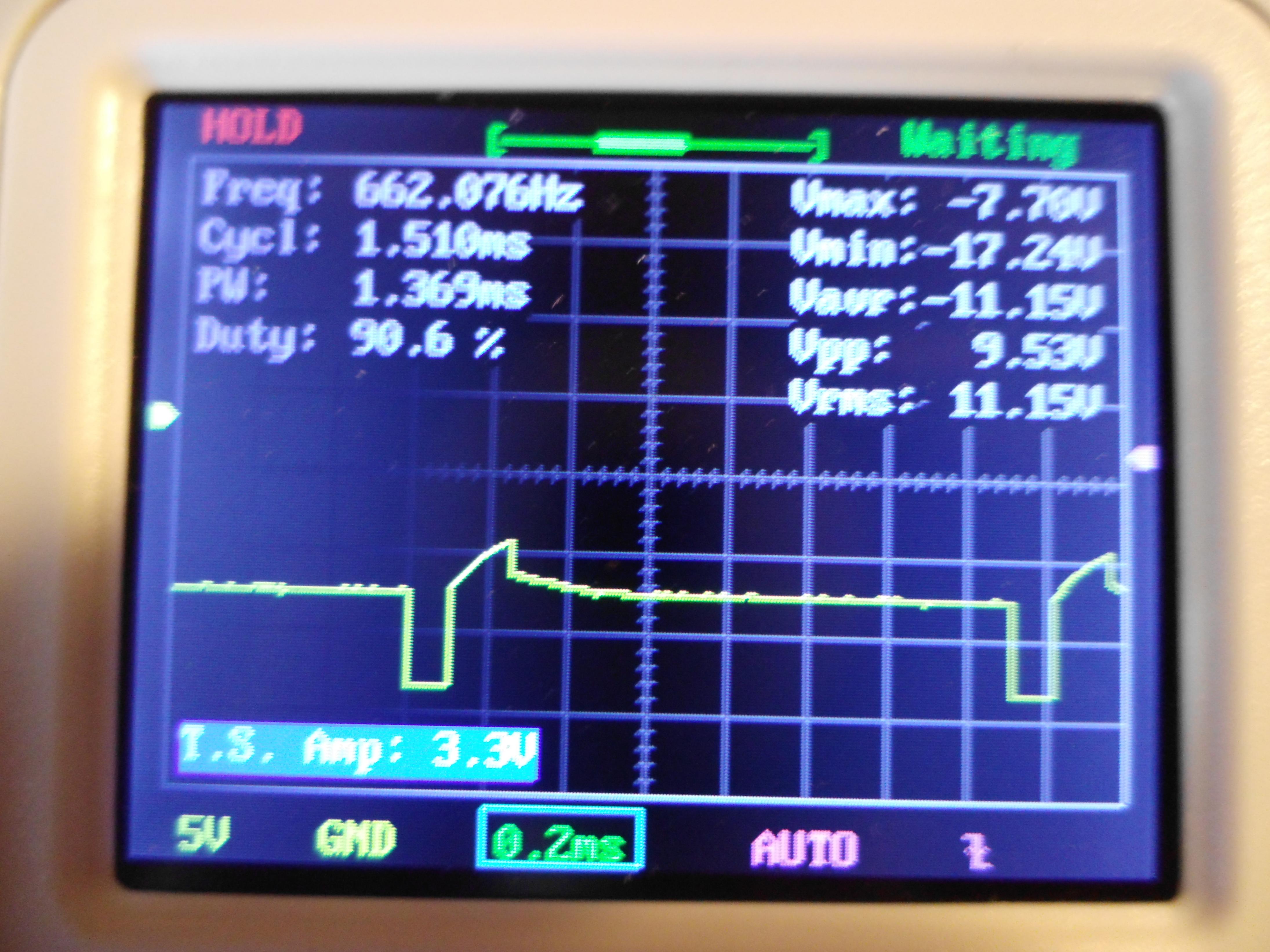

                              • #60
                                I completely pulled out two through hole platings where the mosfet is.
                                Was not a good Idea to desolder the mosfet.
                                Here is the Signal from the gate of the Mosfet, with desoldered Mosfet.
Name:	Gate Signal Mosfet.jpg
                                I can not measure anything at pin8.
