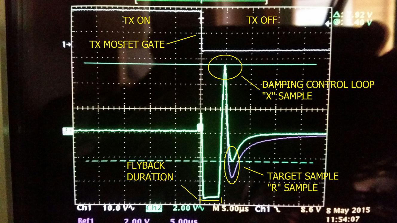

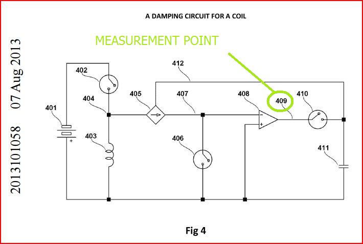

          Hi WM6 ... I have grown tired of secret squirrel detector projects so very shortly I will gather the documents and publish my design for a kickass PI detector.
          This detector can resolve X and R signals from a MONO coil in the time domain ... and using only two samples ( this provides ground rejection AND opens the door to discrimination on a PI )
          See Pix below ....

            Are this signal from your scan to support sampling?:
            What sort of synchronization exist between parts 402, 406 and 410 from your block scheme?

              Hi WM6 ... those 2 lines are just markers on the CRO to measure the peak to peak levels.... they are not part of the signal.
              Switch 402 is the PI TX switch. Switch 406 turns on only during flyback and Switch 410 very briefly at falling edge of flyback ( it is the "X" sample for the control loop ) and measures the residual voltage after flyback which is the "error" voltage for the control loop.

                          I noticed a method for direct X sampling by detecting the change of voltage at a snubber. With flyback controlled by snubber you get preferably a flat top voltage, and it is dependant upon the changes in permeability of the coil surroundings, or a presence of ferrous objects. The way you do it enables using the same front end for both X and R.
                          I observed the same effect with active damping using a MOSFET as a constant current device. Initial overshoot is inevitable, as the effective resistance at the beginning of Rx period is too much for a meaningful damping, but after the other hump it stabilises at proper resistance values and effectively it is faster than the critically damped coil. Detecting the first hump for X component is brilliant.
                          Well done
                            Thanks Davor ... you are right .... Initially I was only after faster damping ... the "X factor" was a bonus.
