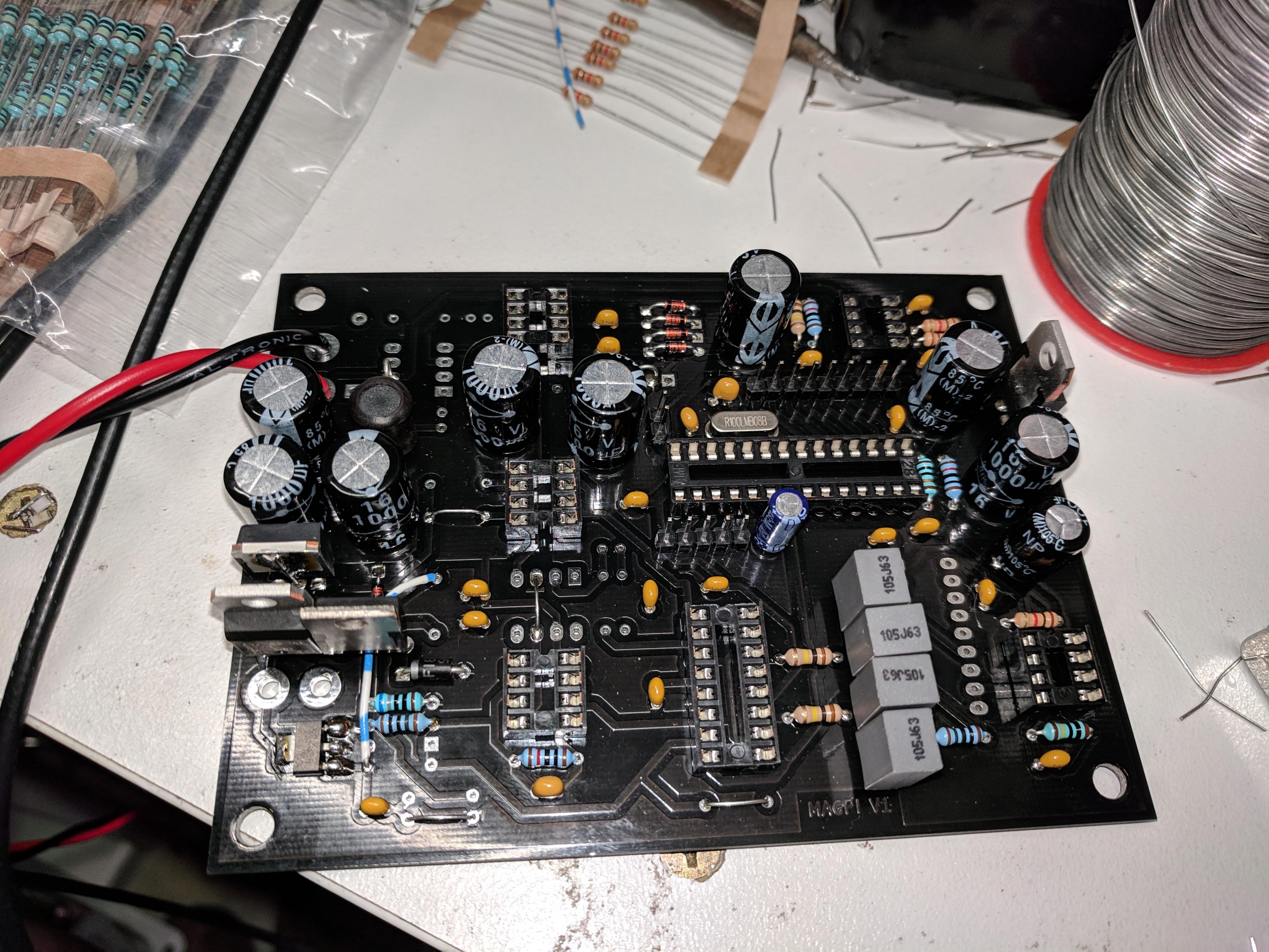

      I have 10 of the V1 boards .... but need to make sure they work ;-)
      This board is configured in "surfpi mode" ... ( no switchmode supply, "traditional" damping resistor .... I used a thickfilm power resistor but the board is spaced for a 5 watt vertical mounted axial type. )
      However it does have the "autoswitch" front end.
      There is one wire link ( my bad ... missed one track )
      Other than that it should be good.
      I did not socket the 18pin diff amp because I did not have an 18 pin socket ... doh.
      we will see shortly .....

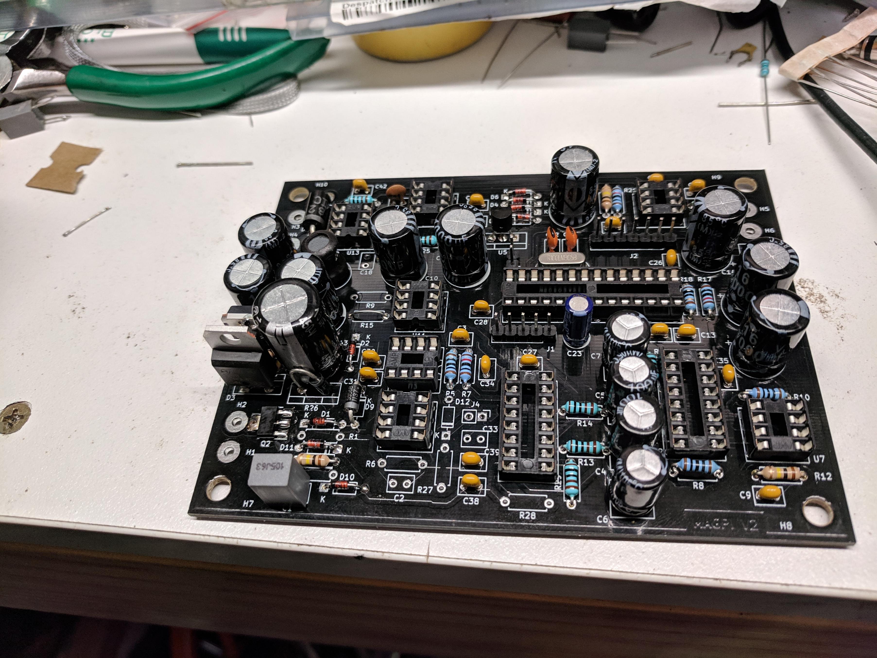

        Step 2 ... fit the CPU (which generates the pulses for the negative voltage charge pump) and the tc4428 mosfet driver chips.
        turn on the power ... it works ! No smoke.
        CPU is running and negative voltage rail is up.
        We can now fit the other chips ....

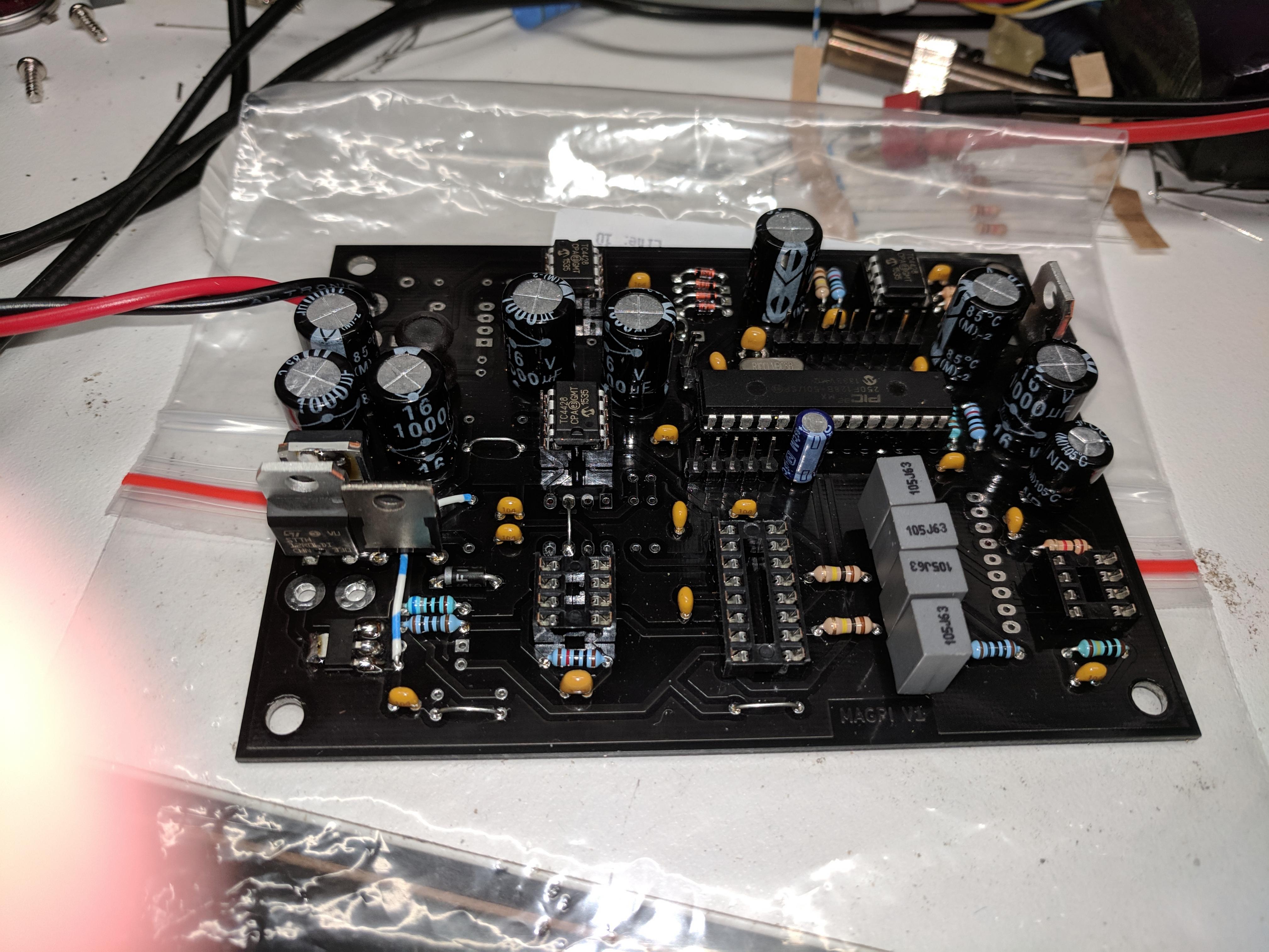

          Step 3 ... fit all other chips and discover why 18 pin socket was not needed.
          Doh ... the board layout somehow translated a 16 pin socket to a 18 pin socket. No matter ... a bit of solder surgery and it works. :-) Stand chip on its side solder pins 1 - 8 and then cross connect the other pins.
          PCB will have to be revised. ( V2 ).
            Oops...but at least it works��

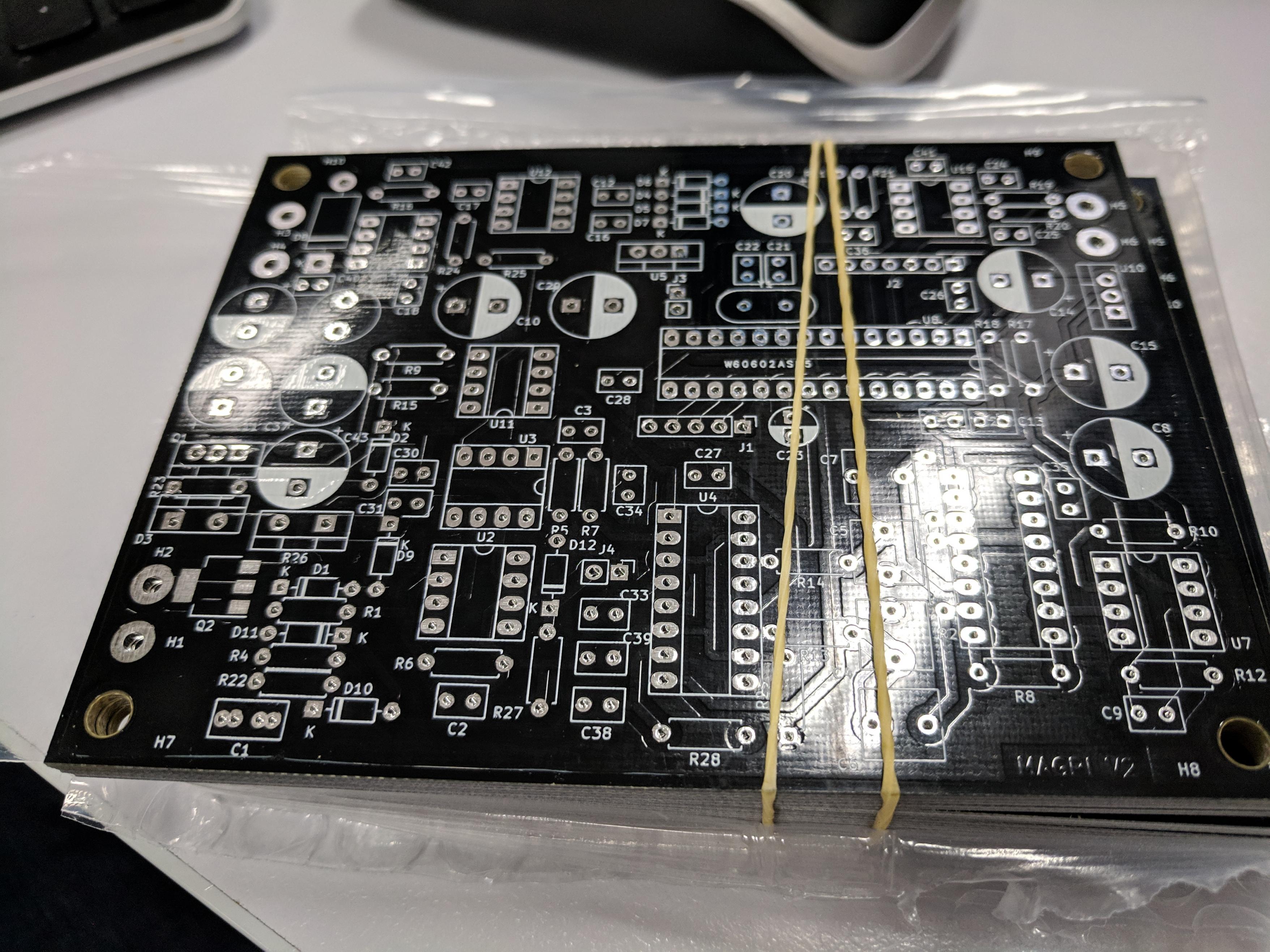

              ...ordered the V2 boards.
                Nice work Moodz
                  V2 boards arrived ! Click image for larger version

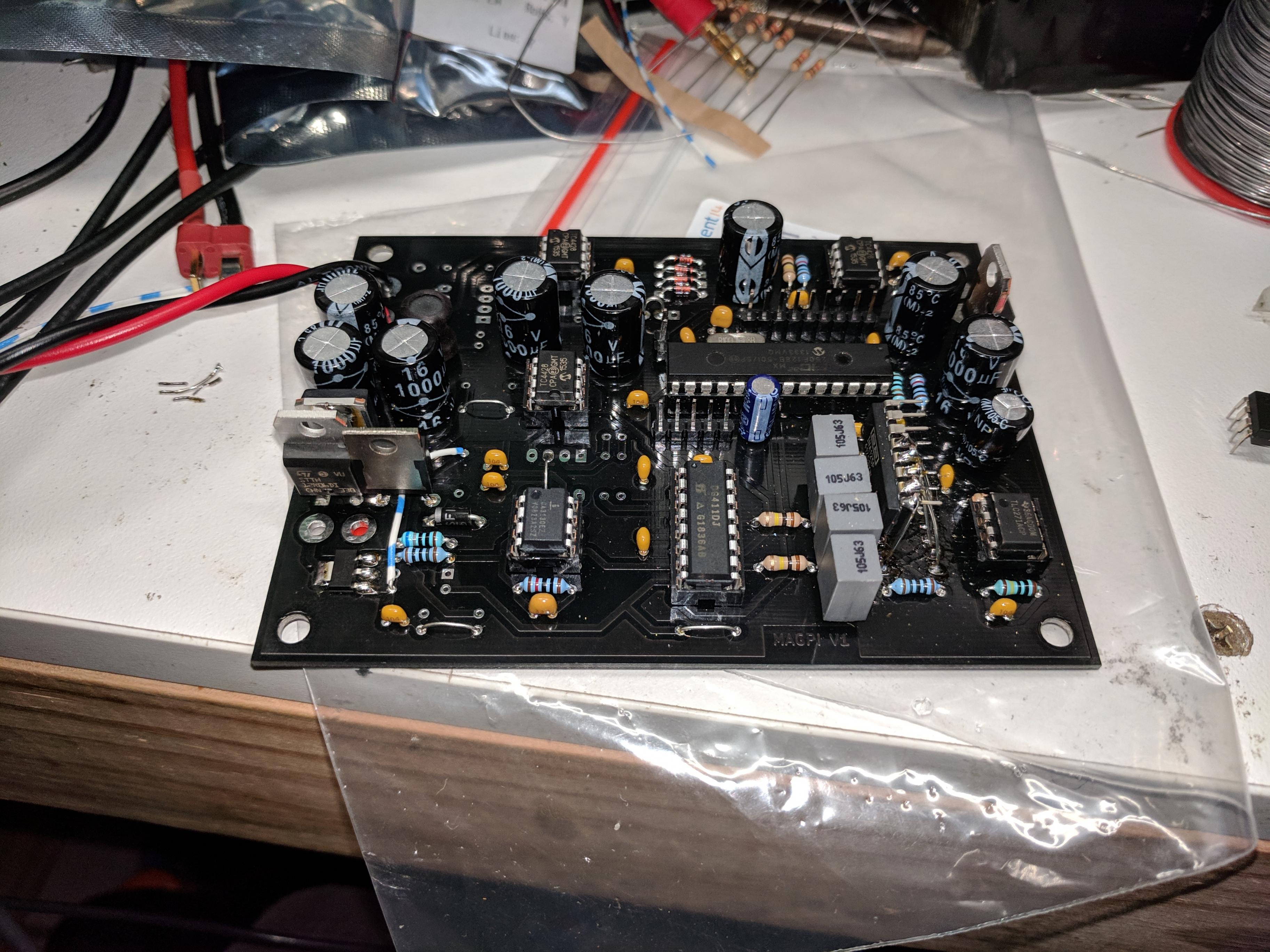

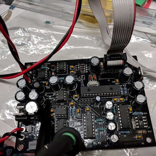

                          Here is the board loaded ready for first power test before pluggin in the chips ;-)
                              Nice "darkness" look!
                              Should be full success. Awaiting your test report.

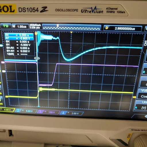

                                power tests passed .... no smoke.
                                connected coil ... no smoke.
                                Measured the flyback and out from the preamp ... excellent ... damped in 2 microseconds with sampling at 2.5 microseconds.
                                This version was built with the active damping and noise cancelling preamp so it achieves faster damping than the resistive damping model ( the pads are on the board for this version also ) which can only do sampling at 4 usec earliest if you are lucky.
                                Current draw from 12 volt supply is 180 mA
                                TX voltage is 5 volts ( can be changed )
                                PREAMP GAIN = 100
                                TX period = 80 usec
                                RX period = 80 usec
