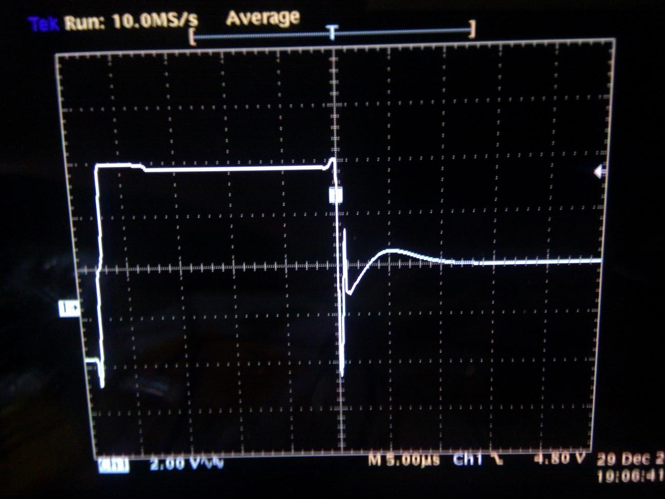

Waveforms + Measurements
    The way I see them :
    A=> start of flyback (end of TX)
    B=> saturation during flyback
    C=> coming out of saturation during decay
    D=> ending of decay
    F=> quiescent level (fully decayed)
    G=> start of TX pulse
    H=> TX pulse duration

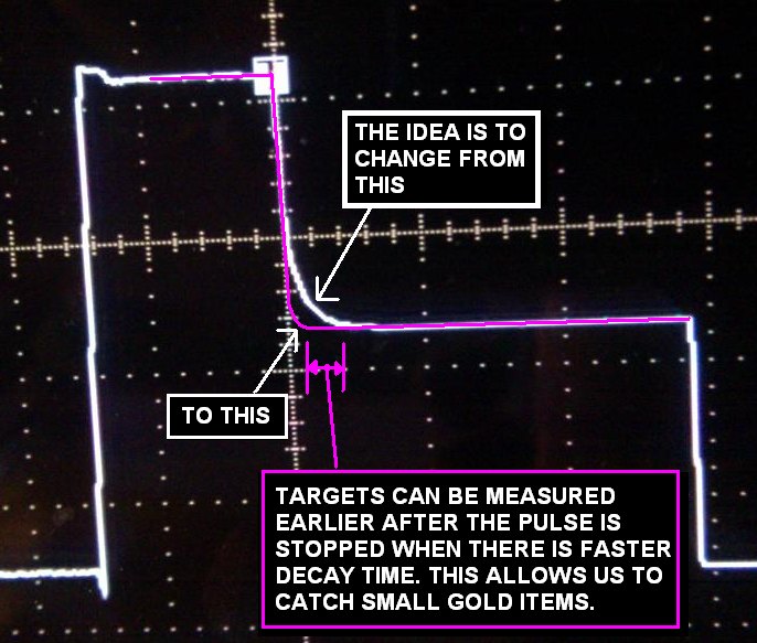

        With faster decay you mean something like this?:
        Hi WM6,
        See picture to understand what we want the pulse to look like.
          The request to Moodz. Before the measurement always place the oscilloscope track exactly on the zero. Himself will avoid like this misunderstanding.
          I have simple solution of this problem which I use for a long time. This is short DC correction pulse in the end flyback. I will send schematic when I will draw him.

            Thanks and noted .... I am used to to just positioning it anywhere and taking relative ... however in this case note that the output does not decay to zero volts. It decays to analogue ground which in this circuit is the battery +ve 12 or so volts. I dont have the fancy differential probe so I can reference the signals to ground. However I will try to be more attentive to initiial positioning of the trace.
            moodz.

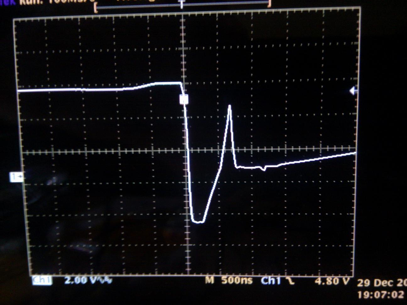

              Eureka ! I am surprised and delighted at this result.
              Originally posted by J_Player View Post
              Hi WM6,

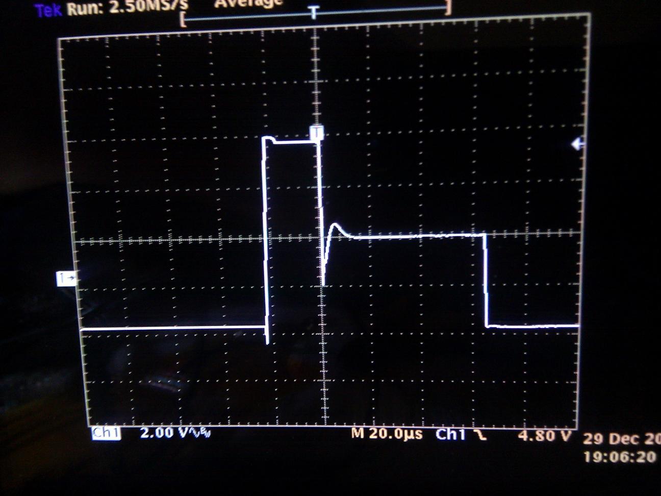

              I removed the 220pF bypass cap and all the 1n4148 diodes in preference for a fast switching heaver current type ( 32 amp impulse / 10 pF reverse ). I have been "tuning" for want of a better word the damping response of the circuit and the traces below are the results.
              Below is the output from the circuit ... note the "dip" after the flyback.
              Now lets expand that a bit below.
              Theres kind of some wave form in there ??

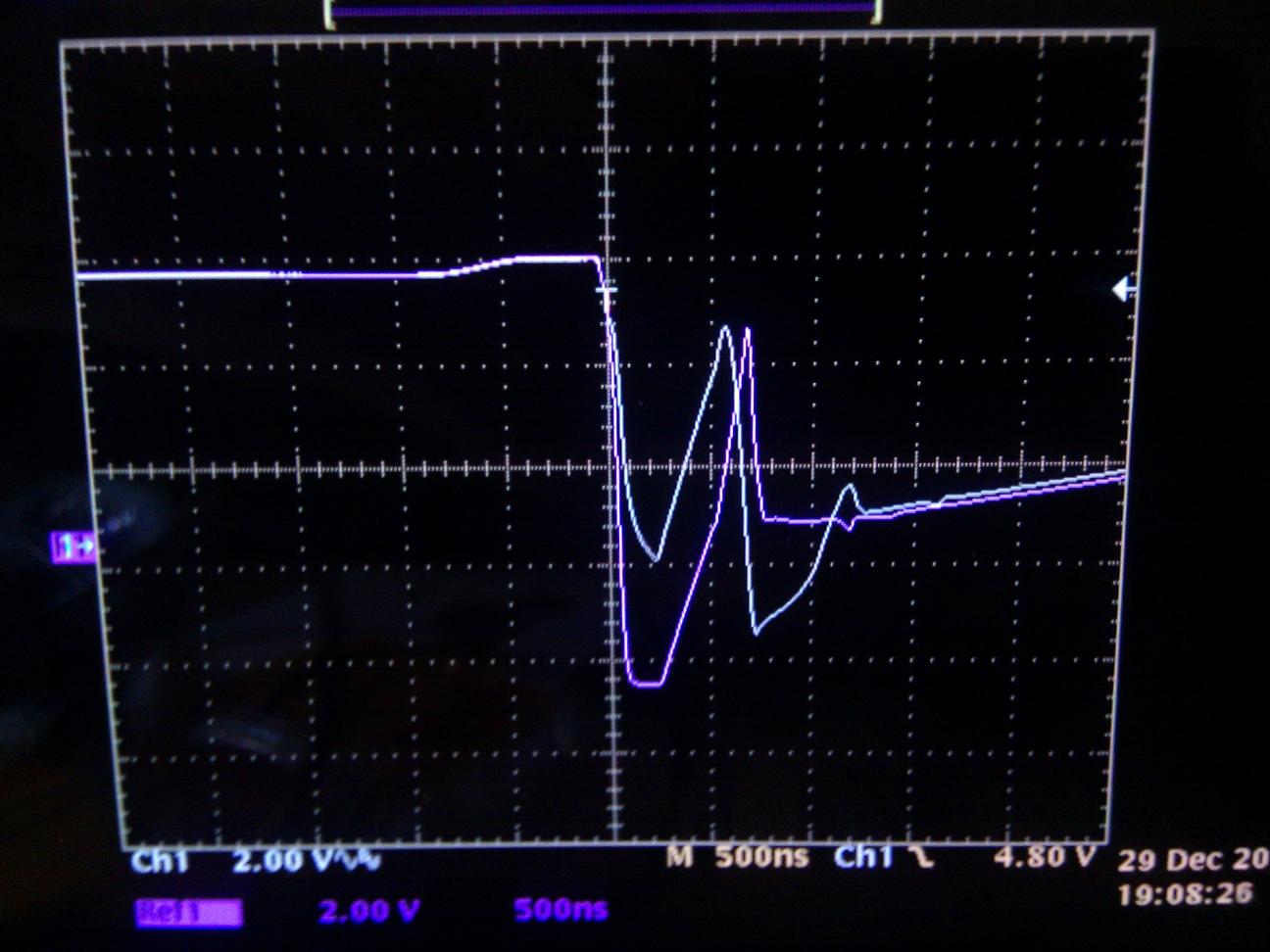

              Now see below the waveform response for my trusty dollar coin centred in the coil.
              The purple reference trace is NO TARGET
              The white trace is TARGET.
              Over two volts of response !!!! ( amp gain is 100 )
              This response is rock solid and repeatable. I can move the coil and the response changes then restores when moved same position again. There is no jitter on the waveform ... it is rock solid with respect of the timing of the tx pulse / flyback. So presumably a detector will only have to listen in this small window. Of course I have not tested for ground effect etc etc however this result is amazing !!
              moodz
                Possible Explanation ....
                The inputs to the differential amplifier are fed off either side of the differential coil which will + and - with respect to the centre tap analogue ground.
                To investigate this I disconnected the negative input to the amp and connected it analogue ground. The amplifier was now only amplifying the signal at the + input side of the coil. I could see that the "huge" signal I am getting for the target is right at the base of the decay which is practically vertical voltage drop. The diff amp will try to amplify the difference at the inputs ... somewhat obvious. If the decay on one input is slight slower than the other there will be a relatively huge voltage differential this is what is being amplified ... a slight difference in the + and - decays caused by the target.
                How is this .... ??? ..... the collapsing magnetic field of the TX coil will cause an equal and opposite flyback in the two sides of the diff coil. However the collapsing magnetic field of a target will be opposed to the main field ... so it will induce a very small decrease of field in the one coil and a very small increase in field in the other coil thus producing an ever so slightly different rate of decay in the coils and a shift in balance which the diff amp detects.
                Because the waveforms at each input are falling at a huge dV/dt at this measure point it only takes a few nano seconds of shift to generate 10s of mv of difference between the two diff signals thus relatively small targets produce relatively huge ouputs. By varying the damping resistor in the way I had it connected I was effectively balancing the two coils which even a small coin would unbalance to produce a target response. If the two coils are each damped independantly the decays of each side may be balanced by varying one side to produce a balanced condition. This is what I inadvertantly achieved with my variable damper which had an offset resistance.
                The required circuitry now is a slow autobalance which keeps the two sides balanced whilst still allowing relatively fast target "unbalance" to occur.
                moodz.

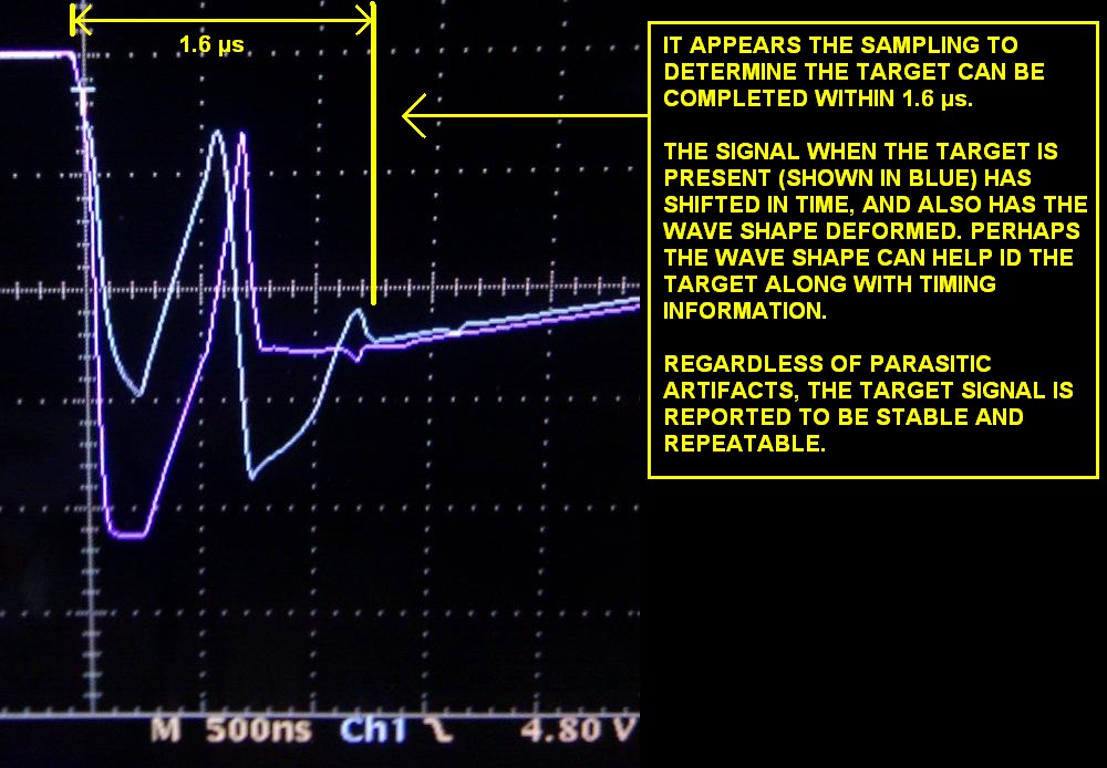

                      Things are getting more interesting. It appears the coil voltage flattens out shortly after 10 us has elapsed.
                      10 us is the magic number coil builders shoot for to start their target sampling. If you start sampling sooner than 10 us, you may be able to detect nearly invisible gold particles. Very early sampling can also cause problems with beach hunting where you begin to pick up salt water and wet sand. But we hear reports of some coil builders making very fast coils that allow them to start sampling at times approaching 6 us, which allows detection of very small gold nuggets that would otherwise not be detected (presumably they are not detecting tiny gold around salt water). These reports are from builders of analog PI detectors. The same principles will apply to digital sampling, But with digital sampling, we have an opportunity to look deeper than an analog circuit can efficiently.
                      And now We see in the recent differential coil oscilloscope photos -- the coil signal has flattened after 10 us.
                      But we also see that the target signal is clear and stable, and can be easily recognized before 1 us has passed!
                      This seems to be especially easy to recognize when using digital sampling. Of course, I would prefer to see a sharp square wave without oscillations and inductive artifacts, but even with this noise, the target signal comes through before 1 us as a voltage differential and a time differential. We also see the wave shape has changed. Best of all, the target signal is stable. It looks like we hit pay dirt.

                        Are you sure?
                        It appears from the oscilloscope photos that the coil voltage takes at least a minimum of 22us to decay, and in some cases up to 25us. The decay time is measured from the moment the mosfet is switched off until the start of the main sample pulse.
                          It seems to me that marked time distance on your picture is 1.25us not 1.6us?
                          And thanks for kind explanations, sometimes I am confused in technical English terms.
                            Yes, WM6,
                            you are correct - it is 1.25 us. That was my error.
