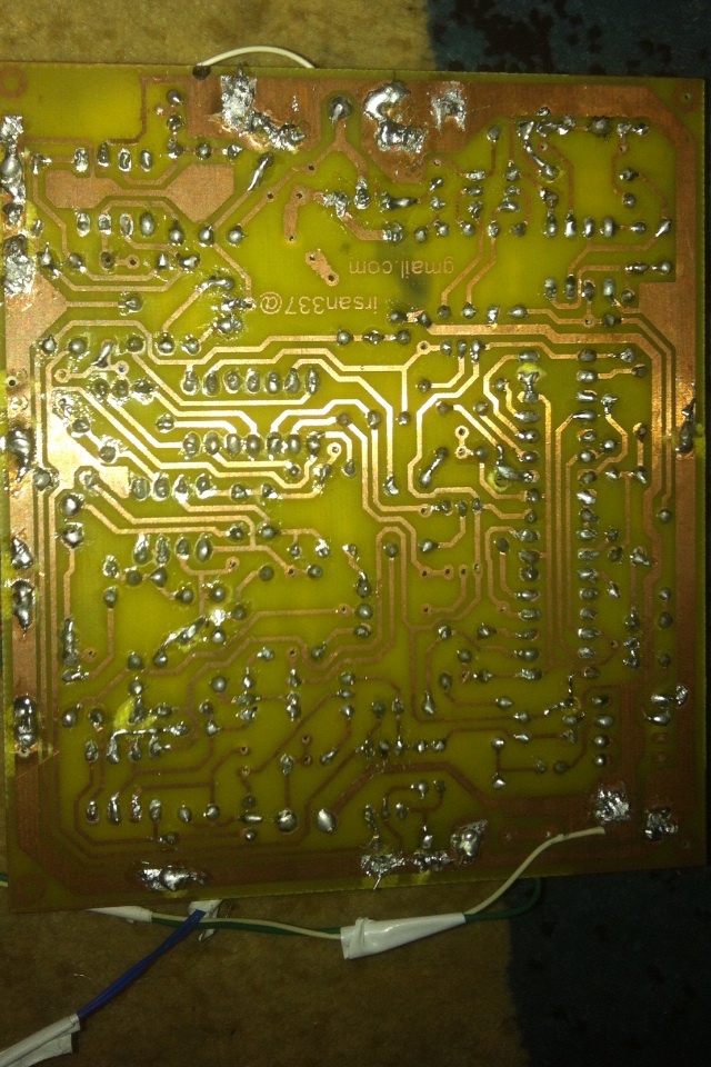

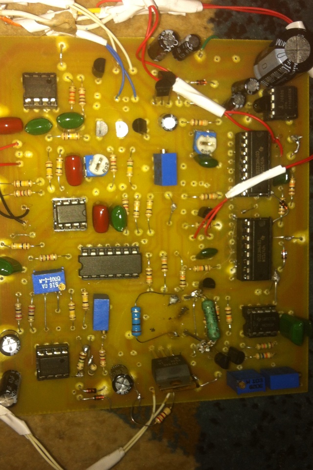

              i send to carl some pic of my pcb and
              i want to put some pic here but i dont know how
              Thank you so much

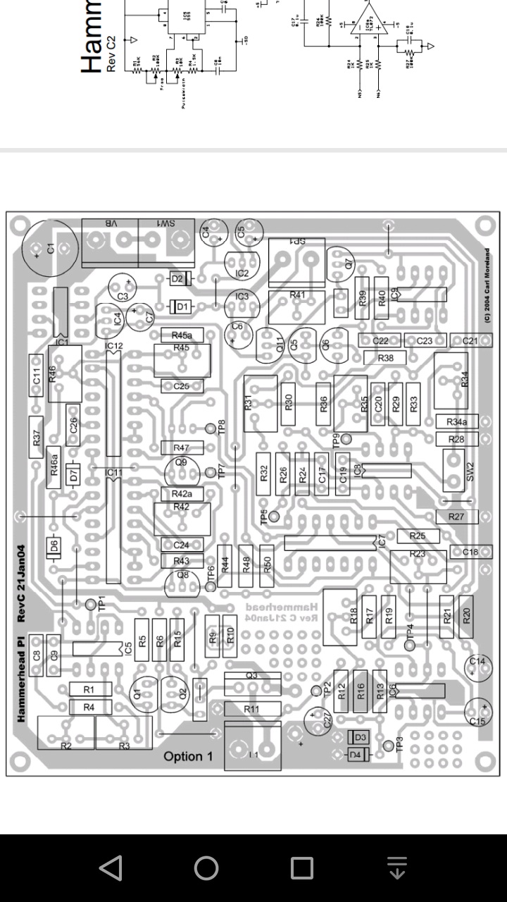

                    I use this pcb

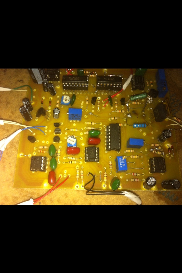

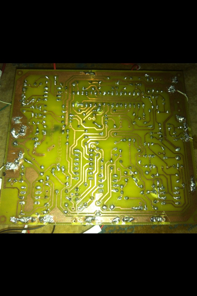

ID:	350154Click image for larger version
                      This new pic i take it now
                        You will need to find an oscilloscope. Not much you can do without one.
