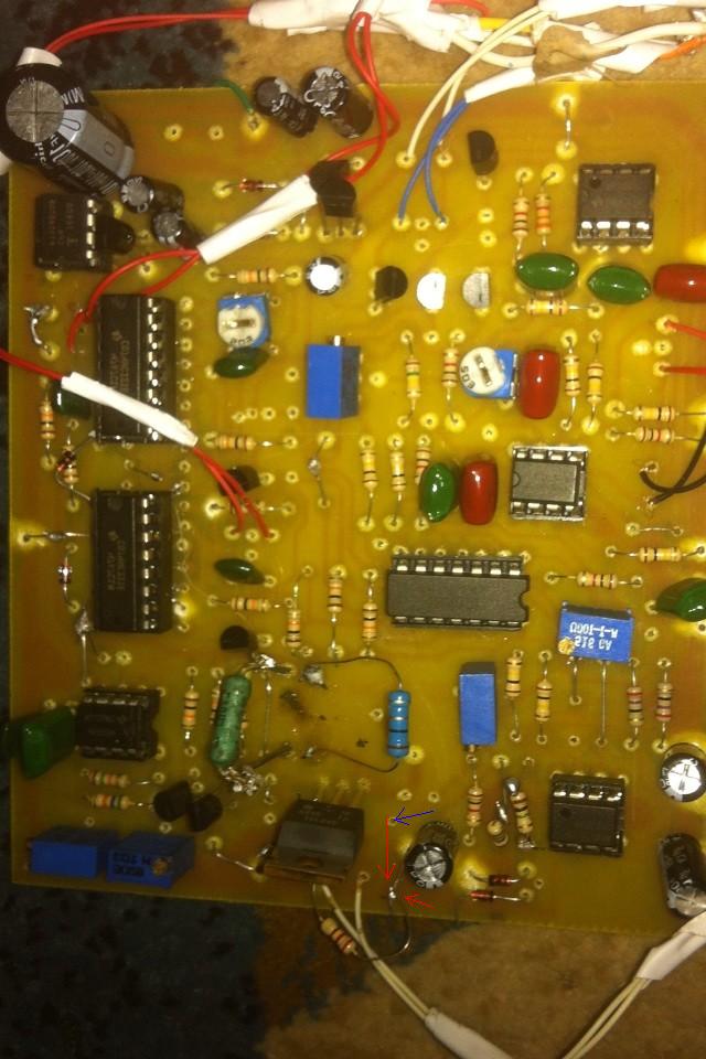

Pleas help me in my hammer head opt1
    I find this Owon SDS6062E 60Mhz 500MS/s Digital Storage Oscilloscope 2+1 external channel w/ "8 LCD
    is that work i ll have it soon
    and i ll try to use the laptop app first
    am so glad for all of you my friends thank you ....
    i ll post the oscilloscope reader info here
      Hi there, please check your pcb here and say how you connected this resistor, it looks wrong to me.
        If this is R11, Damping resistor, then I think it looks connected wrong on your pcb, please check.
