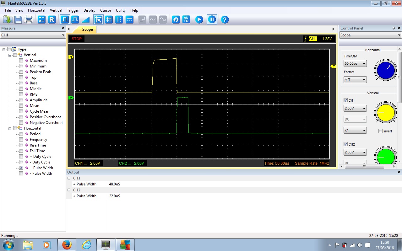

      step6 i have set the sample delay to 22us

          and main sample pulse width is 48us

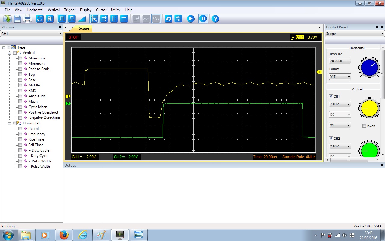

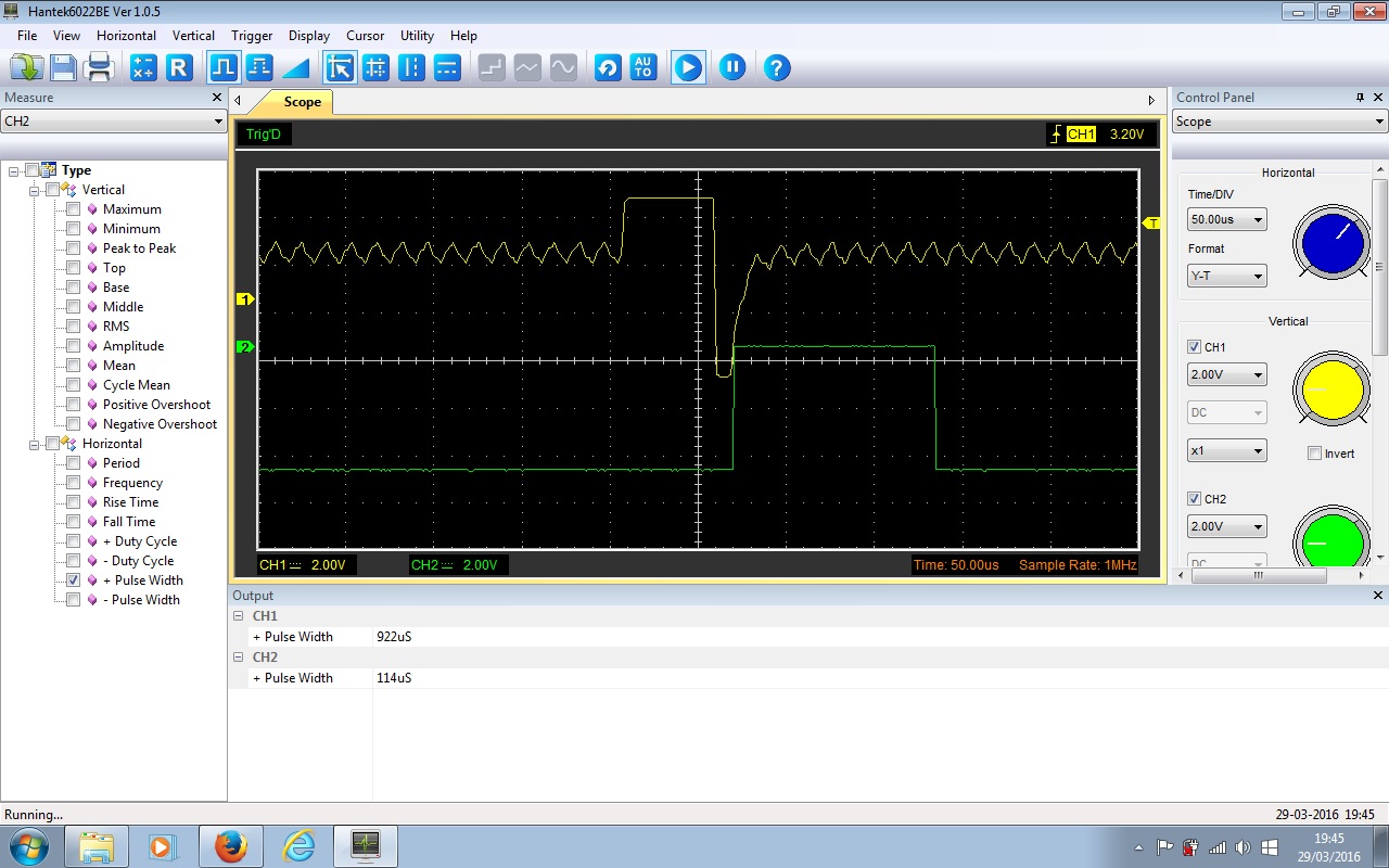

              Hey guys i have taken a trace from tp3 and tp6,
              here Click image for larger version
Name:	Ch1 TP3 Ch2 TP6.jpg
              i can see that the coil i am using is underdamped (i think please tell me if im wrong) from the 'ringing' before and after the pulse on ch1, i have a spare 100k 22 turn pot i can use to get the coil damped correctly i am going to put it in parallel with R1 how do i know that the coil is 'critically' damped? once the ringing is brought to a minimum? eg use the scope on TP3 and Time/div the same but lower the Vertical voltage so i get a better 'zoomed' view of the 'ringing' eg 500mv.
              Am i making sence?

                  My guess. It's not damping. Try changing sample rate to see if you are aliasing on a higher frequency. See if oscillation stays at 70kHz.

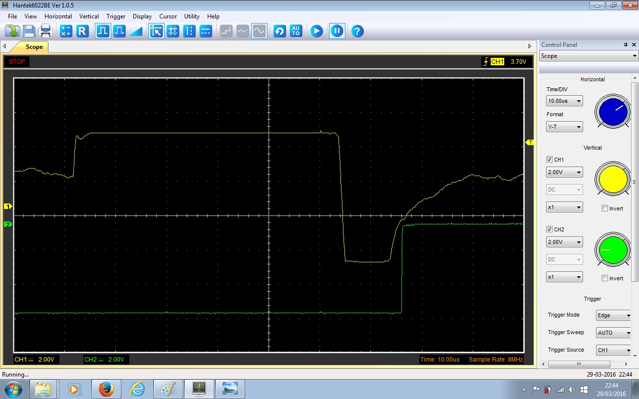

                      Does the sample rate change if you change the time/div?
                        yes it does but then most if not all of the sample is off screen, i can try the same test points with different time/div?
                          It's oscillating all the time so just change the time/div so you still see the oscillation with a different sample rate and see if the oscillation is still 70kHz.

Name:	Ch1 TP3 Ch2 TP6 20us 4mhz.jpg
Name:	Ch1 TP3 Ch2 TP6 10us 8mhz.jpg

                              That's not under damping of the coil. It's external noise pickup. Look at the scope while rotating the coil between vertical and horizontal. You should see the amplitude of the "ringing" change.
                                ok i have tried this and it seems my laptop is the cause! the further the board gets from my laptop the less the erroneous signal presents it self i can only move so far but if get about half a meter away then the signal is nearly gone
