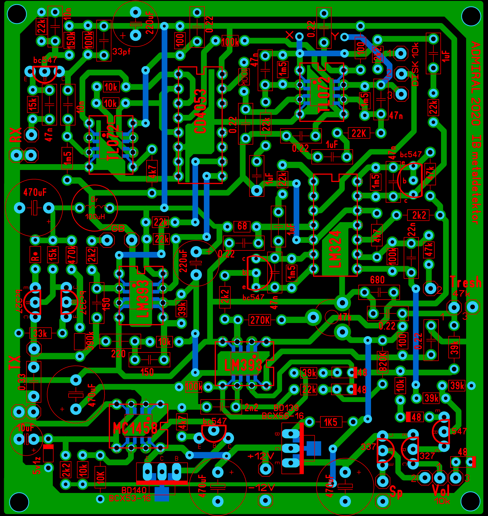

                    • Guys, i build this Admiral with two tones, not working and there is a missing part in the PCB as i highlighted in yellow question mark, 47K resistor pin not connected ??? Any sugesstions ?
                      [IMG][/IMG]
                      • Admiral with two tones not working, because there is a missing part in PCB
                        Hey fellas,
                        Sorry my English is not good enough, well i built the first admiral version and it works great in Air, i didn t tested yet in field but is seems work properly, and i decided to build the Admiral 3 as they called, (With two tones), not working how:
                        Audio working great (Pot)
                        Threshold aslo working, when i try to adjust the pot in 1/3 turn it continues making continues sound, i think it is working but without sense at all
                        Disk and the GEB i dont know because there is no sensivity at all obviously
                        Where is the problem mmm, this is way i ask you guys for help
                        I check 6 times the PCB but no luck, mey be if i have the Schematic it will help a lot for maybe a missing part as i highlited with yellow color in PCB exactly in 47K resistor.
                        [IMG][/IMG]
                          • Thank you nikko10 for help finaly it works and insane sensibility but only on metal ferros, no sense on the other metal at all, i solder all the highlited white correction in the PCB you offered even the TL072 on top left. Now i am confused
                            • With the "Discrim" knob, you need to cut out black metal so that it cannot be heard in monotone mode, then switch to two-tone and a second tone appears.
                              • I tried it but no chance at all, there is no cut out black metal in monotone, this is why makes me so confused ... ? !!!
