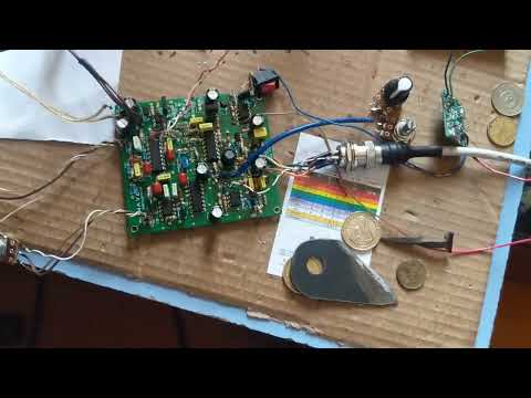

    • I did two tones Admiral by nikko10 but I don't like how it works. When I switch two tones mode I have to return the thresh-a and I lose depth
      My question to nikko10 is this normal? or I made a mistake somewhere? Thanks

        • Here is how 2 tones variant should work.

          • Thanks getsa , can you share the scheme it seems that it is not the same as nikko10. Greetings
            • https://youtube.com/shorts/F_MM4Gz7epk?feature=share
              • Excellent results
                CEBRAIL congratulations I was impressed with the detection distance. have you tested it in the field?
                • yes i have underground tests very good depth

                    • Originally posted by CEBRAIL View Post
                      tx 10.35 volt rx 47milivolt 8.5khz
                      How did you rich 10 volts or without coil connected?
                      Another question when using oscilloscope to balance rx
                      Where can I attache the probe ? After or before connecting rx coil?
                      Thank you.

                        • Originally posted by bonchev2 View Post
                          thanks for your help getsa Can you tell me what is the normal depth of the device? For example a 1 euro coin.To know the capabilities of the device. now catches them at 25-28 cm. Thanks again
                          Hi
                          25-28 in the air or in the ground?

                            • Hello
                              25-28cm air test but if you set it up well you can hear it in the ground on that depth
                              I posted video on page 9 air test with my Admiral
