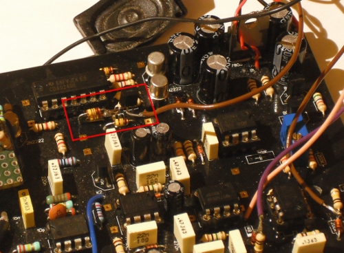

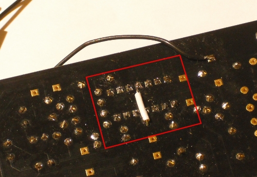

        Two videos of my MD.
        The first one shows the detector working in "standard" mode : All metal followed by Disc mode.
        The second one shows how the audio mod works : lower sound for ferrous, higher sound for non-ferrous.
        I've done a small change from my last post : Pins 5 & 9 (CD4024) are always connected to Audio and the FET drives the pins 7 & 12.

          Seems to work very nicely -- is there a region where certain metals make no beep at all?
          If you can separate the tones more it would be easier to hear the difference.
          Great idea and execution to make an improvement with very minimal changes.
          Thanks!
          -SB
            Nice thing!
            It works smooth!
            That idea can be exploited more.
              @Simonbaker :
              Until you switch in Audio disc mode, the MD works like any other TGSL.
              When you are in Audio disc mode, every metals give a sound.
              In fact, the "basic" tone is done by the two diodes always connected to the CD4024 (Pins 5 & 9). A soon as the comparator LM393 detects a non-ferrous metal, it drives the FET and connects two more diodes between the CD4024 and the audio stage given a higher pitch.
              Every metal target is given at least a low freq. sound.
              I agree, the difference between low and high tones is small.
              Because of the basic design of the sound generator, it's difficult to give a higher tone by adding the CD4024 outputs.
              I'll try to use both a P channel FET together with a N channel FET to cut the low frequencies and add the high ones.
              Any idea is welcome !
              Note : The difference between low and high tones is more audible in real.

                  I've done what I've said in my previous post ... and it works !
                  Re-use the second half of U107 to drive the audio and re-route the outputs of U106 to select the audio tone.
                  Voila !
