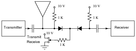

                        ..that patent is a variation of the the diode TR switch ... used from DC to daylight in many many circuits ....
                        The coil flyback switches the diodes off. Its well known in the art.
