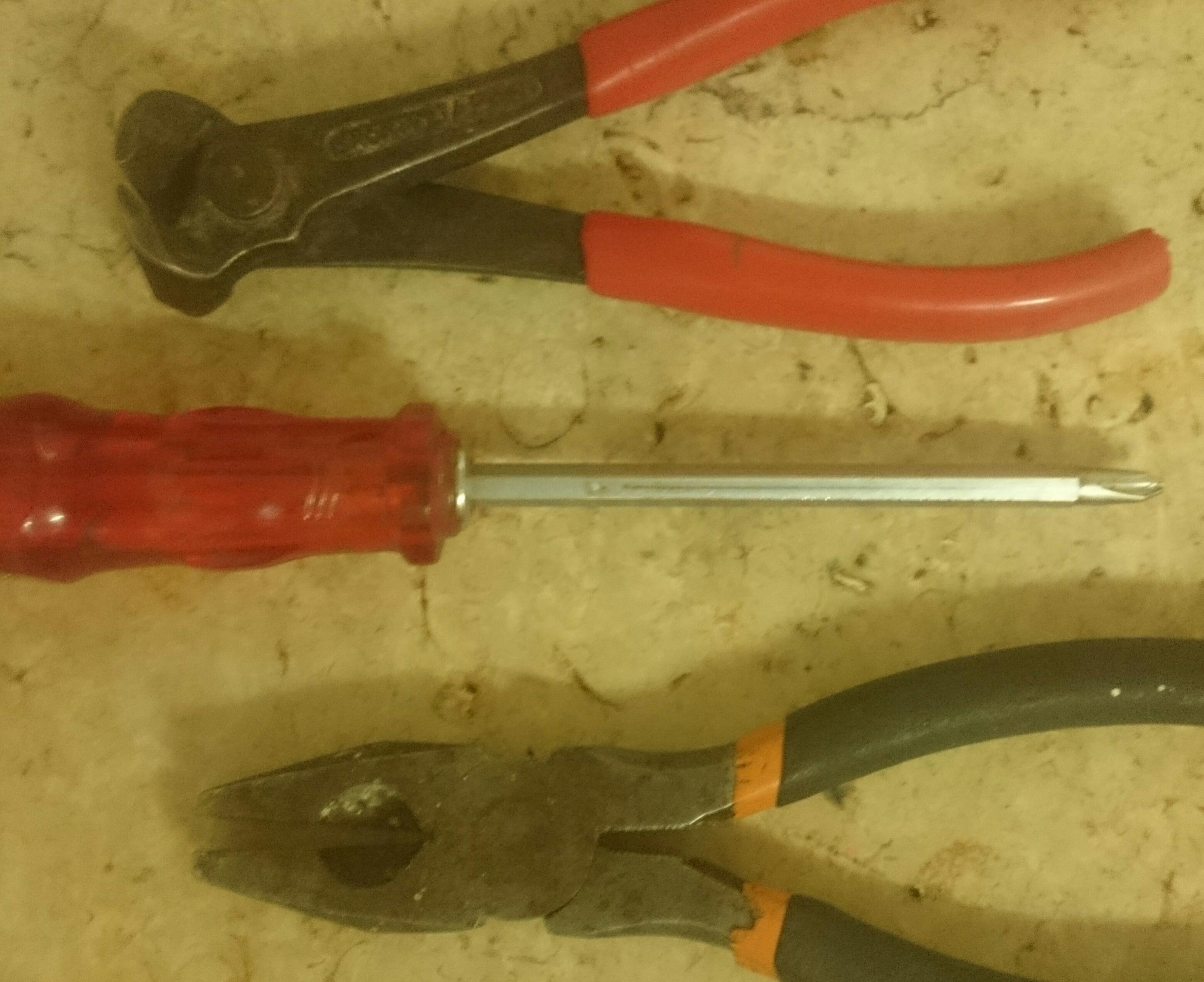

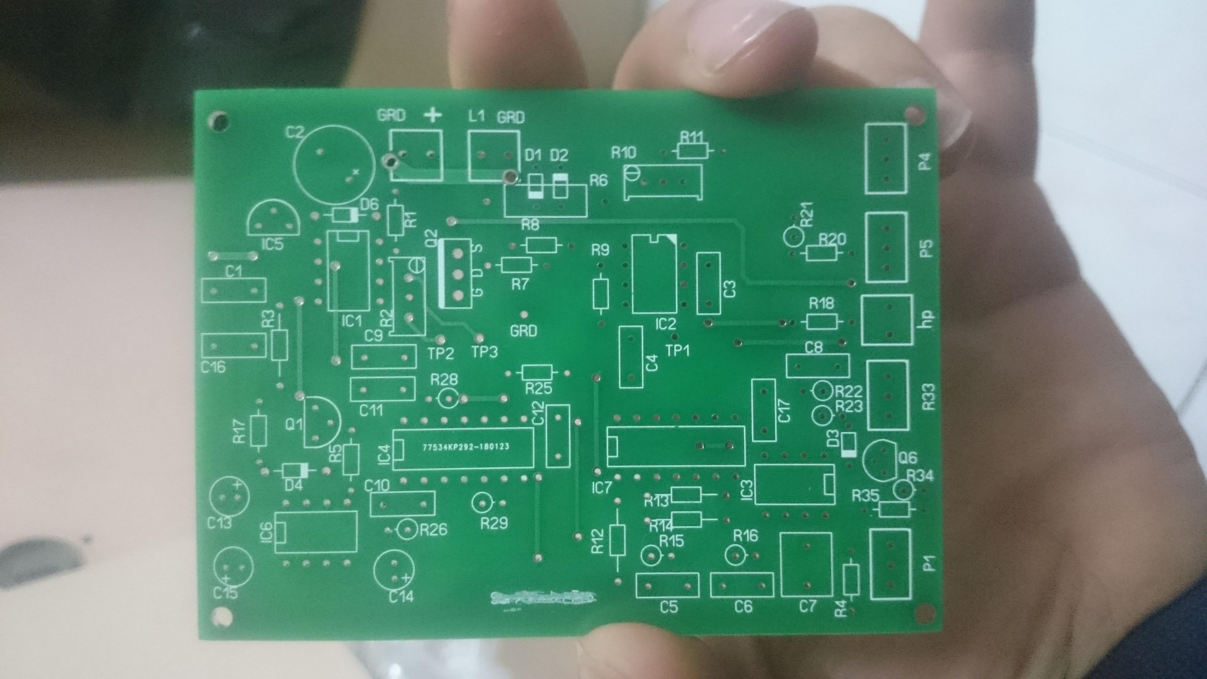

        I use iron wire clipper and this my board

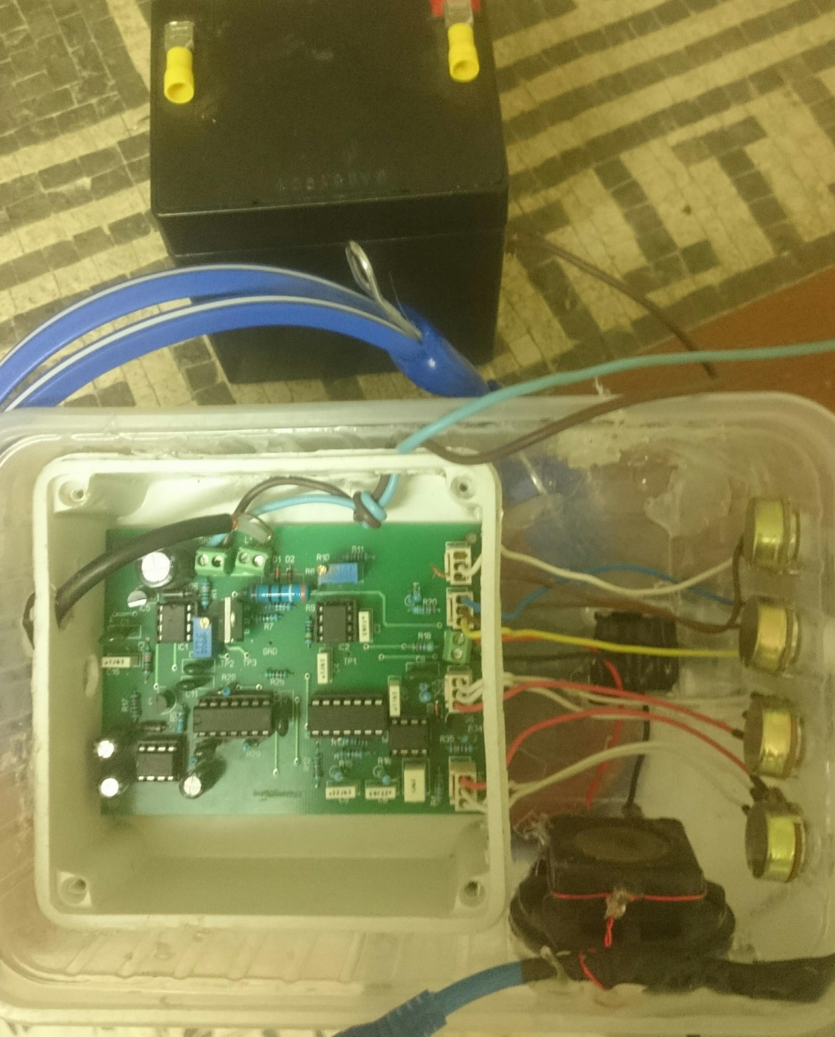

        I attached my board and iron material

          Iron material

              What are the specs on your coil? I made that same kit and mine wouldn't work for crap with my first coil. wound a second coil, just a bunched wire coil right at about 300uh. Set my damping with the new coil and that woke everything up. You are going to need a scope to set up your surf correctly. You can get it usable without a scope, but it will not be as sensitive. Sorry about kt, he only likes to tell people they are wrong and he is right. People used to say he has good intentions and it gets lost in translation, but from what I've seen that's bull.

                  My coil 13cm with 100turns wire size 0.6 with insulation
                    Hach, at first I thought you bought a White's Surfmaster PI Pro on eBay, but I see it's a PCB you then built. When things go right, this is an easy circuit to build. When things go wrong, an oscope is just about necessary to figure it out.
                    My questions were based on the possibility that the transmitter is either not working, or just barely working. A big piece of iron can produce a response whereas a coin or ring won't. If the transmitter is working, the damping resistor should be warm. Probably the FET, too.
                    If the transmitter "feels" like it's working, then the next likely culprit is the RX timing. That's where an oscope is essential.

                      Try something like 26 turns. I think 100 turns would cause the first sample to be pegged to one of the power supply rails, this would explain the iron only response with only the second (late) sample working
                          Ah yes, I missed the 100 turns. Way too high.
                            Yes, way too high!
                            The inductance works out as 2.83mH.
