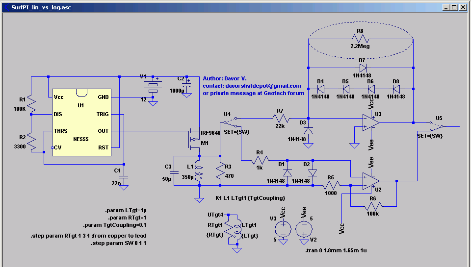

    It seem only appropriate to continue here where we left some time ago. Now this is big. I present you a LTspice simulation of a logarithmic weighted PI Rx with dead time of less than 2 microseconds. Furthermore, its output is logarithmically compressed so there will be much fewer bits required for ADC, where required.
    There are some additional repercussions of this approach that enable some very interesting solutions to discrimination (say, you may play with C3 and observe consequences), but finally it is THE weighted solution I was mumbling incoherently for the past few months. Also, it is an inverting solution and thus the signal decays opposite to the "Surf" solution.
    On the schematic you'll find two switches that are used to divert signal to a common node, and prevent two Rx-es to interfere with each other, and to draw output in nice colours. The opamp with a bunch of diodes is a log detector: nothing fancy, but works as a horse. I'm aware this is going to perform a bit differently with a real world opamp, but here you go - a place to start experimenting. This can sample very early.

      Hi Davor,
      this kind of log-amp is horrible noisy and unstable (temp drift). Nevertheless, it could still be sufficient for our purpose. Someone should try this log-amp and report the results here.
      Cheers,
      Aziz
      • I know, but with all other effects in play the temp drift is the least of my worries. Besides, dedicated multi-decade log amplifiers are incredibly expensive, and same as this one must hit the noise floor ... eventually.
        Using BJT in a feedback loop is not famous for stability so simple diodes were a logical choice. Noise is also not high on my worries list because it seem as if the most interesting part of the curve is waaaaay above 1mV of a PI decay.
        I think the most of the minor problems will be tackled with the tricks already in our toolbox, and we don't need to call them different names. EF can stand for a slowly decaying value past the log slope knee (the ski-like bend) e.g. low signal + offset + noise. That should keep it a bit more stable.
        Another possibility may be provided by mere window comparators, and a set of voltage values, hence time differences. That could do as an ADC in a way - a simple counter.
        It can work as well with bipolar pulses with only minor changes, and i wonder what it will be like with TEM pulses.

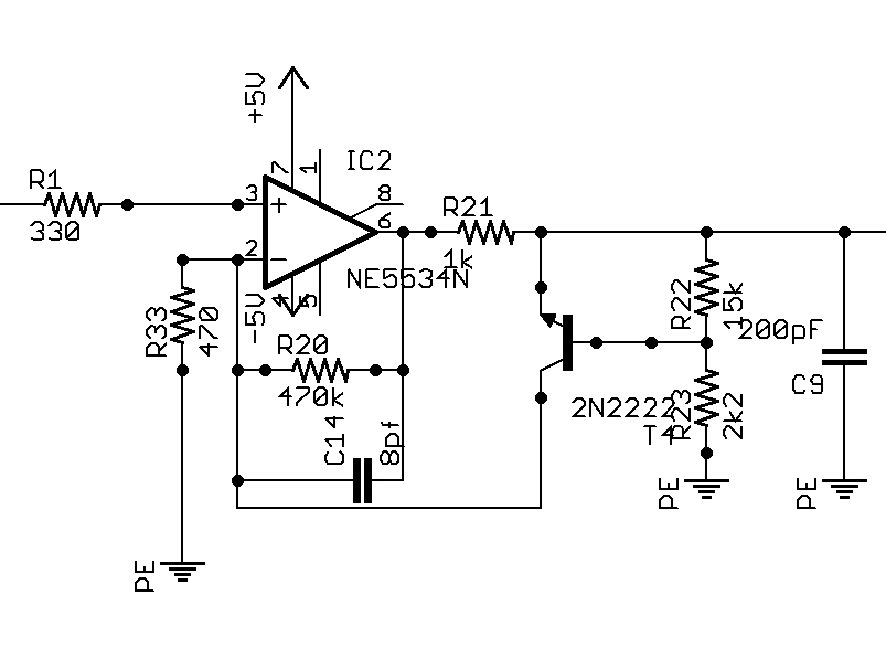

          • Years ago, I used this pre-amp. It was giving good results. However, because of latent temperature drift etc. I abandoned the design.
            The Opamp does not saturate, because of the soft clipping by the transistor feedback. The negative TX pulse that we do not need, is clipped.
            The response is somewhat logarithmic. The gain is enhanced for the low voltage here we need it.
            The higher voltage has less gain and still higher, the signal is soft clipped so that the opamp does not saturate.
            Possibly the latent problems could be solved and then it would make a good alternative.
                    Your design is noninverting one and both inputs are exposed to full signal swing and rails limitation. The solution I propose is an inverting one, and opamp via its feedback fights the full wrath of monocoil Pi voltage. OK, there is one diode to help it - just in case. But the whole point is that you can have a full PI decay exposed to analysis and decomposition. It would be funny seeing it on scope.

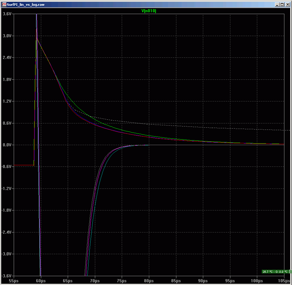

                              • There are several good points to it, and I'll try to elaborate a bit. My gut feeling says that PI demodulation can only benefit from applying some appropriate weighting function to a Rx signal that will flatten its response over time. My first thought was a ramp or a sinus. There are some good points to these. Ramp is feasible via VCA, and its family, while sinus is feasible via LC tank. Trouble with linear ramp is that it will not help much beyond, say, one decade of signal span, and it is not flattening the signal a lot. Non-linear ramp is readily available as a log-amp, and here you go. The sinus weighting was already patented and as far as I know did not fare too well, partly because the time constant of a tank was IMHO far too short. I'll get back to that solution eventually.
                                Common feature of all log amps is flat top and bottom where the log curve hits its limitations. On the bottom side there is a (mostly) linear part that is usually buried in noise .. but not necessarily so. With the design I posted previously I can decide how deep the curve follows the log law. By addition of a single resistor in the existing design in a feedback path I can assure a fixed gain for low signals, and detection as usual. 2.2Meg fixes gain to 100 which is same as the "Surf" counterpart below. I traced the response without the resistor for comparison (dotted line). There is something else apparent there: the response is not symmetrical against "Surf" response, and "Surf" response (for no apparent reason) quenches much faster.
                                I could speculate about the "Surf" result falling short, but it seem as if the 1k in series with limiting diodes in effect damps a coil a bit too much at higher signal levels, so there's not much energy left for it to do its thing. One may guess its role in noise, but I don't expect much difference with larger one because it goes to a hi-impedance non-inverting input.
                                Anyway, here is a log-lin amp with max gain of 100.
