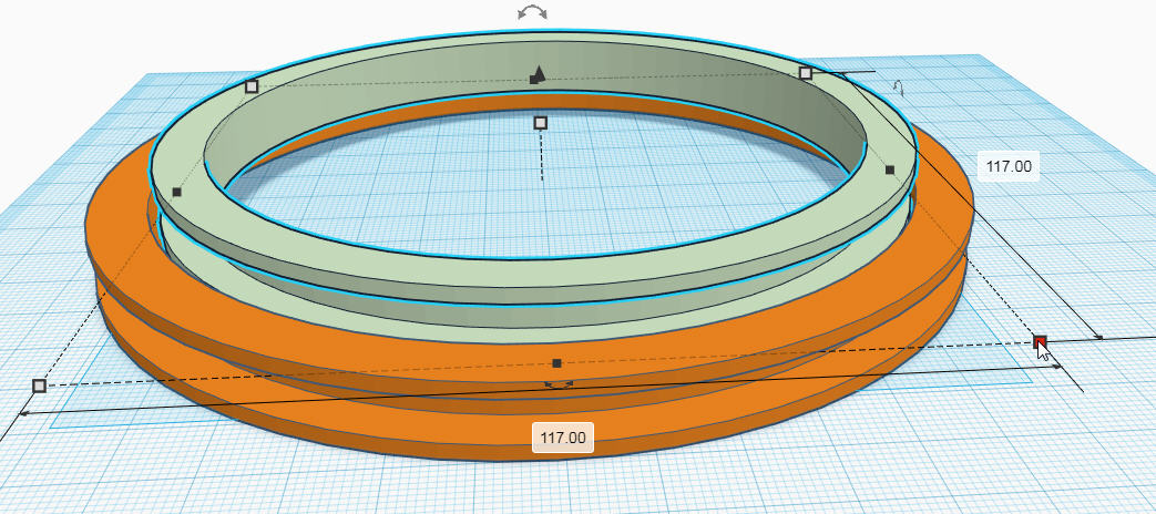

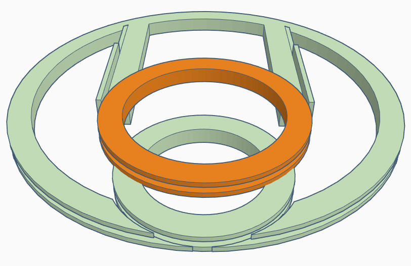

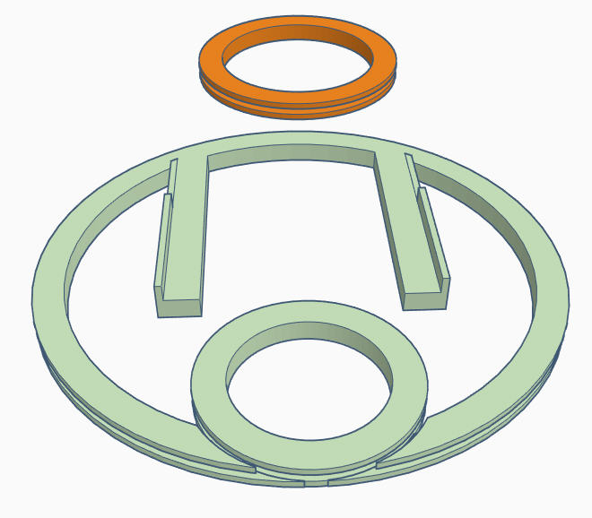

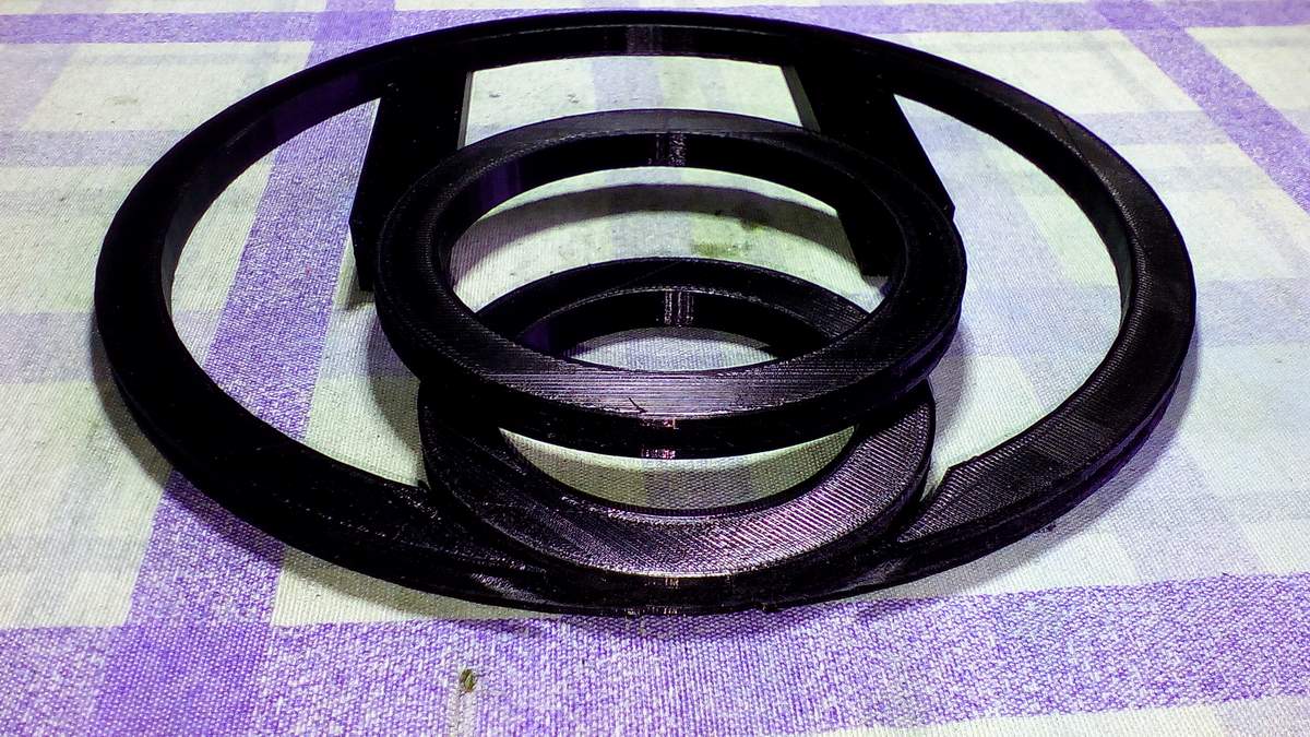

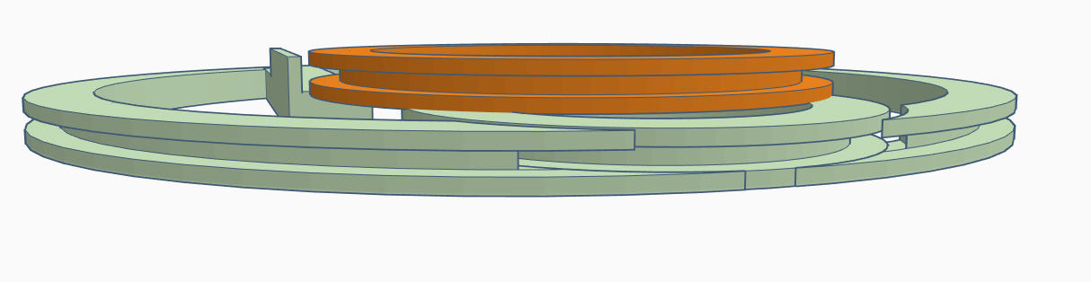

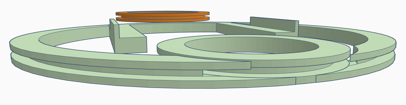

    For experimental workbench purposes; i think the easiest would be "Omega" coil.
    I draw 3D elements for it, for 3D printing. To make my life more easier while experimenting.
    For those interested:

      maybe, but my tests with an omega give very poor results. I think the cancellation on the indoor loop limits the PI mode a lot. It works, but the detection area in hybrid mode is very small. In my application on the wet sand of the ocean, it is like looking on a small stretch of beach, it is not good for me.

        Omega type coils never were deep anyway.
        What i am expecting from it is to be "comfortable" to experiment with in workshop.
        Should be good for precise detection of smallest items, should be good in discrimination.
        And yet... maybe i am just daydreaming, will see.
        In the past i used larger room upstairs as my workshop, having lot of space and comfort for these kind of works.
        Last several years situation has changed and now my workshop is 1x1 square meter, piled up with parts, tools and instruments.
        Not to mention hums and interferences.
        That's why i am forced to minimalize testing conditions, coils etc.
        No harm done, this is just an attempt.

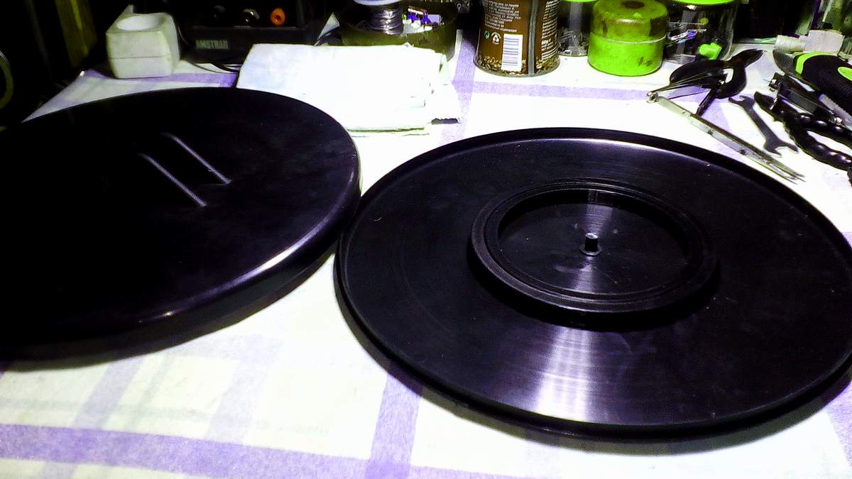

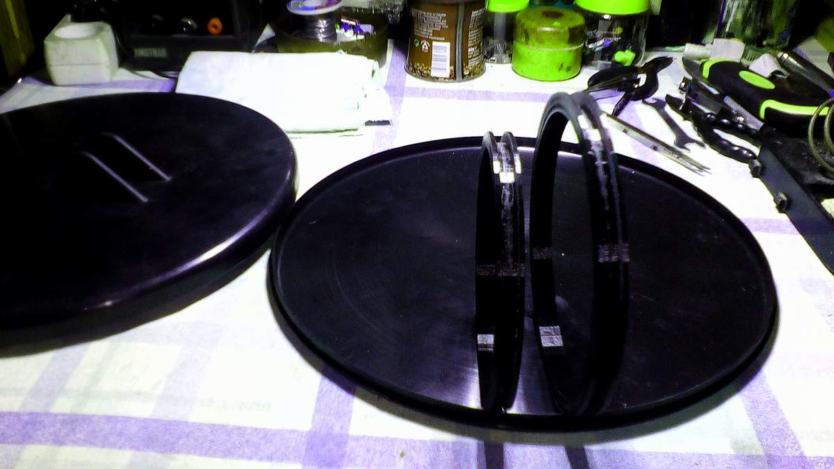

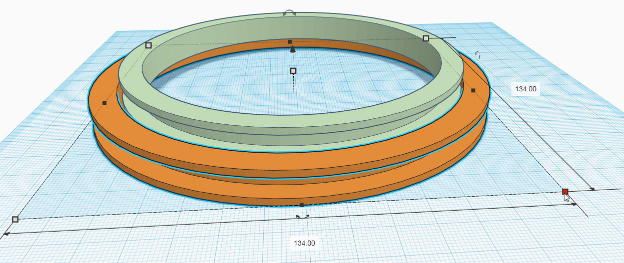

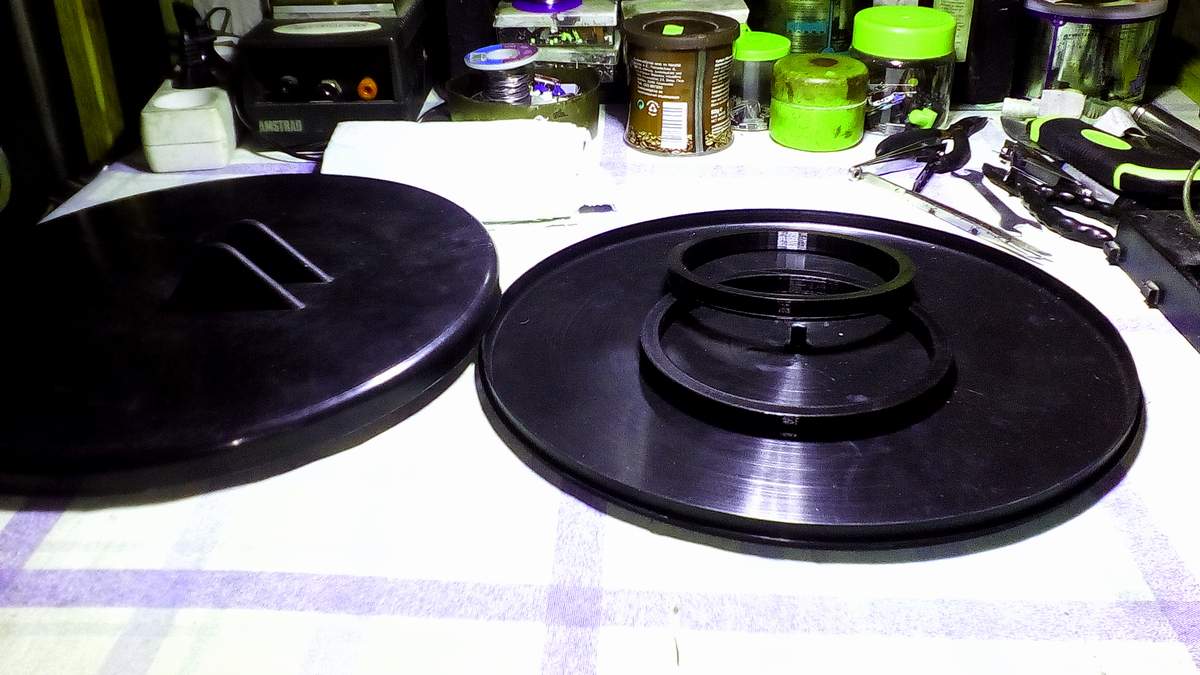

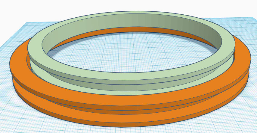

            I haven't tried such coil so far.
            Balancing seems too complicated for me.
            Even "CC" coil is too complicated to balance... in these conditions.
            Truth is; the other day i prepared former for CC coil.
            I had enclosure from before, i only 3D printed former for RX and former for bucking coil.
            Enclosure is big enough to fit 25-27cm TX coil.
            And dimensions of RX and bucking former are on the pics:

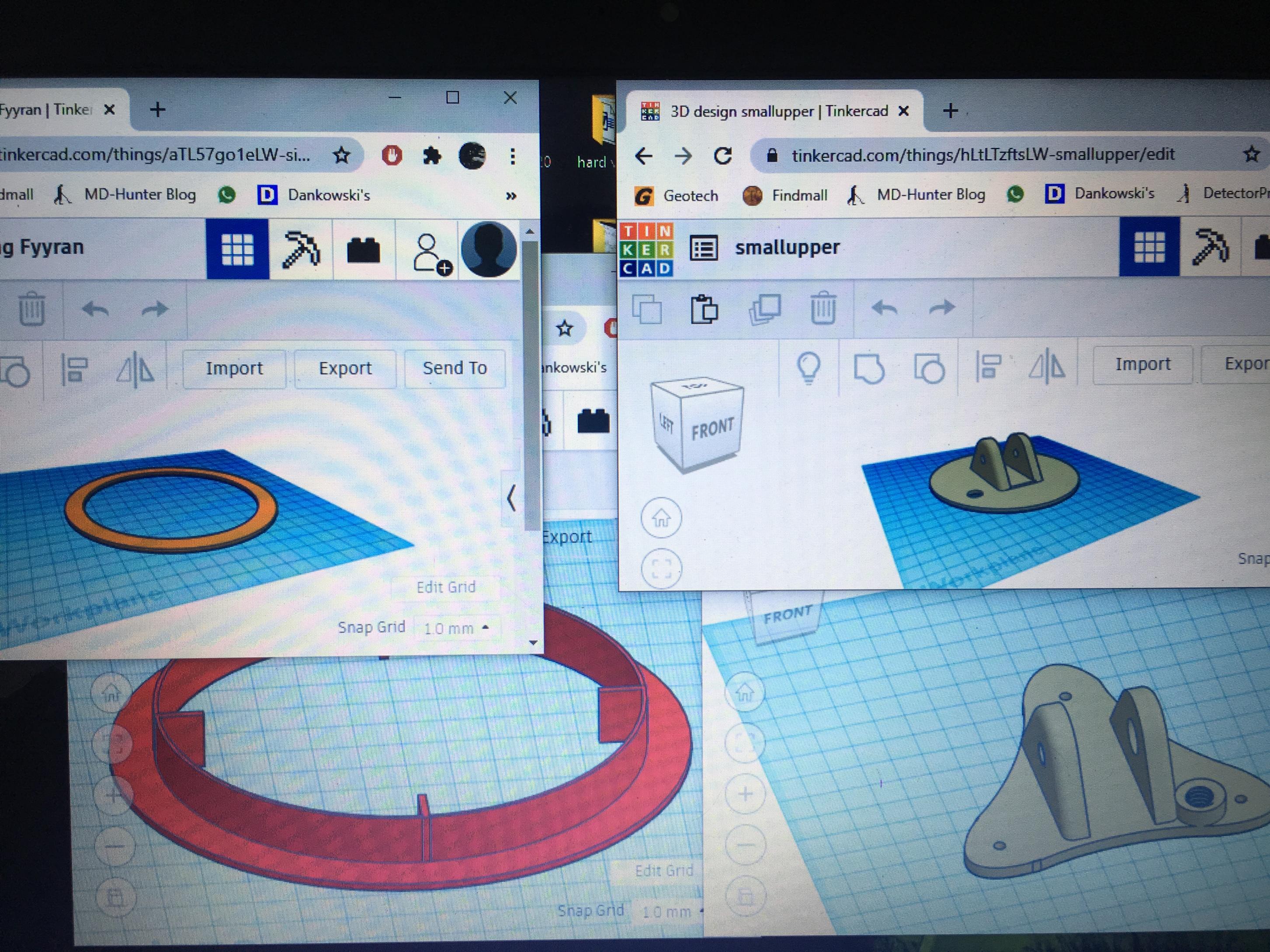

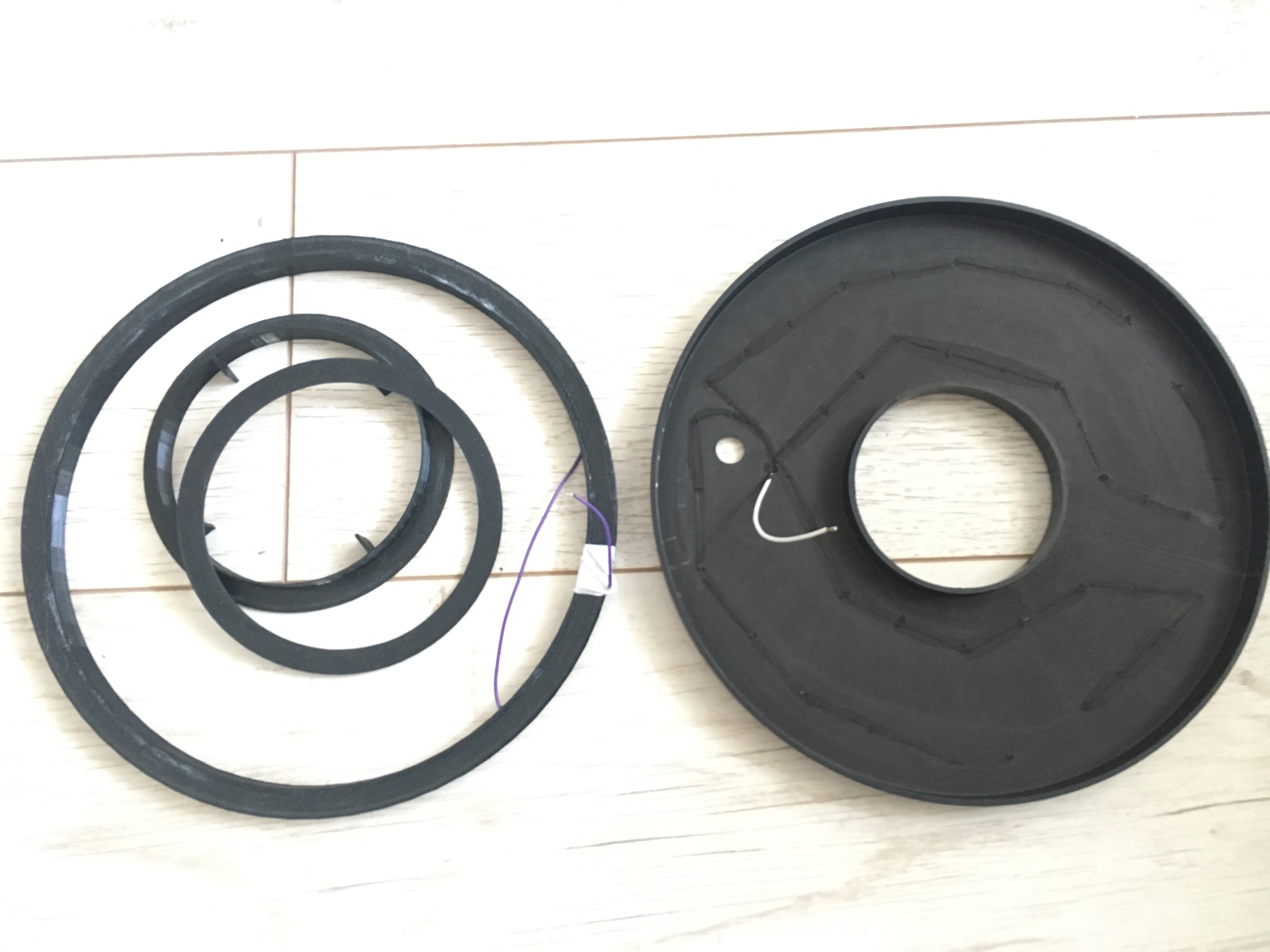

                      when i print coil former i do it from two pieces, and after i glue together with superglue. In this way i don’t need to scrap the overhang support structure, which i find annoying and the surface of the part is not smooth. Also i keep the layers thickness about 1.5mm resulting in less weight(anyway this willbe covered in epoxy). Coil housing is from BG, i did not print them yet.
                      Thank you all for your involvment.

                        Yes . 3 superimposed coils Rx- / Tx / Rx +. I made one for the test. But not had good functioning. failed to make the Rx "invisible" on the oscilloscope. If anyone here knows this method, I'm very happy if he explains how to do it, or what I've done wrong ... but for voodoo it would be a good idea.
                          when i print coil former i do it from two pieces, and after i glue together with superglue. In this way i don?t need to scrap the overhang support structure, which i find annoying and the surface of the part is not smooth. Also i keep the layers thickness about 1.5mm resulting in less weight(anyway this willbe covered in epoxy). Coil housing is from BG, i did not print them yet.

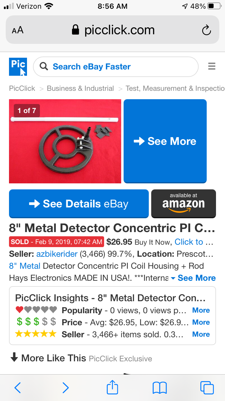

                          • Anybody know where you can find these shells this is the only one i could find and all the links don't work https://picclick.com/8-Metal-Detecto...776327553.html Click image for larger version
ID:	358997 thanks for any help
                            • Originally posted by SilverSurfer17 View Post
                              Anybody know where you can find these shells this is the only one i could find and all the links don't work https://picclick.com/8-Metal-Detecto...776327553.html [ATTACH]54257[/ATTACH] thanks for any help
                              dfbowers (member here) produces very good quality shells.
                              • The only concentric shell i could find was all closed in and one hole in the center and i wanted a open one like in the picture ill have to figure out how to hunt him down on here lol
