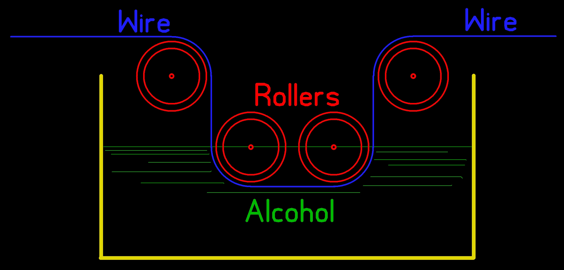

      Simple soaking bathe can be made from few rollers mounted into some vessel.
      Something like this:
