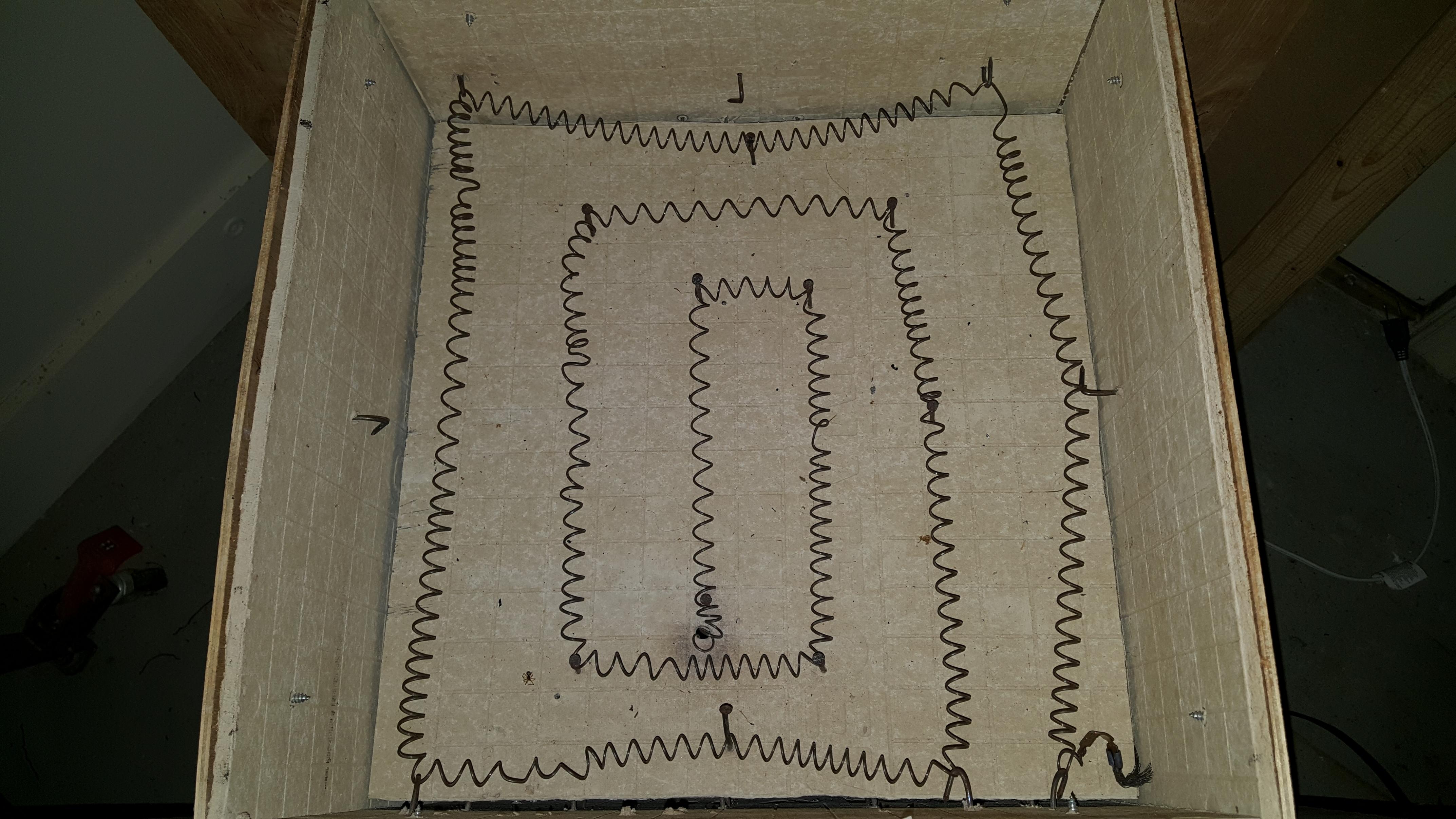

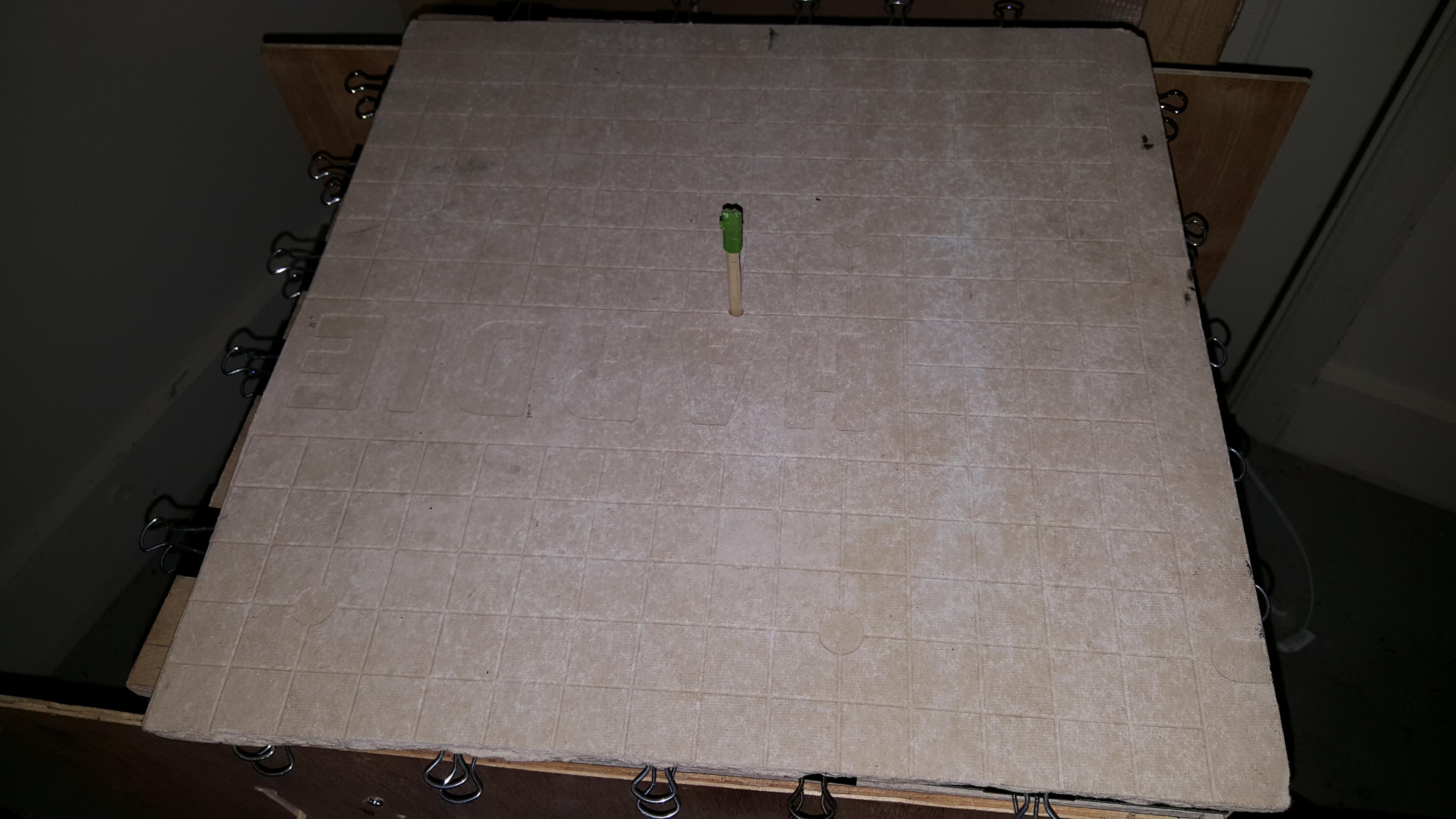

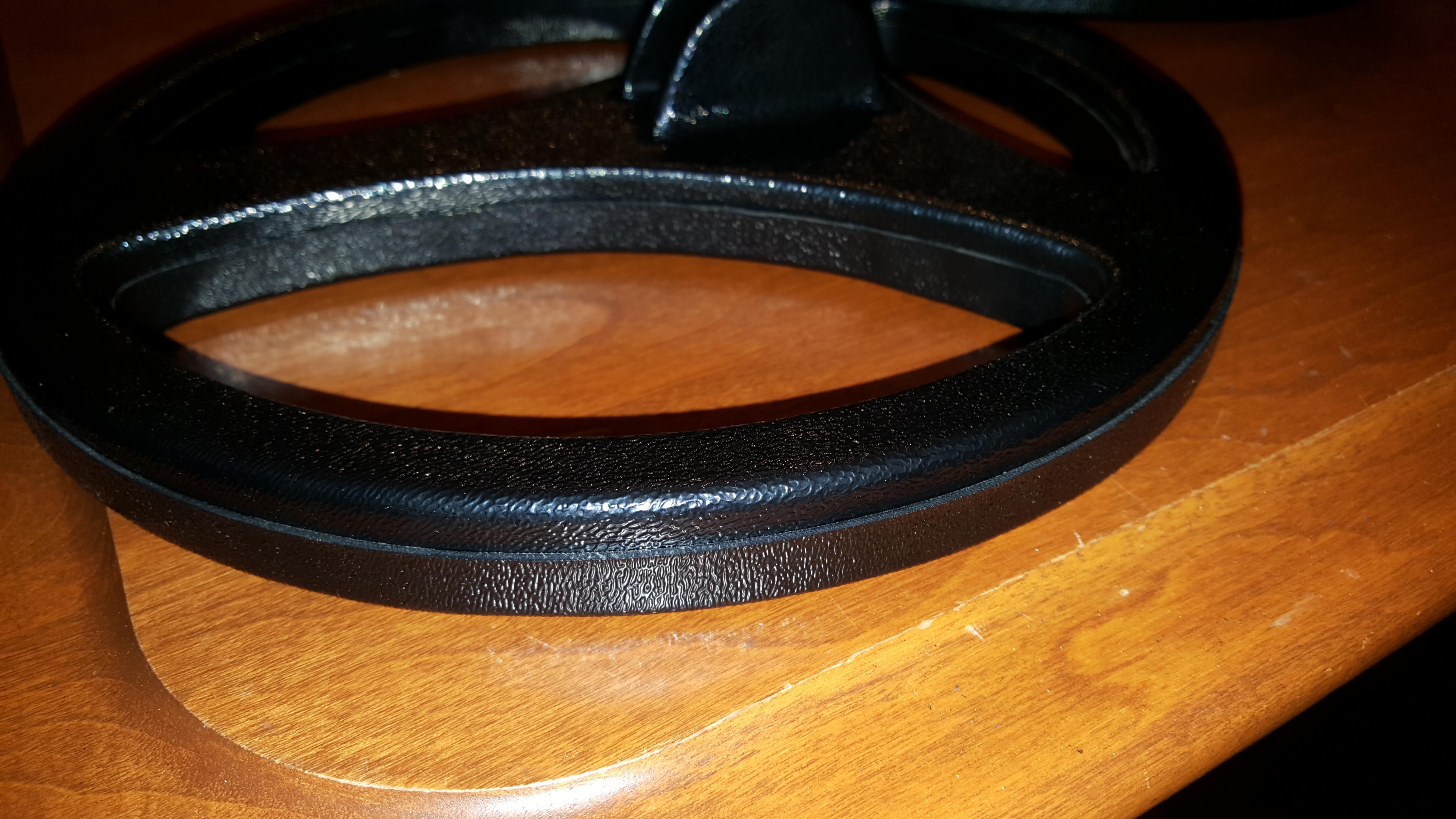

              I have large, old Magic Chef stove that I got from friend with a very large electric heater oven that I plan to use. the heater element is at the base, running longitude for even heating. The oven is wide enough(24 inches) to easily do 12 inch diameter coils.

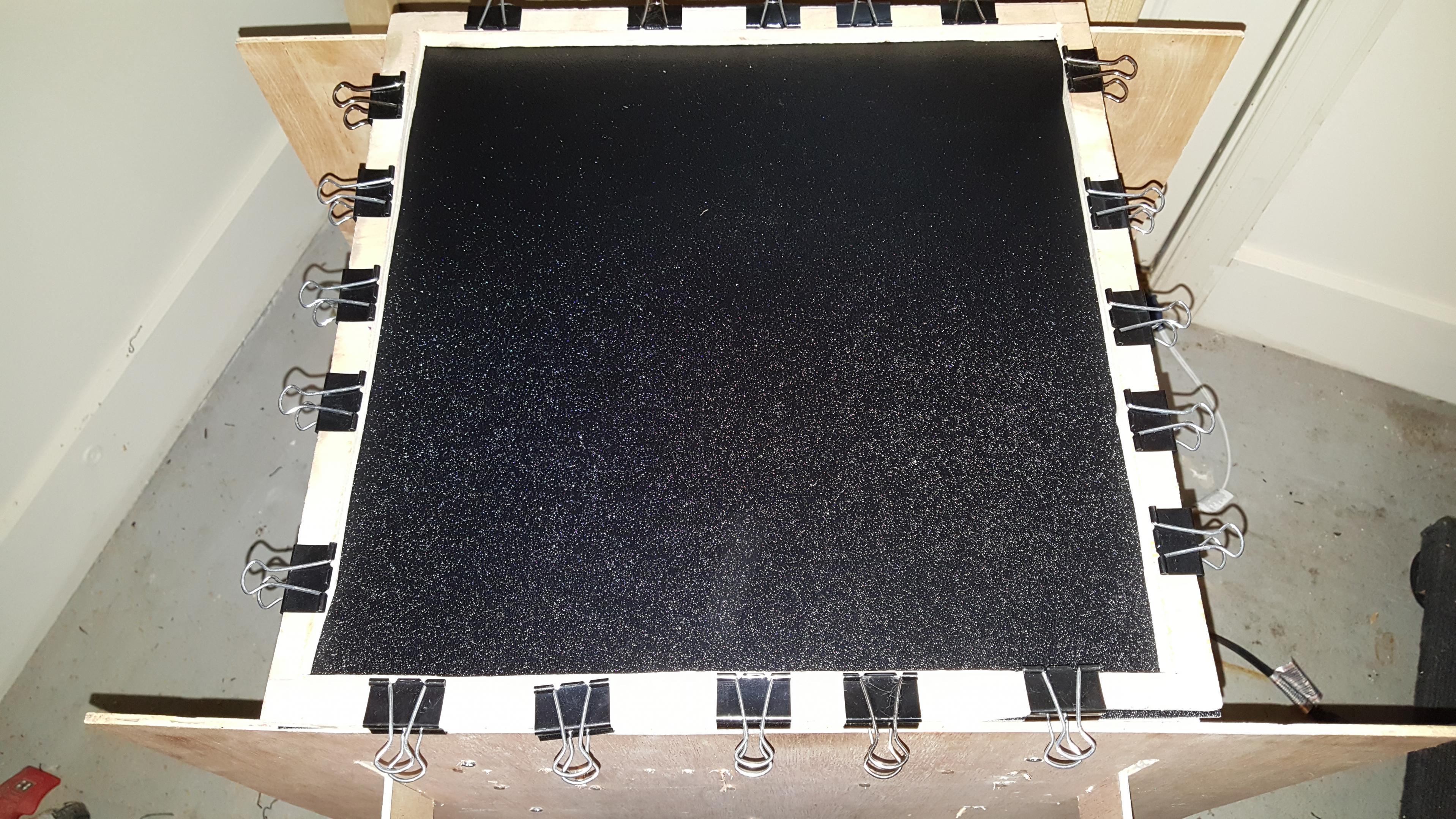

                Here is my current oven setup. I just gutted a 1500w space heater. I put my frame with ABS on top for maybe 3 minutes and its ready. I use cement backer board as a liner. It reaches maybe 250 degrees F, well below what its rated for. Ideally I should be using a refractory board but I have been doing this so long I'm not too worried any more.. just never leave unattended and I do it in the garage right next to a window fan so I'm always up wind of any fumes.
                Also, the trick to consistency is measuring the sag of the ABS accurately! I Rarely throw anything away.. When my flag drops about 2" I know it's ready for the vacuum table.
                  That's great Don. A picture really is worth a thousand words!
                    hello Don, how did you connect the heating wire?
                    did you take the Regulator from room heater ?
                      Hello. I could have reused the thermostat (which would be the correct thing to do) from the space heater but in this case I just run it wide open. Oddly enough the concrete backer board has a lot to do with the even heating of the plastic.
                      I leave the oven on for maybe 10 minutes with a cover on until the backer board reaches about 250 degrees F before use. I originally tried a foil lined oven which produced really bad results and hotspots on the plastic.
                      I don't have much of a problem with overheating with only 1500W. I may crack the lid a little to let the oven cool down if I think it's getting too warm but generally I can do 7 or 8 shells in a row without the temp getting out of hand.
