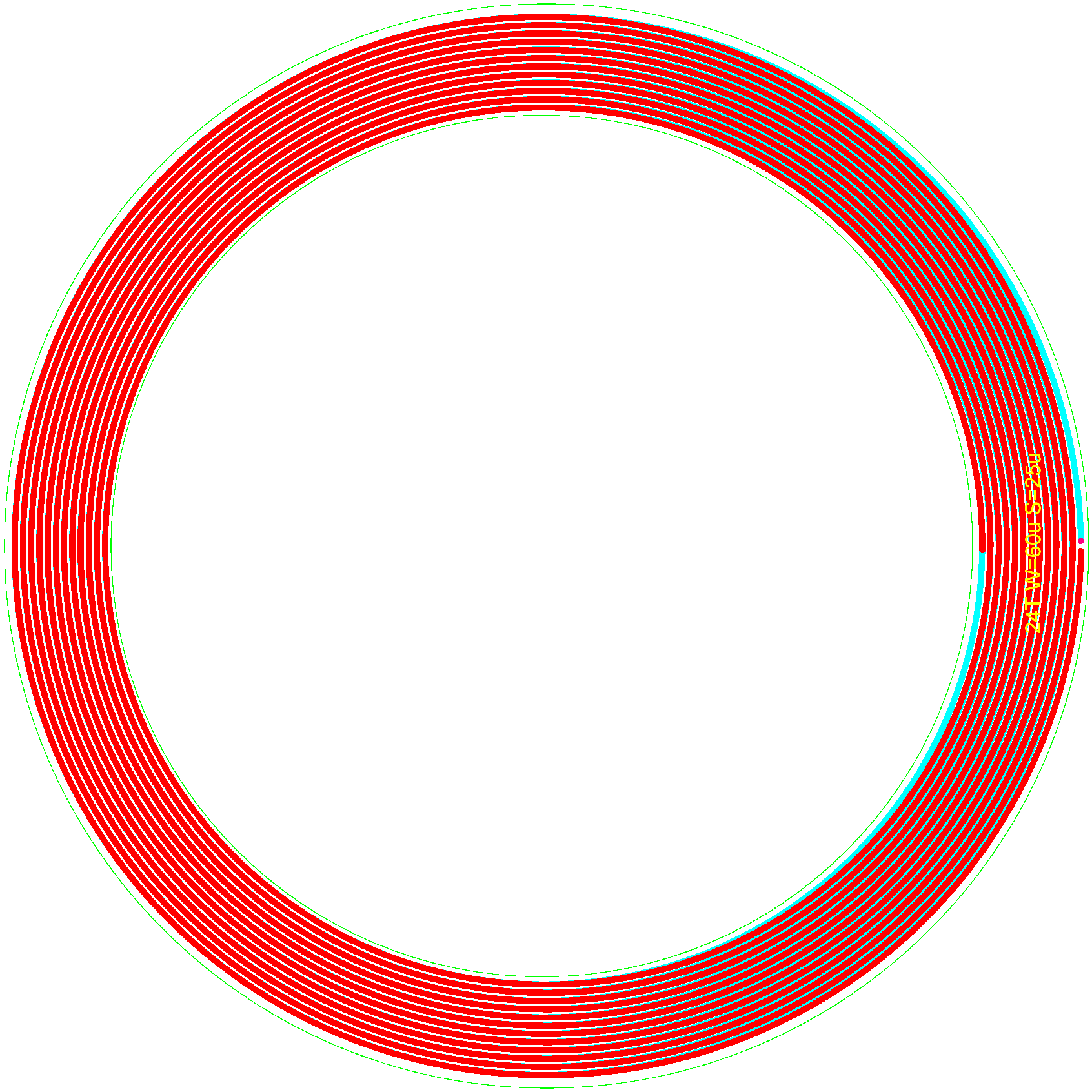

              Here is a double-sided spiral I did in Easy-PC between code compiles:
              It has 60 mil traces with 25 mil spacing, N=24, d(nominal) = 10" (25cm). I chose trace width/spacing to keep the overall ring @ 1" wide. With 2 oz copper the trace width is equivalent to ~27 AWG so the "gauge" and spacing are almost the same as the OP's specs. It would be interesting to compare results.
              PCBWay quotes $209 (plus shipping) for 10 boards, so right now it's a little pricey to find out. It's something I've been wanting to play with for some work projects so I may do it anyway. Obviously you don't want to waste all that middle real estate so maybe make it a set of progressively smaller coils.

                Thanks for the graphic, $209 is a bit prohibitive, if you decide to go ahead to help defray your cost I would be interested in one board thanks.

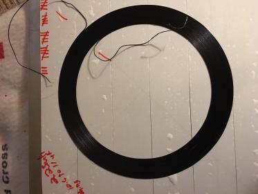

                  I have considered twisting 2 or 3 strands together but this teflon wire is not cheap and I don’t think I would have enough wire to do it. I made a couple of bundle coils with this teflon wire a couple years ago but my MD crapped out before I had the chance to try them out and kinda got out of the MD’s for a while. I have recently found a surf PI kit in my junk collection and I am just finishing putting it together. I took the teflon wire out of one of the bundle coils I made and was wanting to use either a flat spiral or a basket coil out of it to use on the surf. The problem is in order to make it I would most likely make in a Permanent state and wouldn’t be able to reuse the wire again kind of a do or die thing. That’s why I was looking for other opinions and I thank you all for them. I’m going to make the flat spiral trying to decide on spacing or not between the wires. I will just make it and see what happens.
                    Rob, you're looking at about 3.7 ohms for the coil resistance. A tad high but not worth doubling or tripling the wire. If the TX is 100us you'll go from (ideally) 2.1A to 2.9A by tripling the wire; the benefit diminishes as the TX gets shorter. Also, additional gap between the wire probably won't buy you noticeable speed, but probably will noticeably reduce TX efficiency.
                      I ran out of wire on this one length of wire that I had, I have more so I am going to try and splice on some. I am at 28 turns and according to the coil calculator I used I needed 29. At 28 turns I am at 225 uH and about 10.8 uF and 3.3 ohms. Any guesses how many more turns I need to get to around 350 uH? I included a picture if it worked.
                        I have noticed from using this wire in the past that the inductance runs lower than what the coil calculator come up with.
                          I think that once I get enough turns on here to get the inductance up where it needs to be that the resistance will be to high to be any good. What would be the perfect inductance for a Surf PI? And what would be the highest the resistance can be before it’s useless?
                          I think it needs to be done with a bigger gauge wire to lower the resistance. 28 gauge is just to small. And the teflon coated silver plated wire is to expensive to experiment with. I think I paid somewhere between $25 to $30 for a 100 foot roll of this stuff.
                          Would it be worth the time to make a flat spiral coil out of PVC copper stranded wire of a bigger gauge? I will have to try and compare them together. I’m going to have to make a basket coil jig as well. Back a couple years ago I made a coil from speaker wire for a surf PI and it seem to work great before the surf PI quit on me, not sure why it did if it was the speaker wire coil that caused it or what but just trashed it and gave up MD for a while and didn’t really know what I was doing back then. Now I’m getting back into it and by reading all the post out here I learned a bunch and since got a Oscope. So keep up all the good post and I will keeep learning. Sorry for the long post. Hope you all find a treasure. Thanks all, Rob.
