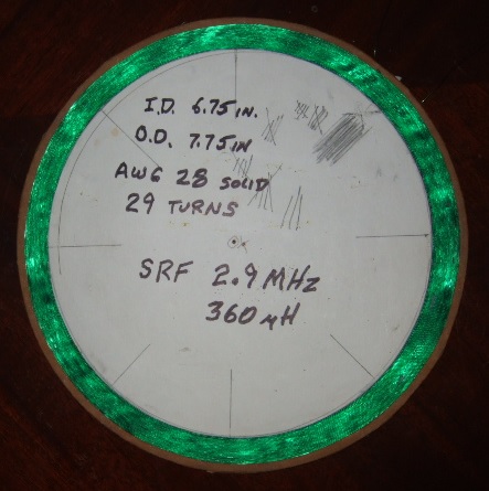

          Made a spiral coil with AWG28 magnet wire to match RobN's coil specs. reply #1 to compare with Teflon coated wire. I'll shield it later.

            For a coil with a 190MM or 7.5 inch inside dia, I've gone with 45.
            • #51
              45 is what I had with the above flat basket coil, 193mm I.D.
              • #52
                Green, what is the resistance on that coil? I don't have 29 wraps on mine yet only 27 or 28 and the inductance is low but my resistance is already up to 3.3 I think it was.
                  I calculate 3.6 ohms but measure 3.8 ohms.
