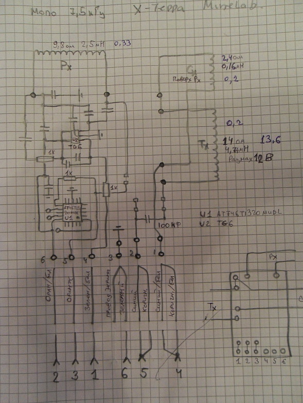

        That looks like an XTerra board, they have a micro embedded. Sov/Excal do not.
        Excal is a simple square-wave drive but with a fundamental of 3kHz, so I would expect the critical thing is to keep the TX coil resistance low. There is no resonance cap for TX, and surely not for RX either. Somewhere there is a schematic for the coil PCB.

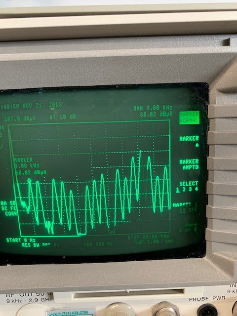

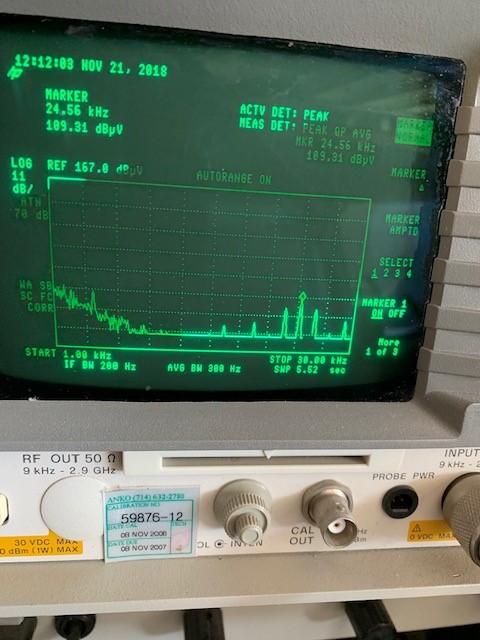

        I put the Excal over a 8" multiturn loop of wire connected to my spectrum analyzer and 3 Khz doesn't show up but 24.56Khz seems a peak. Why doesn't the fundamental show up, I must be doing something wrong?
          Here we go, this shows 3Khz.

              The "3kHz" frequency you're looking for is actually 3.125kHz, 25kHz divide by 8. Spectrum analysers tend to make a mess of the BBS waveform, the 25k stands out because there is 8 continuous cycles of it, then a gap ( for 1 cycle of 3.125k ) then repeat.

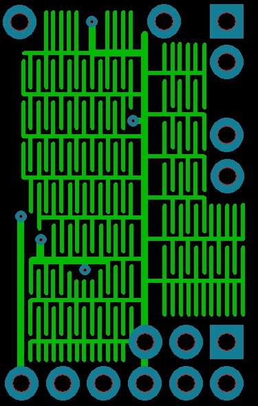

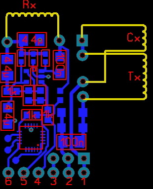

                  a pcb of mars coil. has two frequencies. 2 micros = 2 freq-s.
