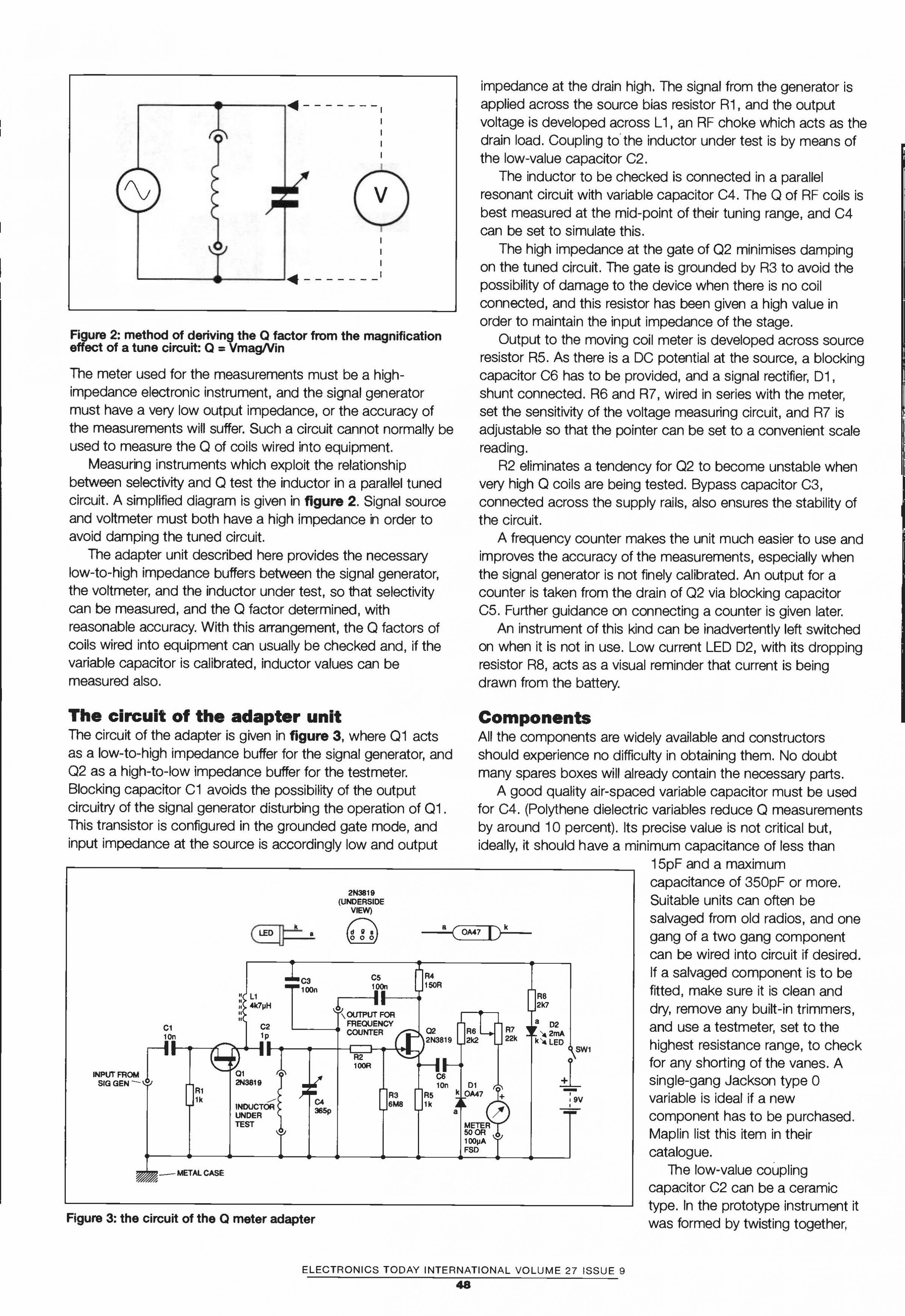

Did I calculate the Self Resonant Freqency of my coil correctly?
    Saw this little project while browsing through old mags.
    I think this circuit can be used for playing around with coils. So to find Q, SRF, inductance, etc.
    Anyways, it looks interesting for the person who likes to experiment with self made coils. And has nostalgia for vintage gear.

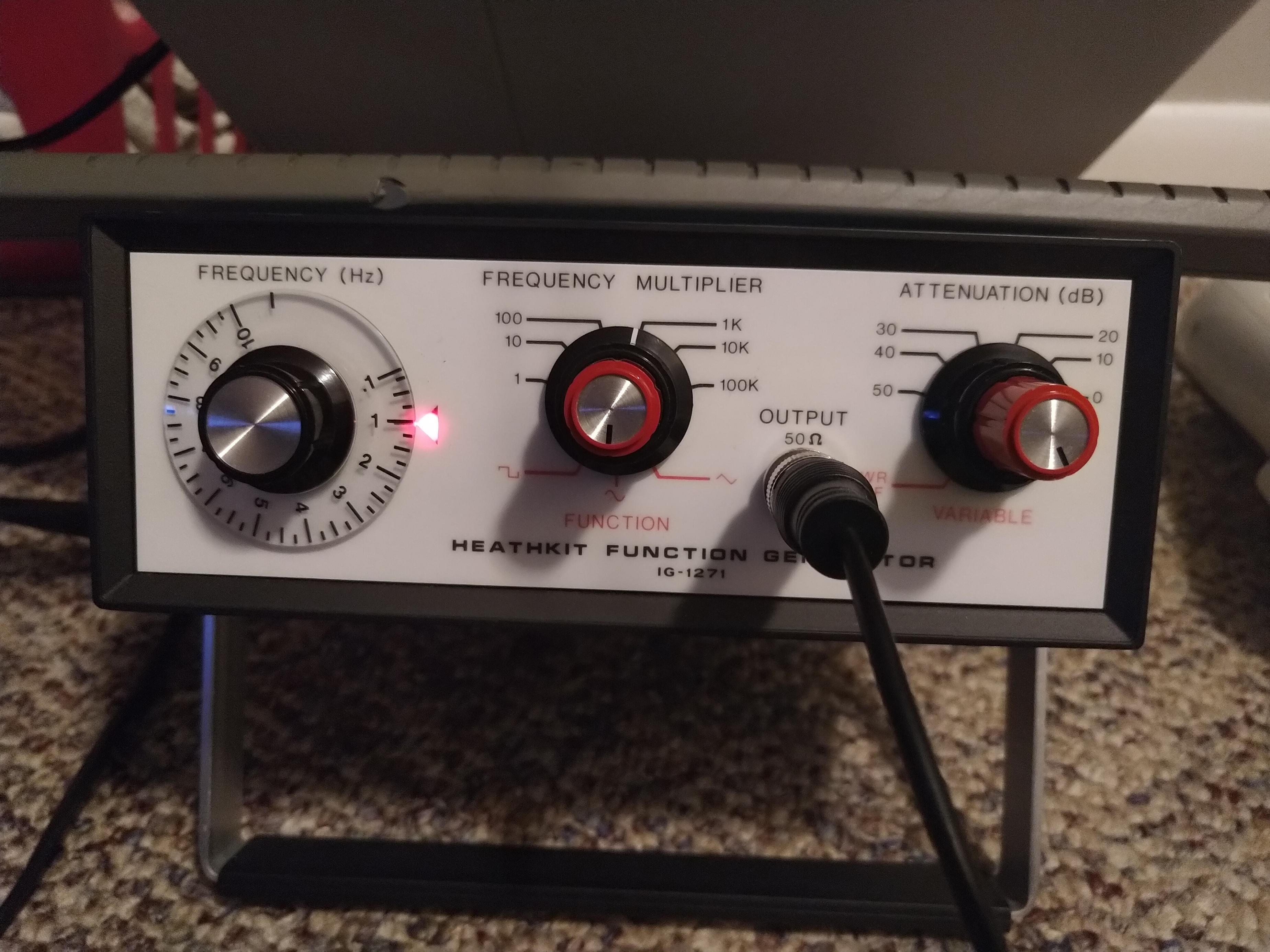

            Hey everyone,
            I tried the diagram that Carl posted and I was having trouble getting the oscope to trigger so I moved on to diagrams that Elliot and kt315 posted.
            For the diagram Elliot posted I don't have 10 meg resistors and I wasn't sure if I could use a different resistor type then whats in that diagram.
            I did have everything that kt315 posted so I setup everything according to that diagram and I was able to get that setup properly.

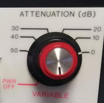

            BUT, on my function generator I have an "Attenuation (dB)" dial and I'm not sure what I should set that at to get the proper measurement. I attached a picture of the dial.
            Does anyone know what I should set the Attenuation to?

              interesting. but dB is just relative scale, kinda 'in times more-less'. can you give voltage value P-P on output in position 0?

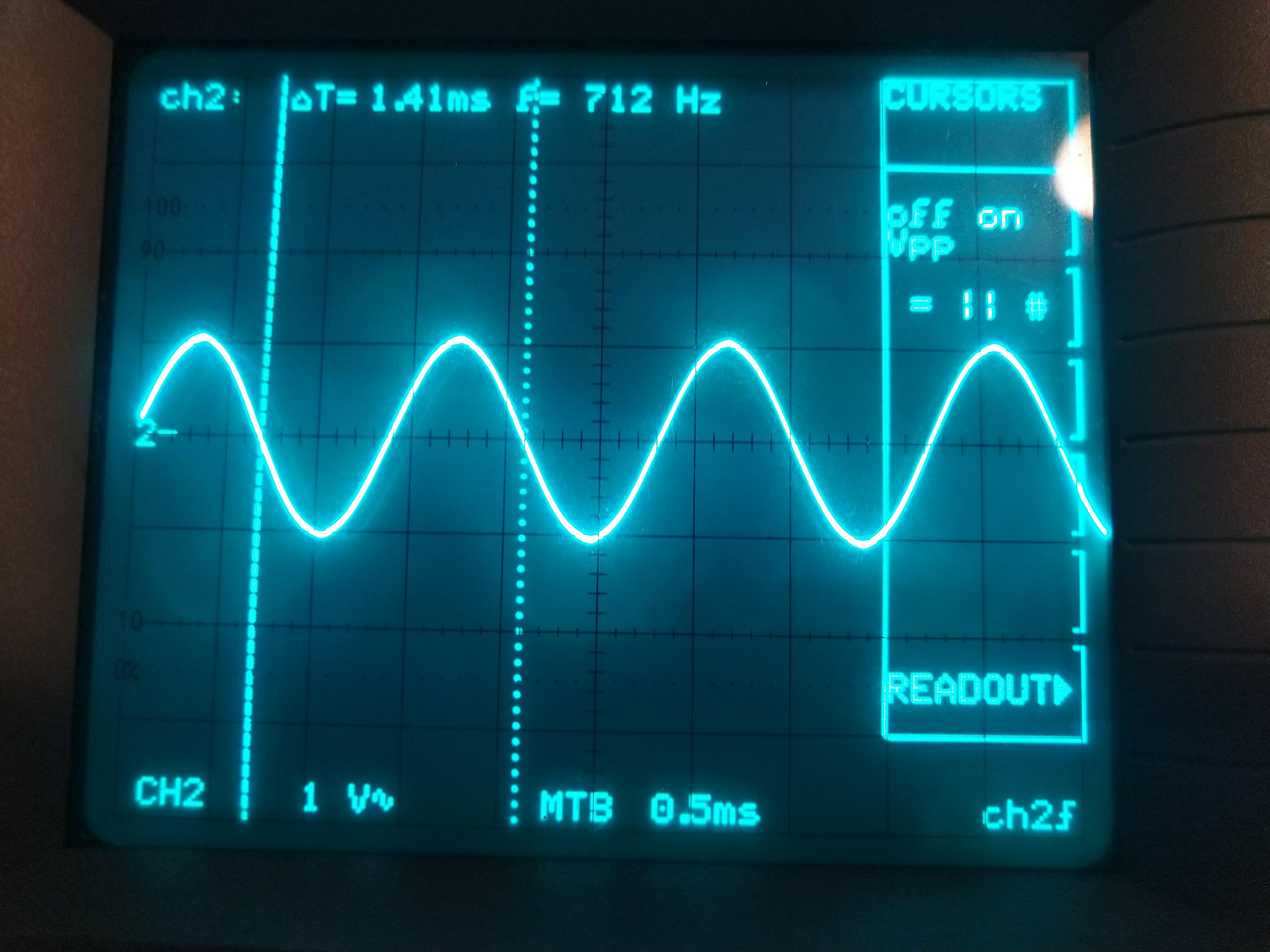

                  Kt315, I'm not by my oscope right now but I did take pictures,
                  This is the settings on the function generator I set the freqency to 1kHz and for the Attenuation I set the outer dial to 0 and the inner dial turned all the way to the right: Click image for larger version
                  This was the oscope output from those settings: Click image for larger version
                  When I adjusted the Attenuation the p-p increased fairly quickly, but the max peak of the wave never increased when I continued to adjust the attenuation outer dial. I measured the wave and it came out to 712 Hz which can't be the srf.

                    this table. if you have 2V p-p then 10dB is 2*3.16~ 6V p-p
                    20dB is 2*10= 20V.
