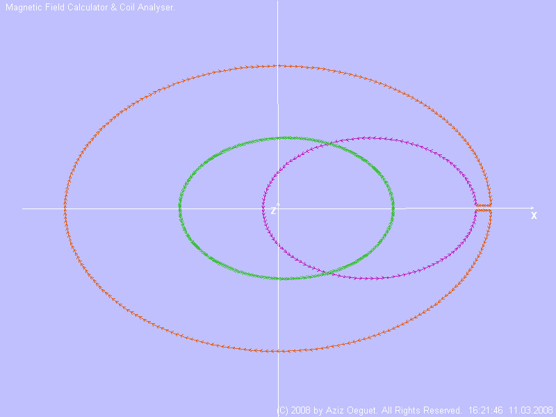

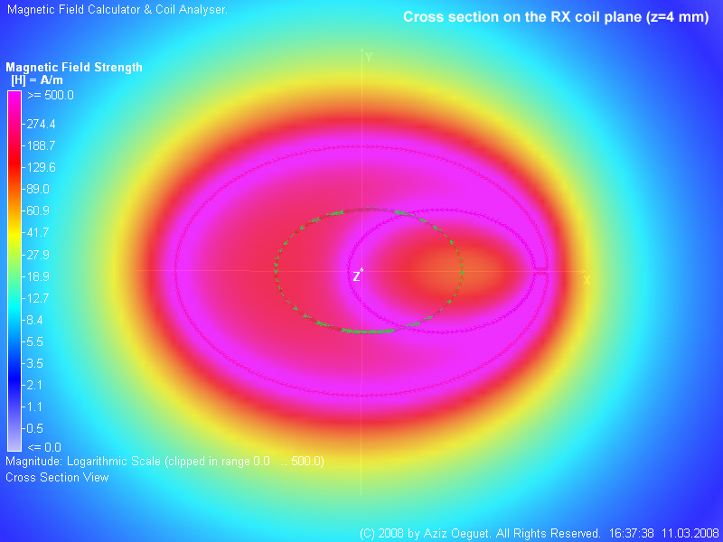

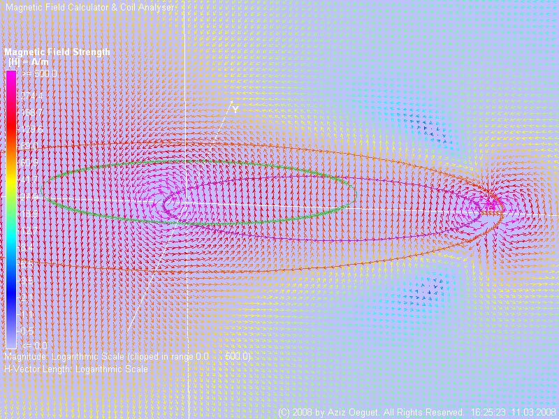

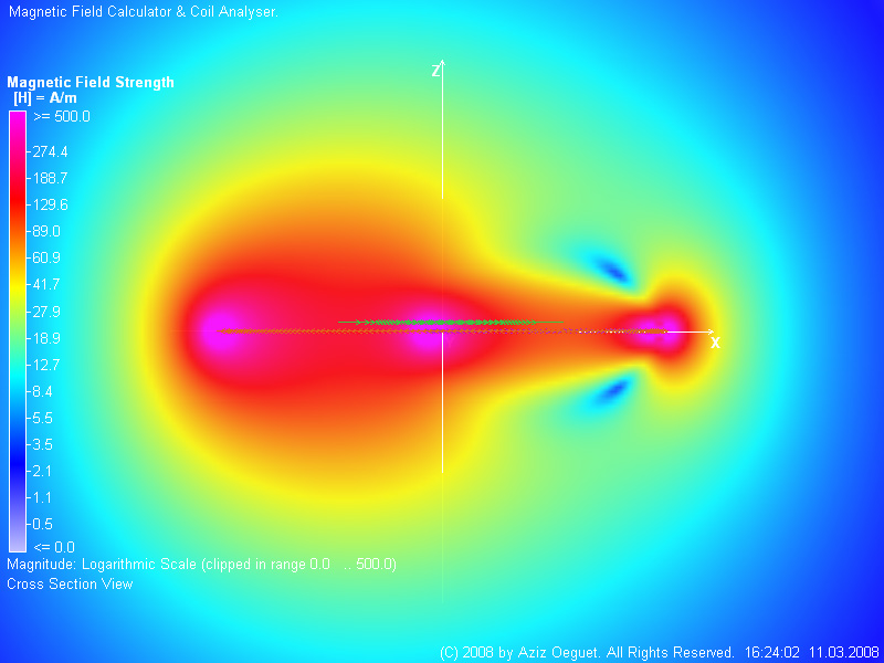

                  I enclose the analysis of the mentioned elliptical omega coil from turkey. The RX coil is set 4 mm above the TX coils (realistic condition). It is almost on the center position (4 mm offset to x-axis) of the coil arrangement (caused from the z-offset). The coil arrangement is "exact" in contrast to other manufacturer.
                  See the pictures below:
                    Probably they don't perform well in mineralized soil, because compression of the transmit field unbalances the coil. For mineralization, the best coil to have is one that is purely symmetrical... concentric is good, DD is better, OO is even better.
                    I was thinking that it was neglected because of difficulties in serial factory manufacturing. I find your opinion, Carl, about symmetrical vs unsymmetrical in mineralized soil very interesting. I form a picture about this, that coils which are easy (or not so delicate) tunable, are more stable in all sorts of soils and opposite no matter of shape. Relation between coil symmetry and kind of soil regarding coil stability are something new to me and i will perform some test in such way in future. Thanks for your statement.
                      Top view to the coils (z=4 mm, on the RX coil plane):
                          I imagine myself, that primary goal by Omega coil is to reach as small as possible inductive influence between TX and RX coil. To reach this we can manipulate with geometry (position and dimension) of TX inner loop and RX coil. I tested this with 4 variable parameters: TX-out diameter, TX-inn diameter, TX-inn position and RX position (fixed RX diameter). It is easy to build such variable testing Omega coil and play with. RX was made first on given L , shielded and tape isolated , then we coil up TX follow specific L at appr. diameter 4 x RX. After shielding and isolating, only TX coil are shaped in desired form of Omega and RX only different positioned. I shaped similar with Turkish coil too, but reach best results on shape last posted, for small items sensitivity (RX positioned very deep in TX-out coil and from this spot my suggestion.

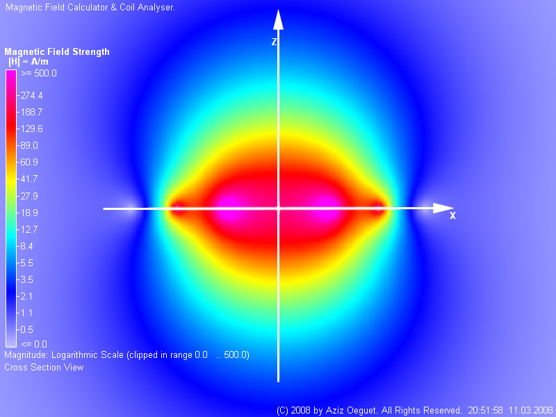

                                Heureka! Now I have found a very well magnetic field profile for a difficult to build (tune/balance) coil system. This could be a reasonable coil for pin-pointing. Its maximum is on center.
