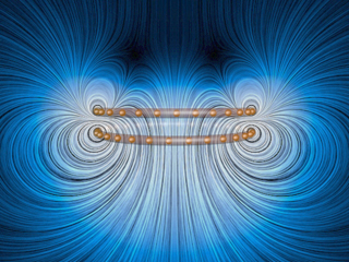

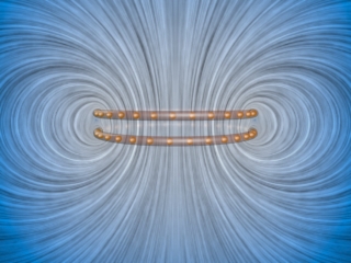

        Magnetic forces repelling
        The two pictures attached show two coils with the current running in the same direction, that is the magnetic forces aiding, and with the current running in opposite direction, that is, magnetic forces repelling.
        It is also possible to repel the magnetic forces with a Graphite disk, it needs to be seen how fast the eddy currents decay in the graphite disk.

        • #94
          Thanks for those infos.
          Tinkerer´s views ar more like what i imagined,and it is nice to see there are more than one solutions.

          • #95
            Tinkerer
            Hi Tinkerer, nice visualization. I can see deformation of field on your presentation of field distribution to one direction, but can not see any magnification in opposite direction, rather contrary. Decaying of eddy currents in graphite disk do not mean that graphite disk repel magnetic forces, this two statement are contradictory. Only opposite magnetic forces (in polarity and direction) can repel magnetic forces. According this only magnetic disk, can repel magnetic forces of one TX coil (better to say condense magnetic forces in same direction) . But repel not need to be a sign of magnification of magnetic field in opposite direction. Nevertheless, nice picture, thank you.

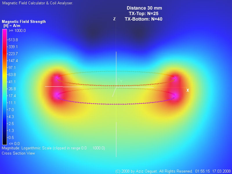

              It depends on the configuration: I got same results, if taken described configuration below. My respresentation is correct!
              • #97
                Magnetic fields repel
                AZIZ,
                your representation is indeed correct. In the visualization that I presented above, (It was produced by my friends at MIT), the top coil has one third of the current of the bottom coil.
                In your visualization you have reduced the amount of turns of wire, but maintained equal current.
                Since the field strength is Amps X Turns, the result is the same.
                Congratulations to your software.
                  Congratulation! Sure, it is correct, but don't forget to ask what benefit of this configuration? Where is magnification in comparison to configuration of two coils with current flow in same direction? As I understood primary goal was to reach some directed magnification of M. field by reflective element. So reflection (better to say condensing) work, but where is magnification in opposite direction in comparison to same construction with same both currents but in same direction?
                  • #99
                    One interesting thing we can see on those pictures is that Aziz´s coil lobes are directed inwards and Tinkerer´s are outwards.
                    The first one is probably better, but this is surely easy to correct by varying the upper coil diameter.
                    For practical contruction the graphite disk coil must be simpler to build , as long as the disk remains thin and lightweight.
                    Fred.

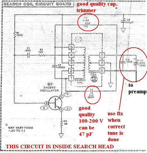

                              Hi Esteban
                              Are they suggested which turn of RX coil we have to left free (first, last, twentieth ....?)
                              Thank you.
                              One of the extreme wires of receiver coil. Maybe this kind of adjustment (with a portion of free wire as a nulling coil) can be possible because transmitter has contact with receiver via 2 capacitors, one fix and other variable. This detector is type "audio up", this is, you note the target because audio level increases in hearphone or speaker. The characteristic of this omega coil (TX) and round receiver is this: you adjust the receiver coil for to leave out nails and wire of fences, for example, helping with variable trimmer and position of receiver coil only in one of the both zero adjustment. This both zero are very near. But you note nails and iron wire in this way: put a little audio with sensibility potentiometer (here is very most sensitive, because audio level is more clear). When you detect nails or iron wire, the small audio you hear in hearphones vanishes. This occurs also in mineralized soils with iron minerals. This leave out nails and iron wire, but not relic iron. This is great oscillator and receiver circuits. Is some difficult to adjust, but if you use good components (important capacitors), the oscillator stay quiet. The only problem can be the cold weather. Also emitter resistor is very important, better 1%, between 56 to 68 ohms. Transistor also is important here, gain 200-250, type BC547 A.
                              This is automodulated circuit. You can change audio tone if you replace the base capacitor.
                              Esteban

                                Thank you Esteban
                                Very informative.
                                Seems as one of multi-frequency stuff?
