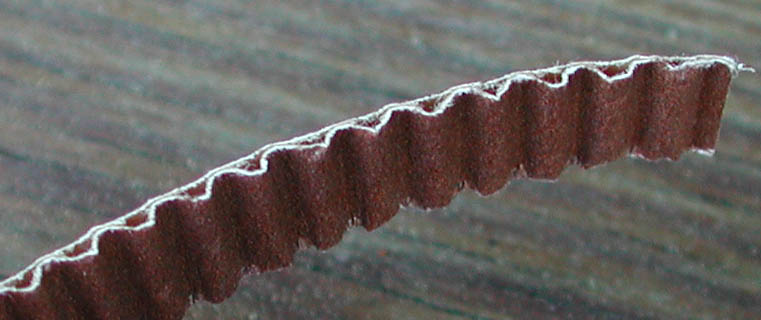

              Does anybody tried the corrugated board? Cut in thin stripes, this can be wound to the coil bunch as a spacer. As the (dry) paper has a dielectric constant of 3.5 and there is a lot of air, so this value can be decreased at least to the half or more.
              Teflon has 2.1.
              See dielectric constants:
              http://en.wikipedia.org/wiki/Dielectric_constant
              Aziz
              I have tried cardboard and it works OK when it is very dry.However, cardboard being essentially hygroscopic, it absorbs humidity from the air and then changes its characteristics.
              I found the material of picture below, that is made of Polypropylene basically a spacer that is mostly air. It is fairly rigid but easy to cut. I apply a coating of 30 microns of graphite composition with an embedded drain wire. Got good results.

                Tinkerer is that the sign material that all the politico signs are using on the side of the roads? Hard to tell if it is that or a larger dia. material Do you use a heat gun to make it more plyable? I was thinking if that is the political sign stuff, there's going to be a lot available soon
                Wyndham
                  PP spacer
                  Wyndham
                  The stuff I get is from old packing boxes. It has the same purpose as cardboard, but it is waterproof. It comes in different thickness and colors.
                  I cant remember its name, but somewhere within my 10 GB of metaldetector info on the computer I have a manufacturer of it, just need to find it, if only I could remember what it is being called.
                  I know it works just fine as a spacer and base for the shielding. Proof is, I just run a PI to sample at 3.5us delay, very sensitive. (low power)
