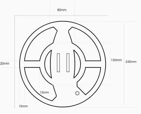

    It is always hard to find good coil enclosures, for us diy'ers. After many years of making various coils i find out what is most suited for most of my needs. Best compromise between size, shape and functionallity would be coil with sizes between 20 and 24cm. Turned to be most effective in 90% of cases. Another good thing would be possibillity to use same enclosure for both; DD and coplanar coil. Why making many simillar models, why not use one universal enclosure and cover most of coil types?
    So here it is, my proposal.
    Dimensions in this case would be 24cm for outer circle and 13cm for inner circle. All other dimensions must be adapted to those.
    And here are main dimensions...

          Yes i inderstand you. But this shape is rather complex to make it that way. This is prepared for vacum extruding plastic machine to make huge serie of enclosures. Hopefully it will be ok. When finished i will know.

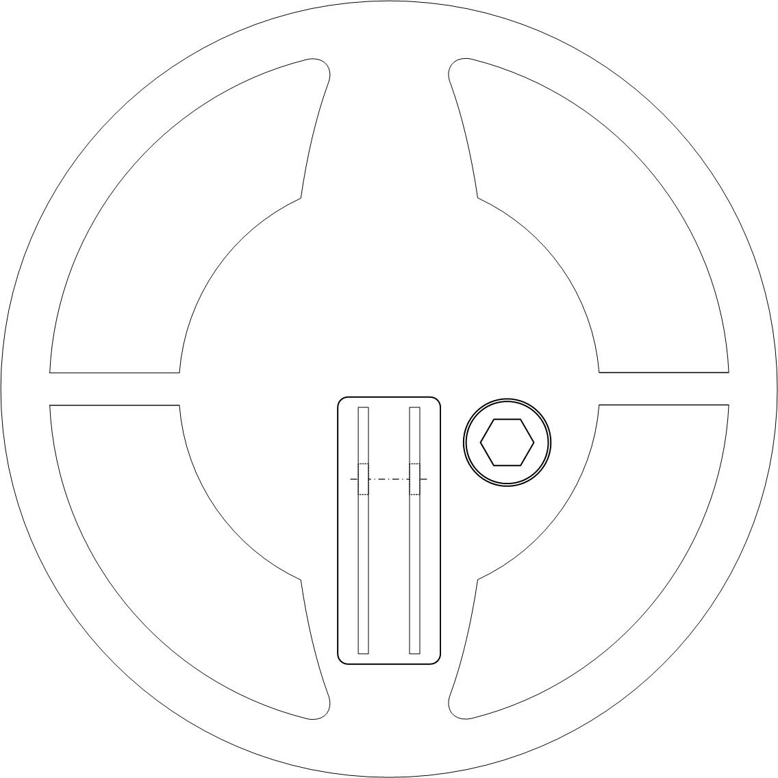

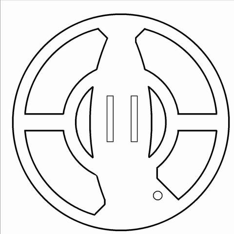

                        Here is a variation of your shell... I got rid of the two crescent holes. To keep it lightweight you don't want to fill the whole thing up with epoxy so use foam block fillers where you can.
                          Filler for coil enclosure
                          Mixing a low viscosity epoxy resin with glass micro balloons, makes a very solid, but very light filler to cast into the coil enclosure.
                            Yes, that looks better! I like it! Simplier with less elements to worry about, but even better and more nice than my proposal! I will adopt this one instead previous, thanks much!
                              Oh yes, epoxy is hevy weight! Good only to apply on critical spots where windings must be tenable with no relative movements. Enough good is to cover whole windings with epoxy layer and later cover with foam, and again thin layer of epoxy on top to isolate it good from outer influences like moisture, stress and direct outdoor temperature changes.
