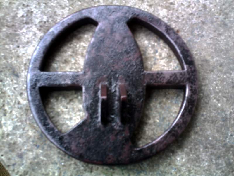

Coil enclosure proposal
    Filler for coil enclosure
    In place of epoxy resin i use polyester filler used for repair the aumobile body :
    polyester
    polyuretane foam
    polyester
    atomobile paint or epoxy film

                    When mixing micro balloons it is important to use a low viscosity resin so that more filler can be added to make the resulting foam like paste still fluid.
                    You can also use Phenolic micro spheres, but there are restrictions for shipping is some regions.

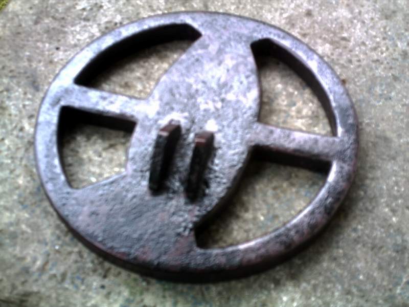

                      Here is first prototype of handmade coil enclosure. I gave Carl's and my draws to one friend and he made something between.
                      It is polyester set (plastic fiber net and poly. resin mixed with hardener).
                      Finally it was painted with several layers of different colors, to look a bit "millitiary"....! That's why those black "reliefs" are visible... Camera is bad, in nature this enclosure looks fantastic!
                      After all - not bad at all!

                          Nice Job. Looks everybit as good as the manufactured pros might make. But I like the color of yours better. Please keep up the good work. You inspire me to dig out my electronics training and see if it still works. A lot of years since I used it.
                            Yes, this was just experiment, to check materials and procedure. Now we can make any other model...
