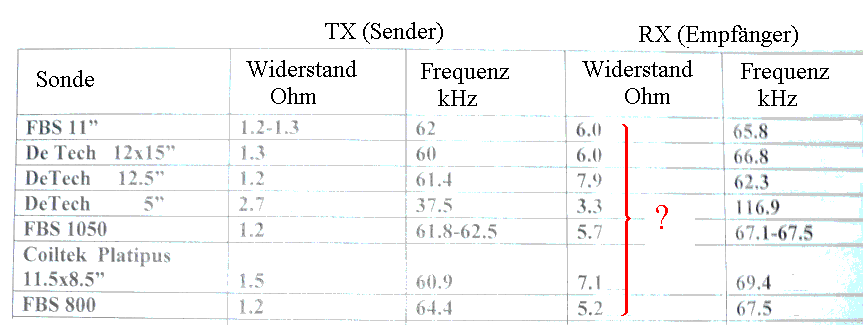

          Generator excites circuit on the frequency of the resonance. The frequency depends on the capacitor 10H and the inductance of the coil. Because the capacity of 10H great, the cable capacitance and the capacity of the windings does not matter. Data can be very accurate. Much more accurate than measuring just inductance.
          So you can do the sensors Tesoro, Fisher and other detectors. Here, for example, data on the sensor old LOBO: RX-51om f=14,65kHz Tx-11,9om f=17,88kHz.

              When You measure the inductance, that every measure will be different. One LC- metr will give one value, another -the other. But with my generator frequency winding will be the same always. There is a cable or no cables- it does not matter.
                FONA, thank you for a very informative and useful contribution.
                  FOMA, your table in post #5 shows very low resistance of RX winding for all coils. That means useless increased weight of metal. Are you sure that the values are correct?
                        I'm sure. I myself did measurement. Coil 5 " has a lot of resistance TX and low resistance RX. This coil emits less than the electromagnetic field, and is intended for very junk sites.
